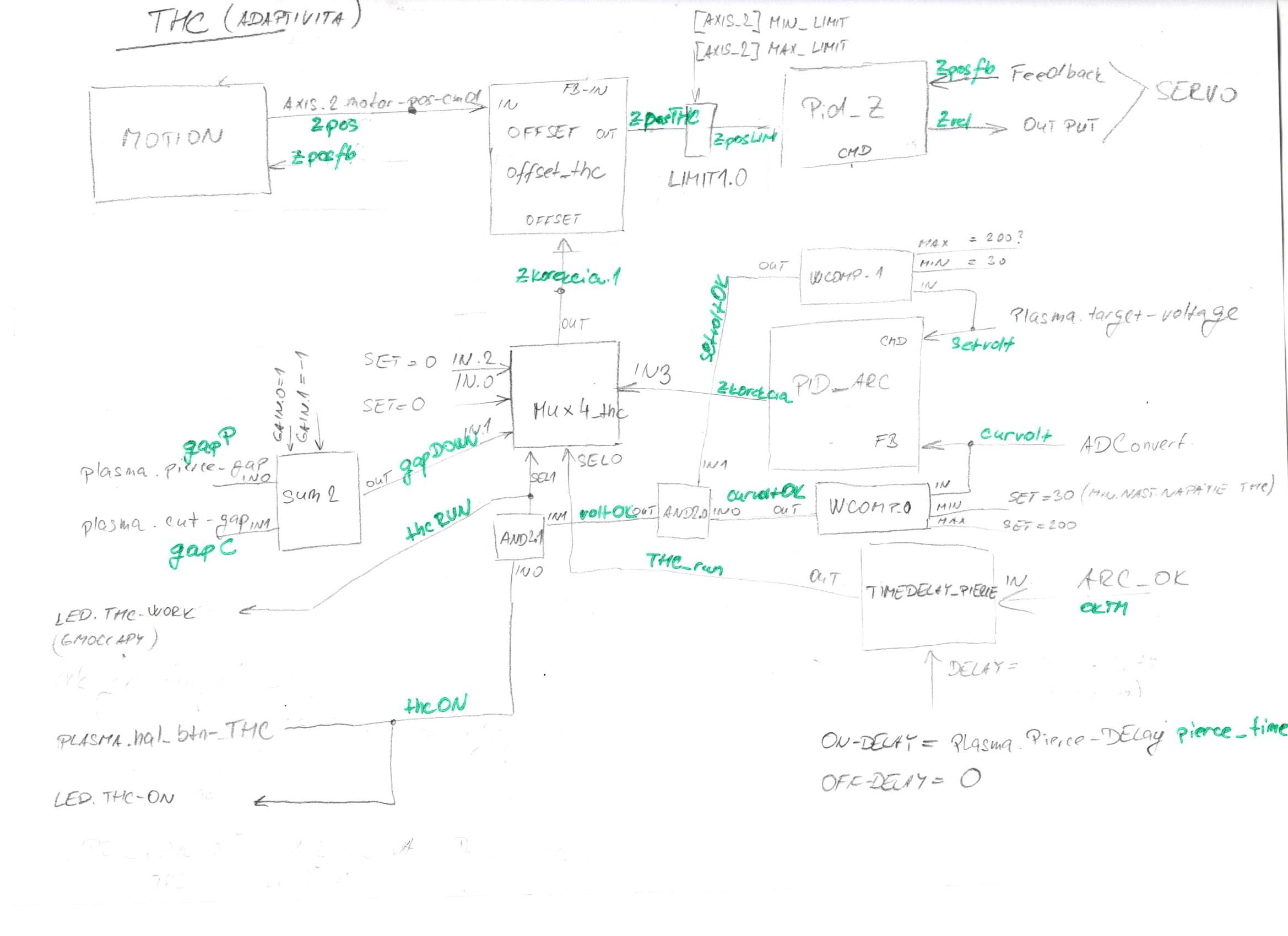

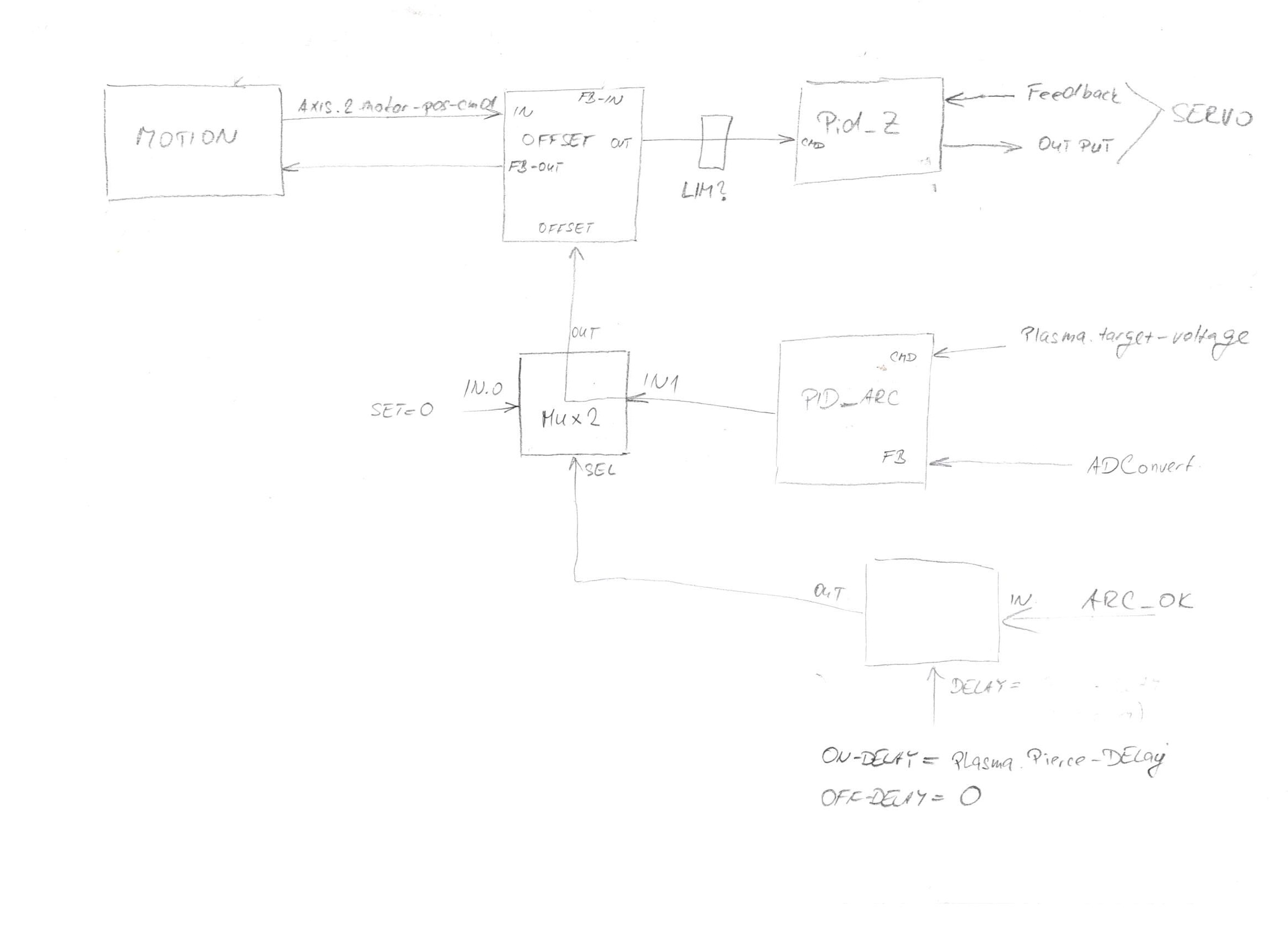

Hi, I would like to share my problems and achievements with the conversion of my plasma.
with plasma cutting I have more than 20 years of experience, I know how it works.
only the iron remains from the original machine, the whole drive and the system will be new.
I have 3 axes with 4 motors. X1 X2 Y Z. I use AC servomotors with resolver, the servodriver emulates the encoder. I use speed control + -10V
the system is pidicnc + servocard + IO card.
The servo card has 4 analogue outputs, 4 encoder inputs and 1 AD converter. this all works well.
I use Gmoccapy1.5.5.4 as a GUI. the movement of the table is set and works well.
now I'm working on THC.
problem can be split up
-connecting the arc source (done)
-plate height measurement - probe (hardware is ready)
-checking the height of the burner during piercing and cutting: HW is ready, HAL file created
I have start with component offset. PID compare plasma.target-voltage and arc.voltage (ADconvert input). PID output moves with Z motor as needed to have the arc of the required voltage. MUX2 is for switch from start height to cutting height.
after few problems:
I've added verification of setvolt and cutvolt signals (e.g. setvolt after start is 0)
I've added ON-OFF switch for THC and led (plasma.thc-led).
I've added led cnotrol of THC run correctly (THC is ON, setvolt and curvolt are OK)
If i switch THC OFF, heigh is not controlled by voltage, but after start drops down to the set height plasma.cut-gap.
with this HAL I have problem with SW limits. I dont now how I can set limits for LIMIT1.0
the real travel of Z-axis is min=-100, max=0
it is possible to make the limit AXIS_Z.MIN_limit + the home sw position?
If I start machine, the position of AXIS.Z.cmd=0. when is homed, AXIS.Z.cmd=e.g.40 (I started from a height of 40 under homeSW)
I need set min limit(-100+e.g.40) and max limit (0+e.g.40)

Issue with limits solved:
pin axis.2.coarse-pos-cmd is positions in G54 when homed
pin axis.2.motor-pos-cmd is system variable count from start point
setp sum2.1.gain0 -1
setp sum2.1.gain1 1
net Z_pos_kor sum2.1.in0 axis.2.coarse-pos-cmd
net Zpos sum2.1.in1 axis.2.motor-pos-cmd
net Z_diff sum2.1.out sum2.2.in0 sum2.3.in0
setp sum2.2.gain0 1
setp sum2.2.gain1 1
setp sum2.2.in1 [AXIS_2]MIN_LIMIT
net min_kor sum2.2.out limit1.0.min
setp sum2.3.gain0 1
setp sum2.3.gain1 1
setp sum2.3.in1 [AXIS_2]MAX_LIMIT
net max_kor sum2.3.out limit1.0.max
setp sum2.1.gain1 1
setp sum2.2.gain0 1
setp sum2.2.gain1 1
setp sum2.3.gain0 1
setp sum2.3.gain1 1

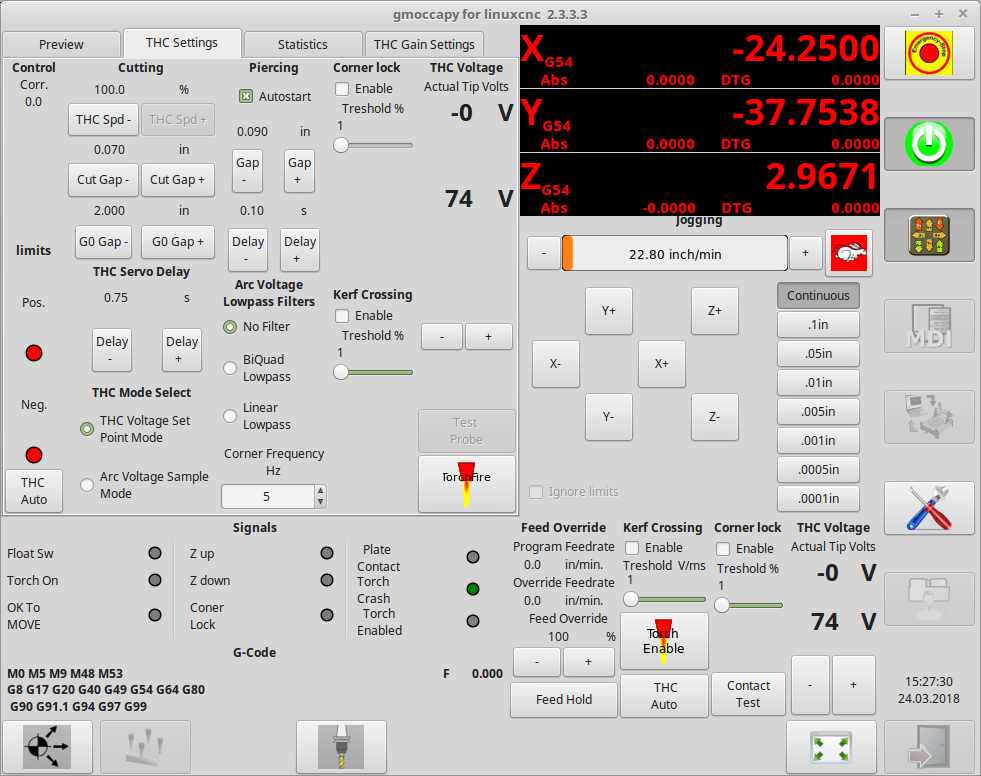

24 Mar 2018 16:58 - 24 Mar 2018 17:08 #107784
by islander261
Replied by islander261 on topic CNC plazma Microstep - retrofit
r4cv
I use Gcode subroutines to probe and start cutting. Please find attached.
John
I can upload archive of all Glade, python and HAL files if you like, they are all works in progress and messy. I set all operational parameters from .ini or the GUI (Gmoccapy). Look for RodW's posts, his code is much cleaner than mine. Still 7i76e based.
John
Last edit: 24 Mar 2018 17:08 by islander261.
- islander261
- Posts: 757
- Thank you received: 216
24 Mar 2018 17:31 #107786
by islander261
r4cv
Please find attached a screen shot of my main GUI screen.
John
John
