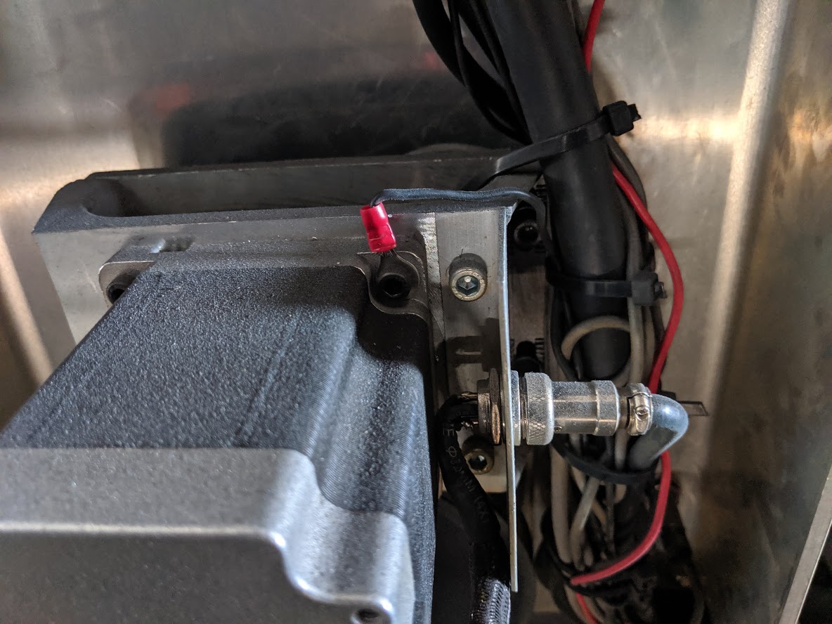

Well if its to be a sticky, here are some pics.

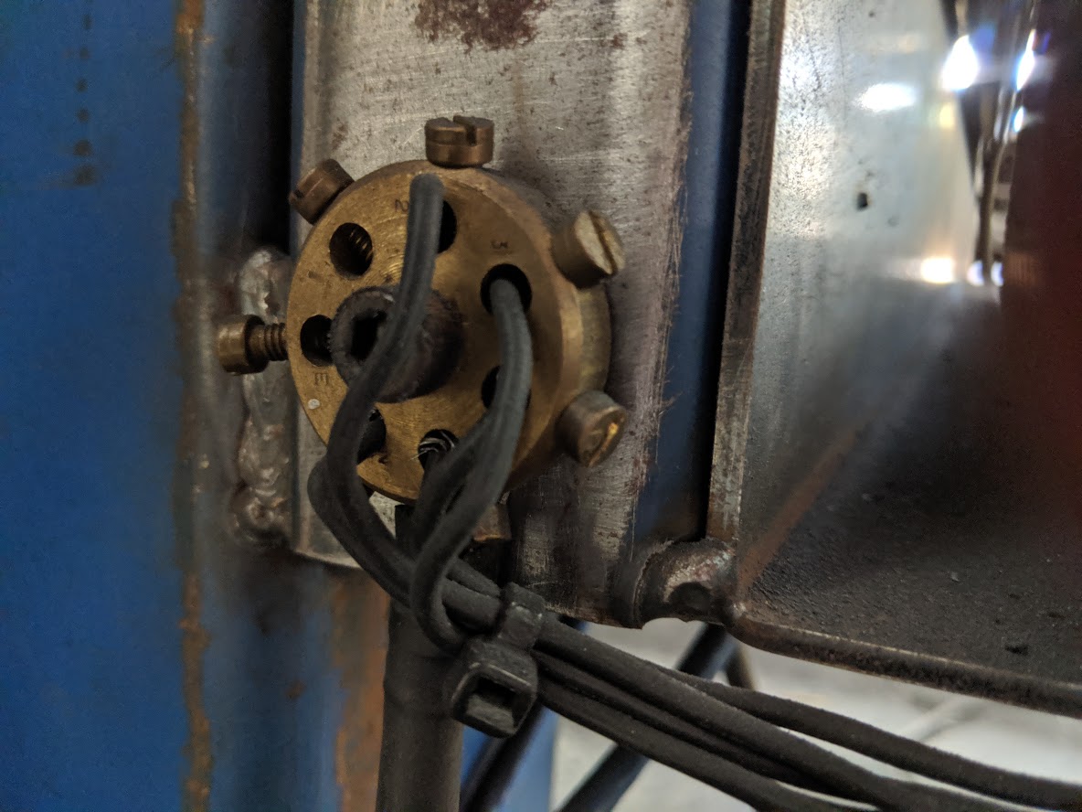

My star ground is a donated brass relic. I think I'd modify a brass buss bar if I was not donated this. Make sure its ground back for good electrical connection to the table.

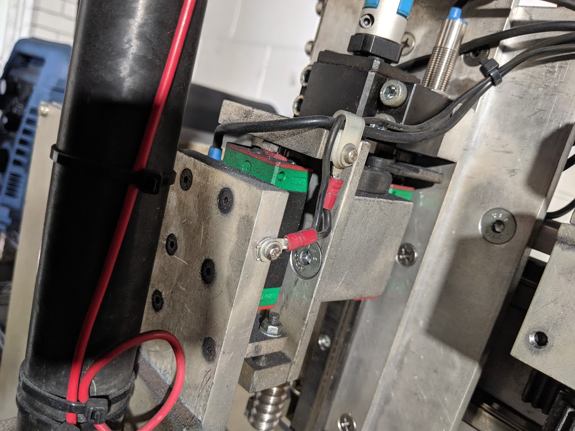

This shows ground wires to Z axis stage and floating mount. This is the only place I shared a ground wire as I figured for 50mm, it would be fine and made for a neater install. You can see there is a thick cable bolted between the brass and the table hanging down. This would be your cable to the earth stake if you need it.

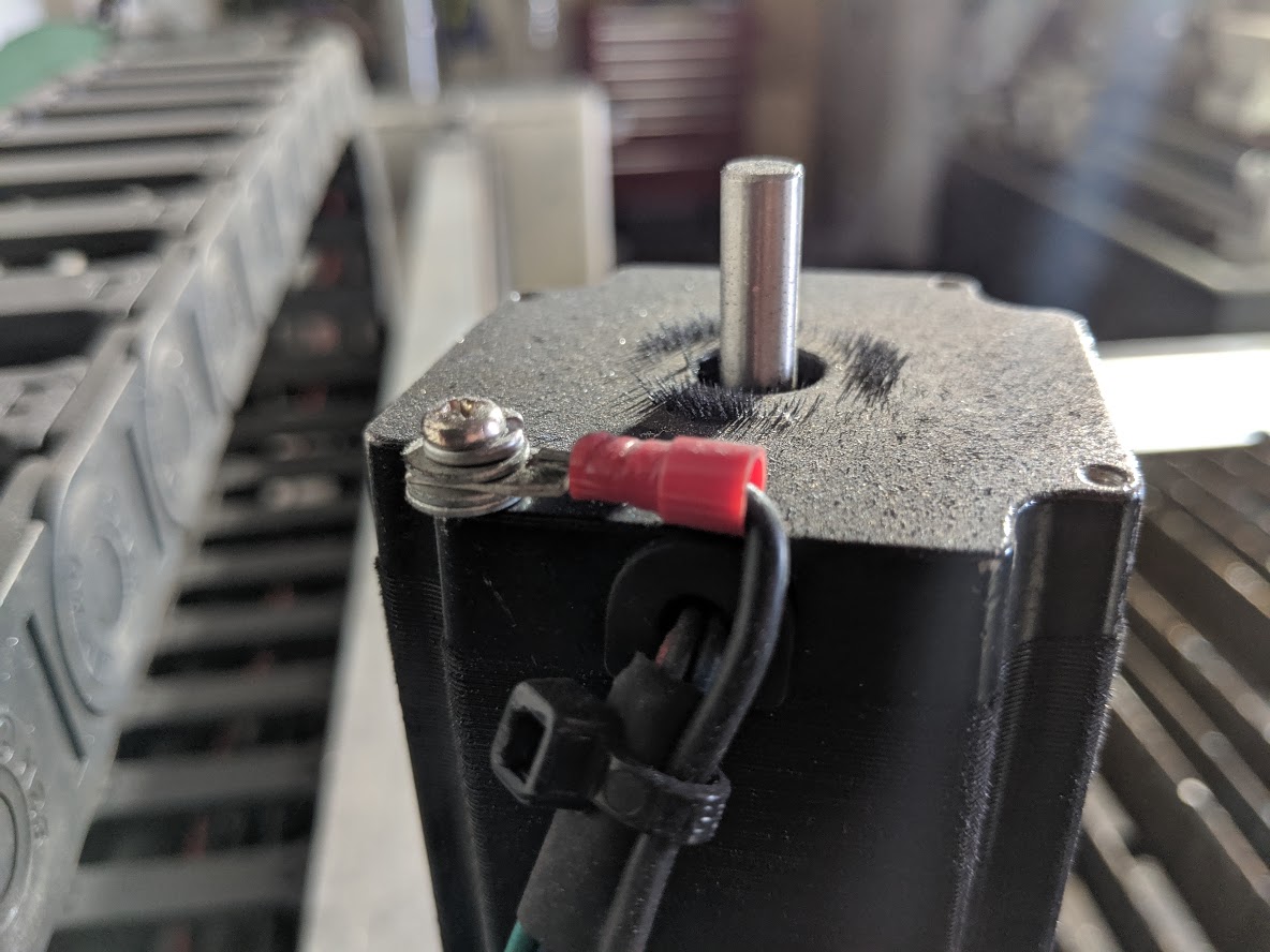

In the following photos ground wires are black with a red crimped on lug.
I have not run an earth wire from this to the control box as its secured to the table via several bolts and is there adequately earthed already.
Y axis ground wire one on each motor (yeh, I know Nema 34 is too big Tommy but I upgraded because I found a cool prebuilt 5:1 reduction pinion drive)
Z axis motor ground
So you can see this is not very hard to do.

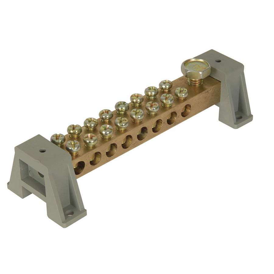

I thought something like this might make a good starground point. Throw the ends away and drill out the bolt hole and bolt it to the table via that hole
Cheap as chips
www.jaycar.com.au/16-way-100a-brass-distribution-bar/p/SZ2004
