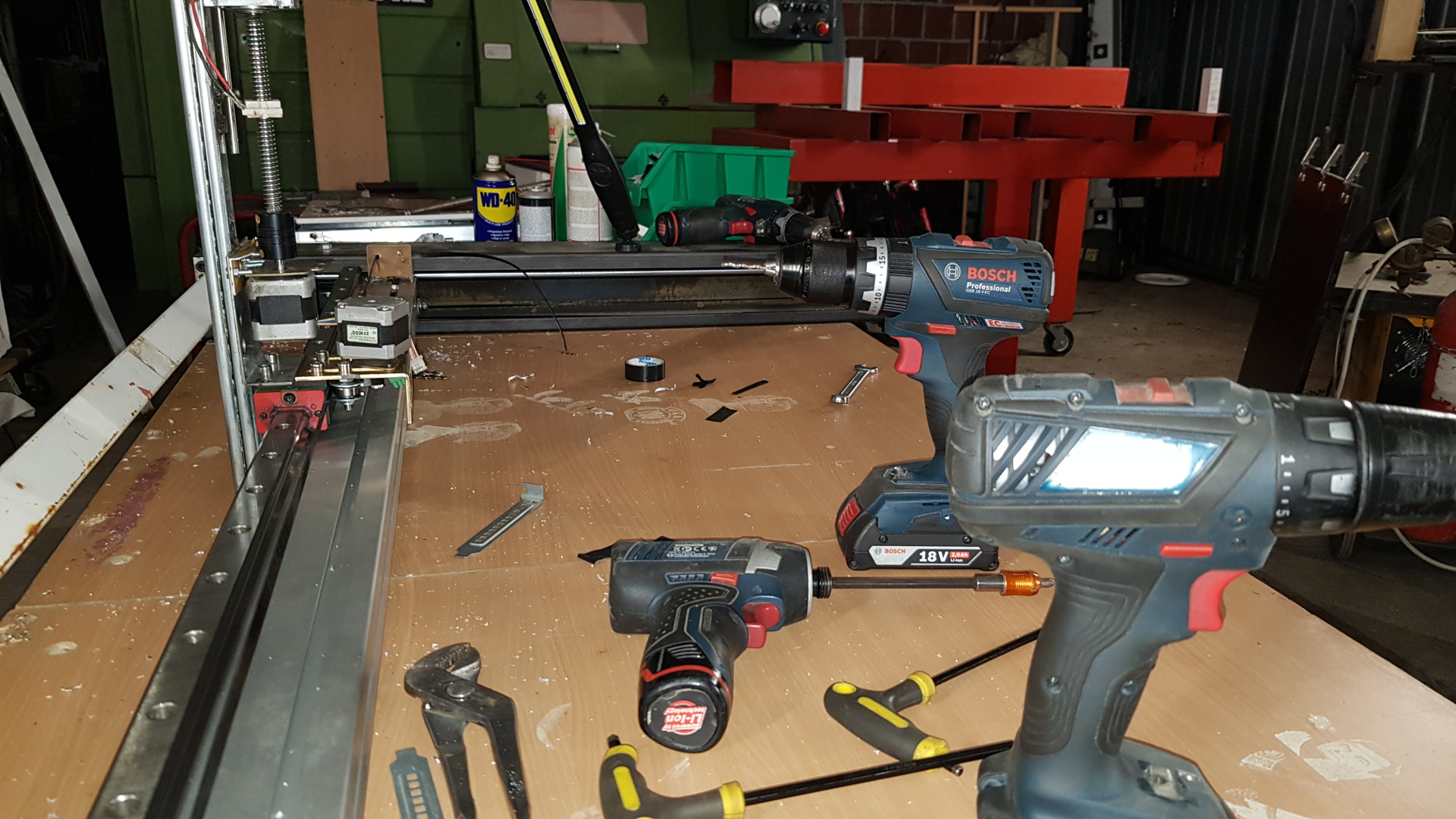

Well, it started as a small plasma for the sake of this thread:
forum.linuxcnc.org/plasma-laser/35349-cn...building-them#118668
That was renamed, was open source something or another.
This time i was thinking more of how it will look, not just making it functional and that led to some design ideas that proved quite terrible and time consuming. It should look much better, for sure, but any servicing of dismantling is a pain in the a$$, and it has to be disassembled to be painted, so OH JOY !
Will take some pictures tomorrow and post them here, not finished yet, but all the motors are in place, belts also, floating head is nearly finished, the wiring needs to be done, electronics are done, etc.
Will be also posting this to the above thread at the beginning where the small machine is discussed.
Regards,
Tom.
Here are some pictures:
Machine from one side, floating head with X and Z axis motors mounted.

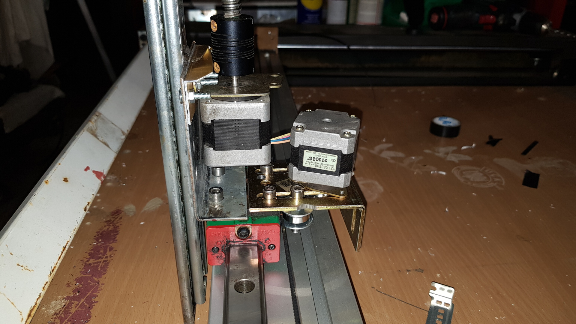

A close up of motors

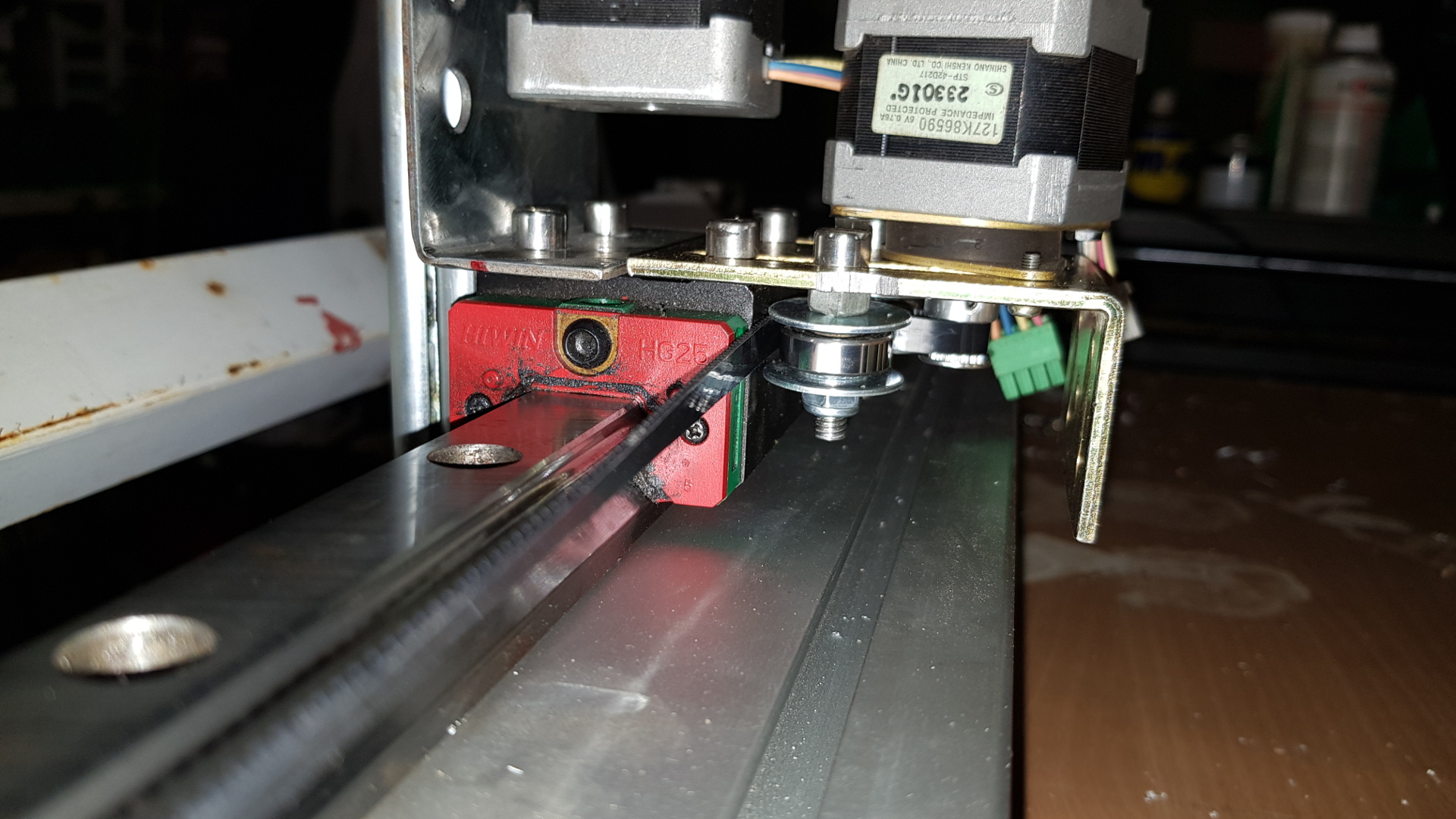

A close up of the X axis motor, bearings, GT2 16teeth pulley and belt

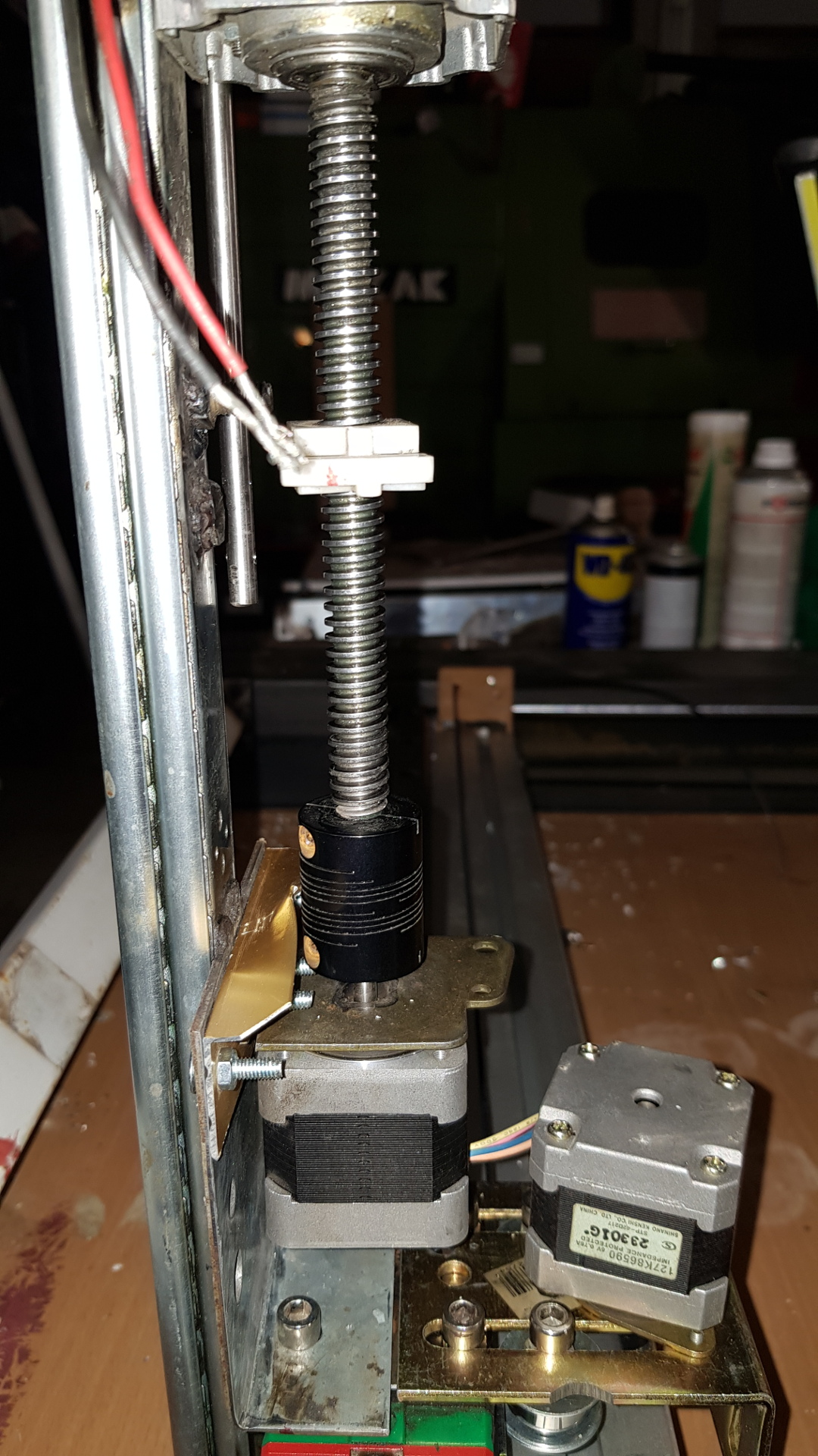

Z axis motor and screw, notice the nut is not attached yet, was attached last night but was flexing to much so a new mount is in order.

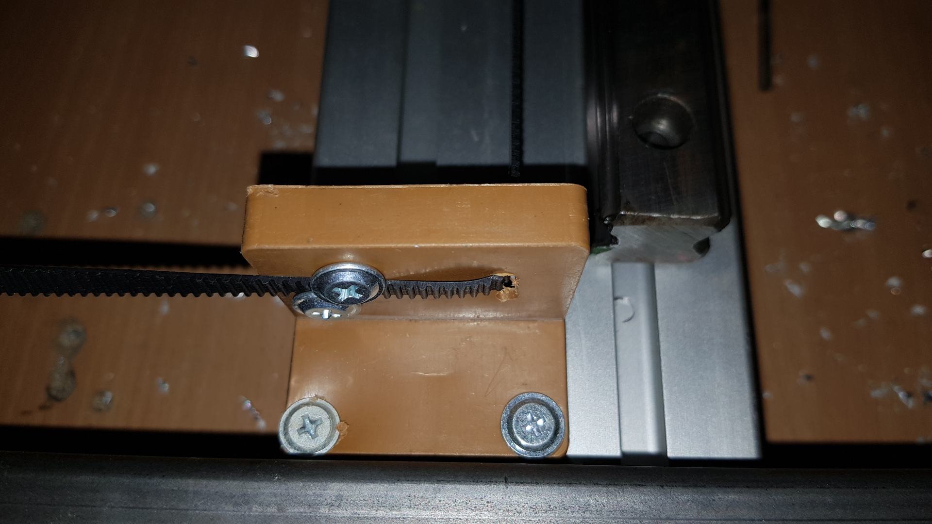

X axis belt mount and hard stop since this will have no limit switches.

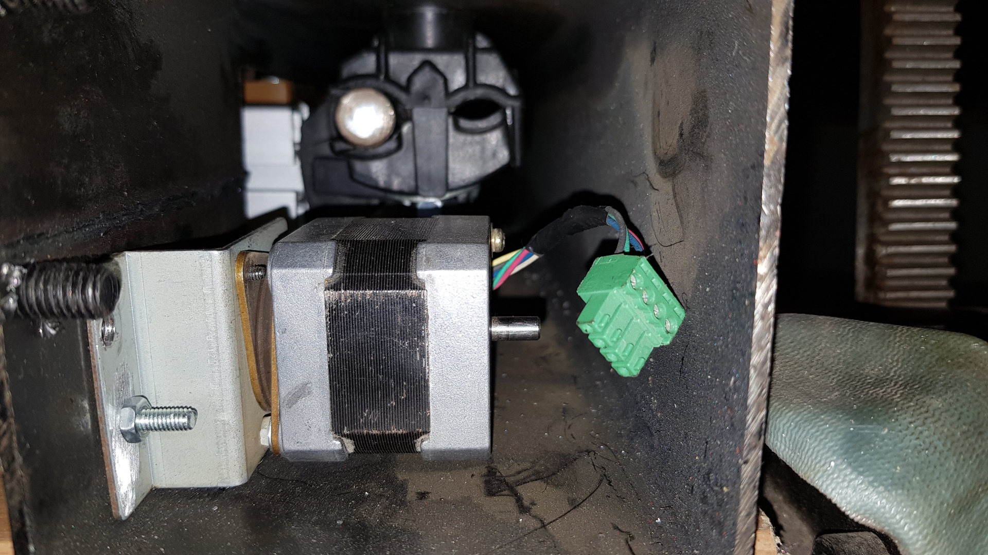

One of the Y axis motors and mount, also round rail mount can be seen, same on both sides of the Y axis. The opposite side of that tube has a bearing mounted for the belt, belt is spring loaded on both sides.

Tom,
Are those rails 35's? Do you think you could of gotten away with 25's?
