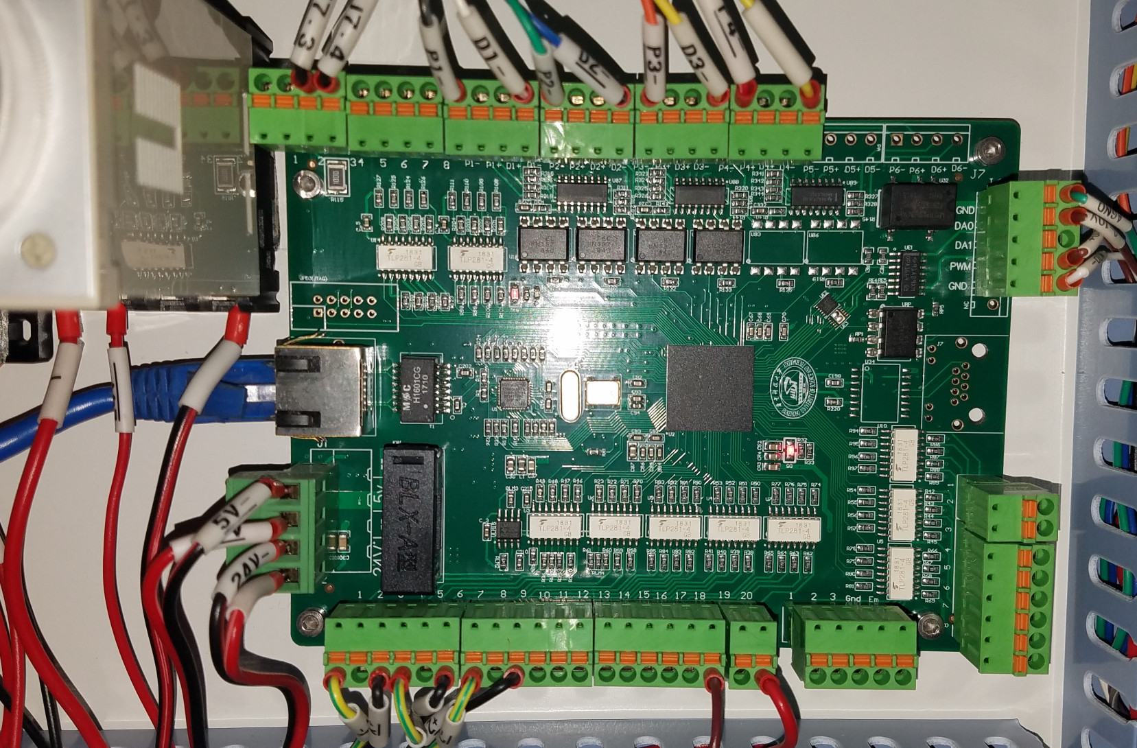

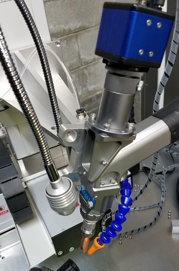

29 Jan 2020 00:59 #156058 by rdrr
Just posting the break out board for motion control, and laser head.
Laser is fiber, camera on top of the head for positioning when using CNC.
Something I've found, is I have no idea how to stop melting the laser protection glass, under the blue cover towards the bottom of the laser head photo. It keeps the laser from blasting itself with back-radiation. We managed to get more than halfway through the first one before realizing that we were pointing directly into a corner, which is not good.

Anyway, the BoB communicates to the computer using Ethernet. I still don't quite understand how to get linuxcnc to talk to it (or a Mesa board) over Ethernet, I think the "DRIVER = hm2_eth" line in the config file is part of it, but there are a lot of technical parameters and I don't want to damage stuff.
Also, how-ever-to output to RS-232 is still a mystery! Doesn't seem like there's any support for that in linuxcnc. I followed the other input 'tentacles' out and they seem to just go to the laser head - so probably some sensors in there in addition to the trigger button.
Thanks for the pictures, If you would take one showing the whole gantry arm that would be very helpful.
You machine sure does look nice and expensive compared to my filthy plasma machine.
I am still testing out Phill's modifications to PlasmaC that allows communication with my plasma unit via RS485. Maybe ask Phill about it with some specific details you want to know and he might be able to help you out. I know RS232 is not RS485 but they way it works should be similar.
Also you might get more help if you post in the Driver Boards section of the forum the specific details about getting the ethernet communication working with LinuxCNC.
