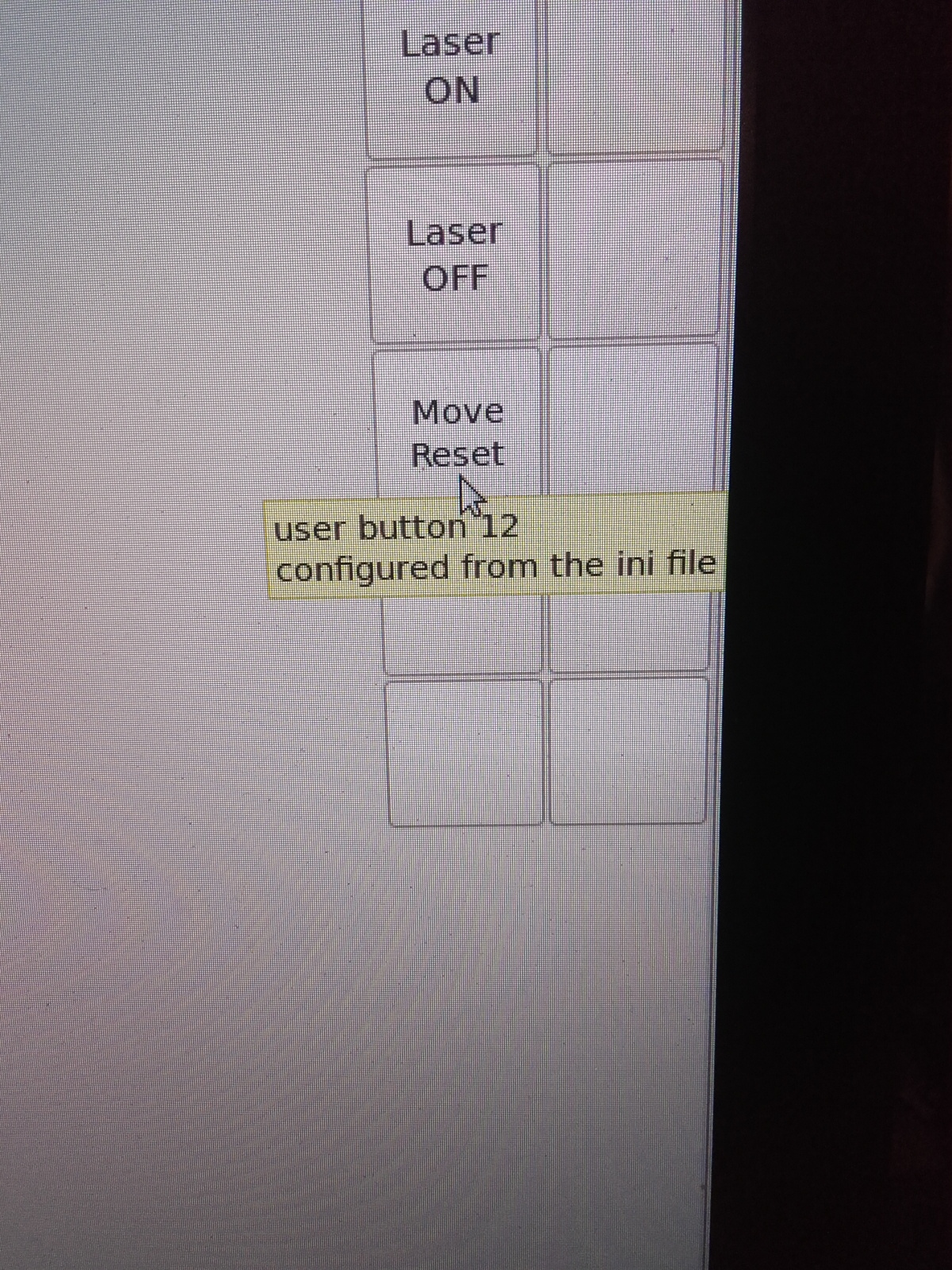

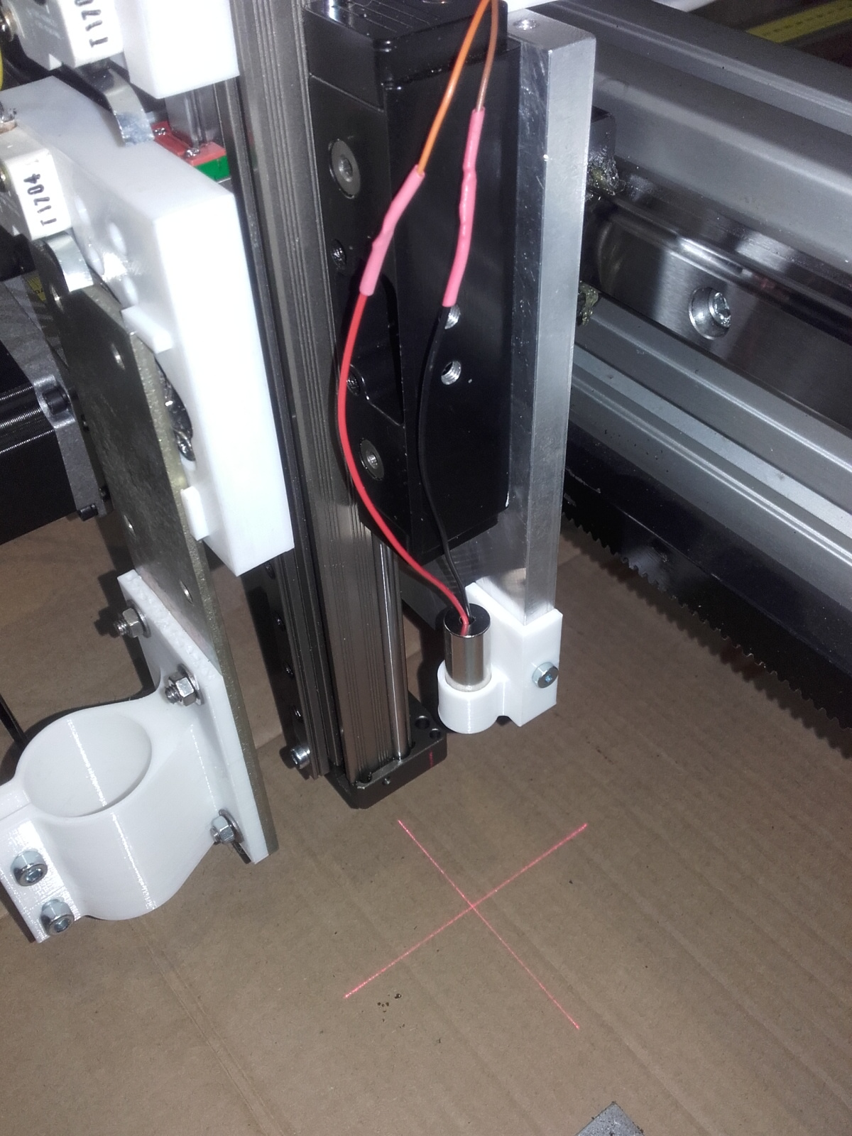

my machine in PLASMAC is called plasmathc
if I create a laser.hal file add it to plasmathc.ini
can I enable a output pin using m62 m65 code with a button from the ten user buttons in the Plasmac Extras panel?
the laser.hal file would be:
net laser motion.digital-out-00 =>hm2_7i76e.0.7i76.0.0.output-06
further I have crane control panel connected. estop works but it has two buttons up and down they are hooked up to hm2_7i76e.0.7i76.0.0.input-06 and hm2_7i76e.0.7i76.0.0.output-05
I would like to use them as pause and resume , or to increase cutting velocity or decrease during operation. I am using version 2.9!

I think that would work. You would only use M64 and M65 as there is no motion while using the laser.
Another option would to use M7 (mist coolant on) and M9 (all coolant off) and connect like:
For pause and resume you could connect to :
halui.program.pause and halui.program.resume
linuxcnc.org/docs/html/man/man1/halui.1.html
net laser iocontrol.0.coolant−mist => hm2_7i76e.0.7i76.0.0.output-06For pause and resume you could connect to :

18 Mar 2020 20:02 #160673
by CNCFred
Replied by CNCFred on topic activate output pin 7i76e via m62 65 for use with Plasmac extra buttons
- phillc54
- Posts: 5711
- Thank you received: 2100
18 Mar 2020 22:15 #160682
by phillc54
Replied by phillc54 on topic activate output pin 7i76e via m62 65 for use with Plasmac extra buttons
Glad you got it going.

at the end the change is simple, on the beginning it is difficult & to get there is a lot of reading and (not) understanding ...and is still far away from using AND OR
The code to move the torch where the laser cross midpoint is
G10 L20 P1 X0 Y0 Z0\G0 X##### Y#####\G10 L20 P1 X0 Y0
#### are the values manually measured
G10 L20 P1 X0 Y0 Z0 deletes the coordinates (not quite sure g54?)

If you use P0 rather than P1 it will use the Work Coordinate System that is current.
So if you are currently in G54 it will use G54.
