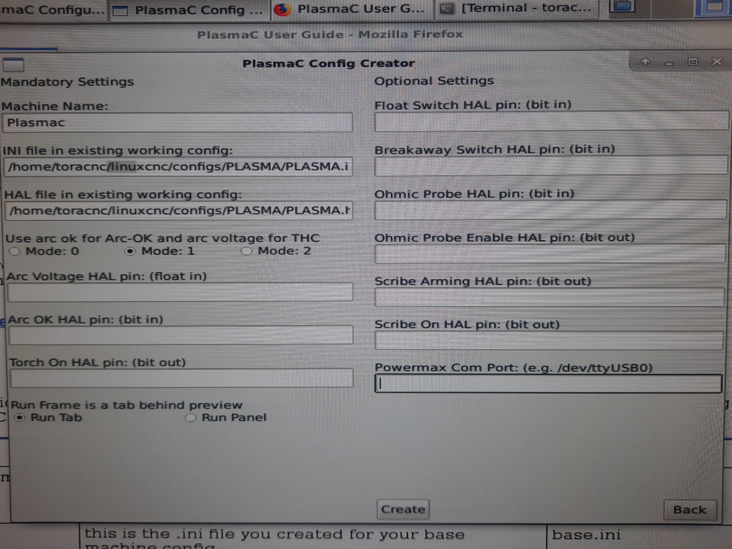

Trying to learn as i go, i am working on configuring plasmac and need to put in the HAL pin's for what i am using in this setup.
I see the examples like: parport.0.pin-10-in-not
hm2_7i96.0.gpio.008.in
Obviously depending on the hardware that would change to suit, I am running 6i25 and 7i76 cards
i am sort of guessing that my settings would be close to:
FLOAT SWITCH: hm2_5i25.0.7i76.0.0.input-03-in (its a normally open switch)
ARC OK: hm2_5i25.0.7i76.0.0.input-10
TORCH ON:
ARC VOLTAGE: encoder.0.velocity
Just after advice on how to figure out what i would put in the (TORCH ON) field, also if the others would be correct? Thanks

Rather than guessing pin names why not open halshow (show machine configuration in axis) and review the actual pin names?
Its a very handy tool...

haha this would be handy thanks =)
