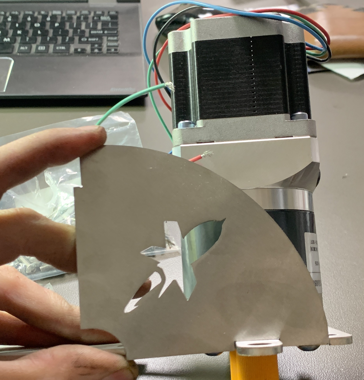

24 Dec 2020 04:37 #193070
Yes prox sensors go blue to negative, brown to positive and black to mesa input.
Thanks for you comments re the spaceship. Spaceship Mk2 is evolving slowly.
Very cool. Not my fingers BTW.
As for Tommy, he is fluent in so many languages, it will take you all day to insult him!
Replied by rodw on topic Controller hardware suggestions for first DIY build
So a prox sensor needs +24v and -24v so put them to the bus bar and then the output goes to an input. It does not matter if its NC or NO.
The spaceship is awesome! Also, FWIW, I enjoy telling my coworkers that I chatted with 'the Australian' and he explained it like this... me doing my best Australian accent
Would you mind sanity checking this for me? The blue and brown are the 24+ and 24- ... does it matter which is which? The black is the output wire that connects to the input on the Mesa card, right?
I am going to take the field wiring from the Mesa 7i76e and connect it to the Mesa din mounted 'common' bus bars. Then I will connect those bus bars to the 24v PSU. AND THEN I will connect these blue and brown wires to the 'common' bus bars, sound good?

24 Dec 2020 12:21 #193101
I don't mean to be overly pedantic here but that would be 48V on the sensor. So just for the record -24V is not the same as 0V.
But yes I do realize that you mean the negative terminal of the 24V DC supply.
Replied by Aciera on topic Controller hardware suggestions for first DIY build
