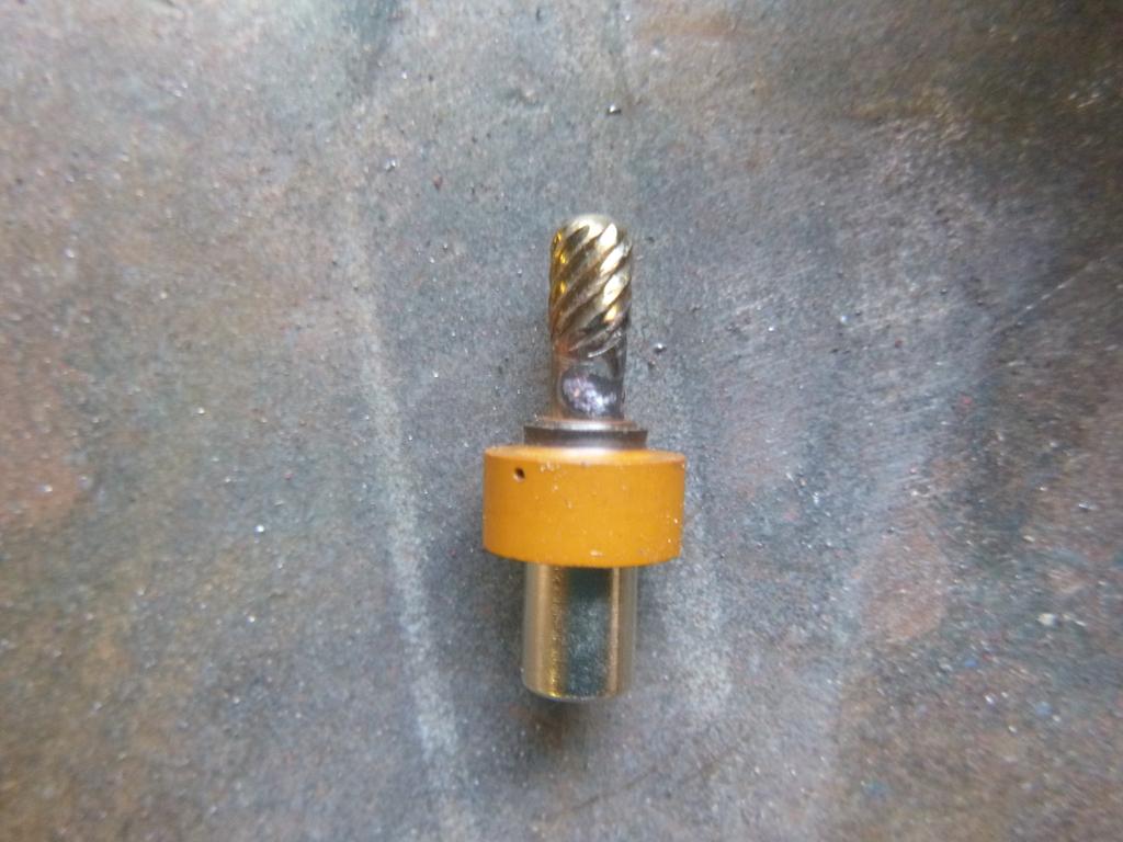

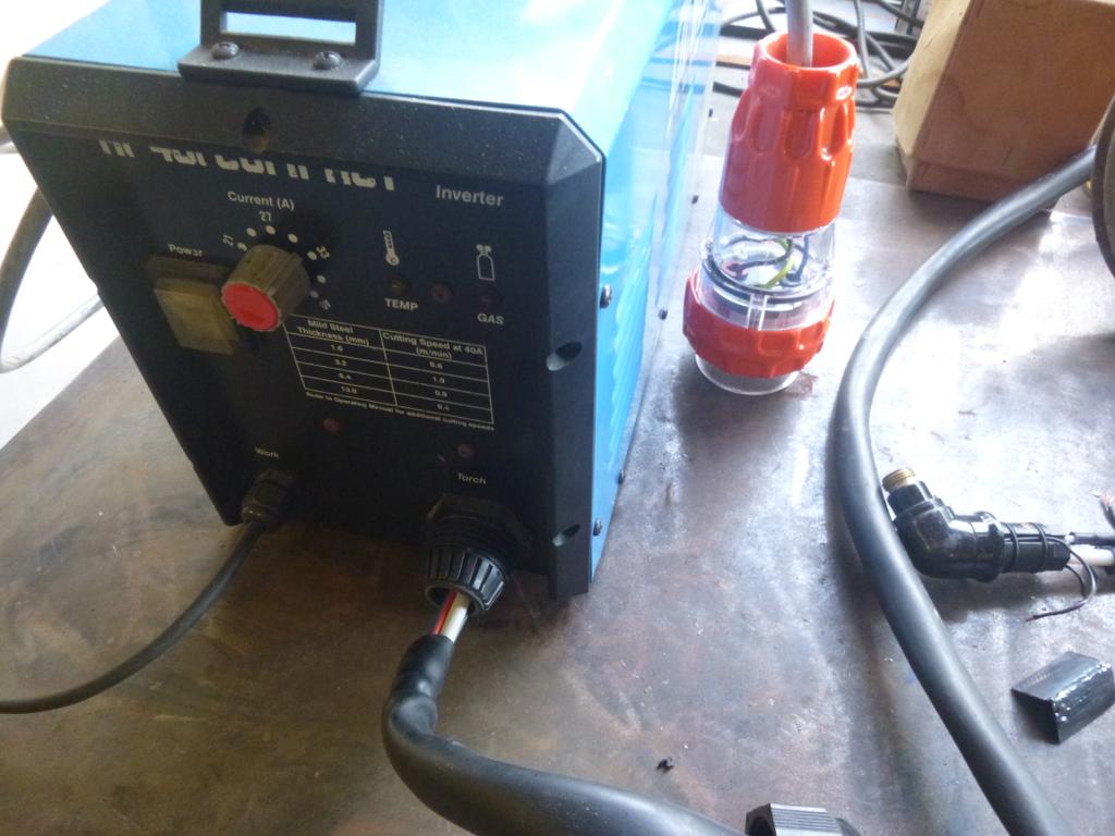

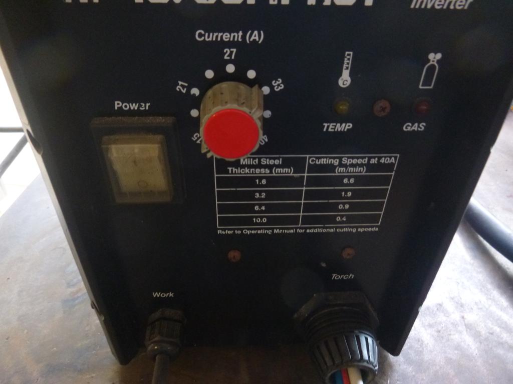

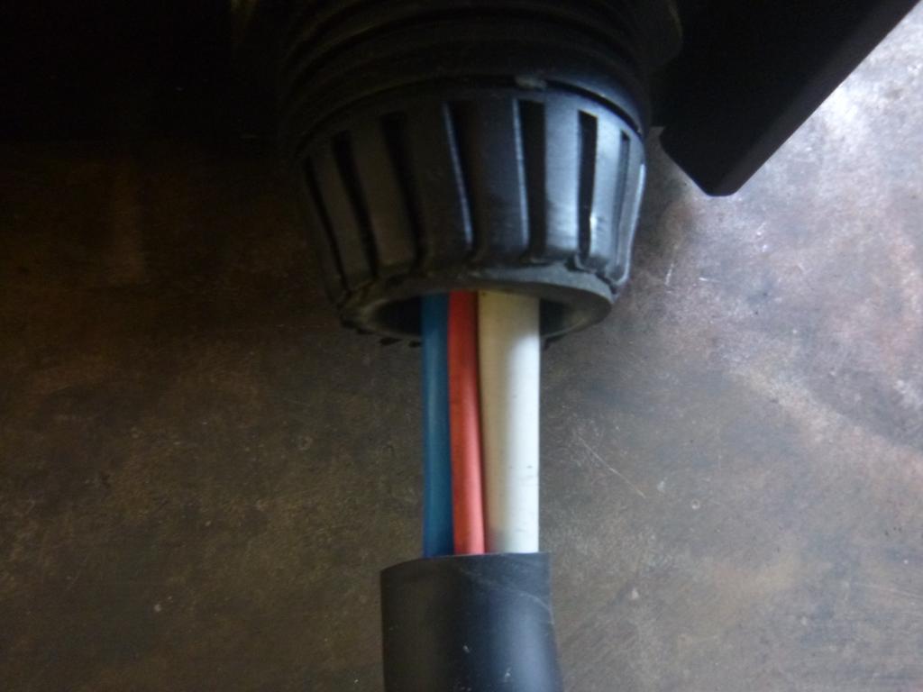

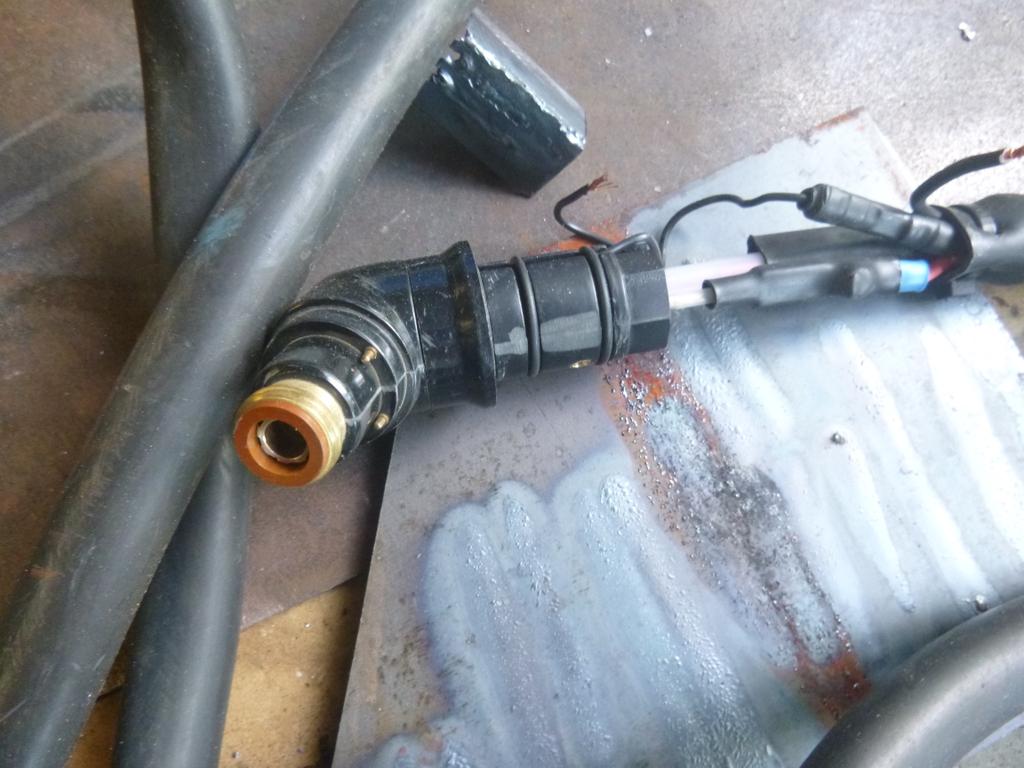

Q5 I have been using an older CIG Cut40i for my initial build. It seems to have died but in close inspection of the boards they look alright and fuses etc have not been blown. I look at the electrode and see that it is badly scorched and the pilot arc doesn’t fire. I have included pics of said unit. Does anyone have any ideas where to look? (I have no circuit diagram, nor can I seem to find one on-line). Is there a replacement torch assembly that is available, or do I just write it off as learning and wait for the new Hypertherm to turn up?

Q5. If your CIG plasma cutter is anything like my long since binned BOC plasma cutter, its not worth attempting to repair. We attempted to fix a BOSS Cut40 and afterwards it let the smoke out in a spectacular and very loud explosive statement! My advice would be that your plasma cutter joins mine in landfill somewhere!

Skipping everything else, to check if the plasma is still working, get a short piece of thin wire, insert it in the nozzle hole so it touches the electrode inside and still protrudes about 2 to 3mm out, touch the protruding part to some scrap metal (attach clamp) and slowly drag it while firing the torch. Might tame some tries, but if it does fire and cut, the LOW voltage part is OK (big transformer and rectifier).
For the pilot arc, check the air pressure (from your picture the electrode looks like it was fired with no air at all ) it should be 5 to 6 bar/75 to 90 PSI, check the swirl ring for scoring and black charring - replace if such is present.
