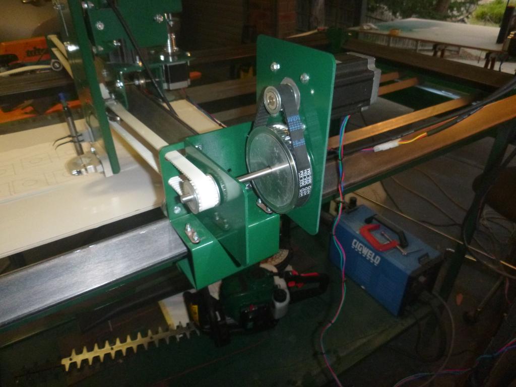

I designed a 4:1 reduction based on TommyLight's recommendation. I will start with 3200, which in theory should give me (.787) 20mm with a 4:1 reduction (Pi 3.1417) 3235.7224.
What do you reckon. Make sense?
