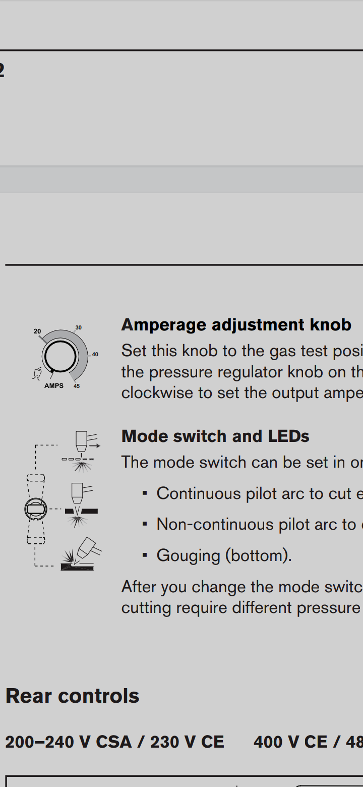

remember the manual pot does not go from zero to 45 A,
at the extreme LHS it goes into an air test mode, and the lowest amperage is 20A
the 45xp goes from 10A to 45A (annoyed the hell out of me about 2months after I bought the 45 the 45xp came out as I would have gone with the 45xp with CPC and rs485... c'est la vie!)

Replied by rodw on topic Plasma Current Control on the Fly (synchronous with motion)
Thats exactly the reason why a custom component was suggested. Those peculiarities can be incorporated into it.
You could have another pin for air test mode that if true would send the correct PWM and it could also make sure the minimum value is set to 20 amps or higher. The minimum value (20amp/10amp) might be another parameter.
