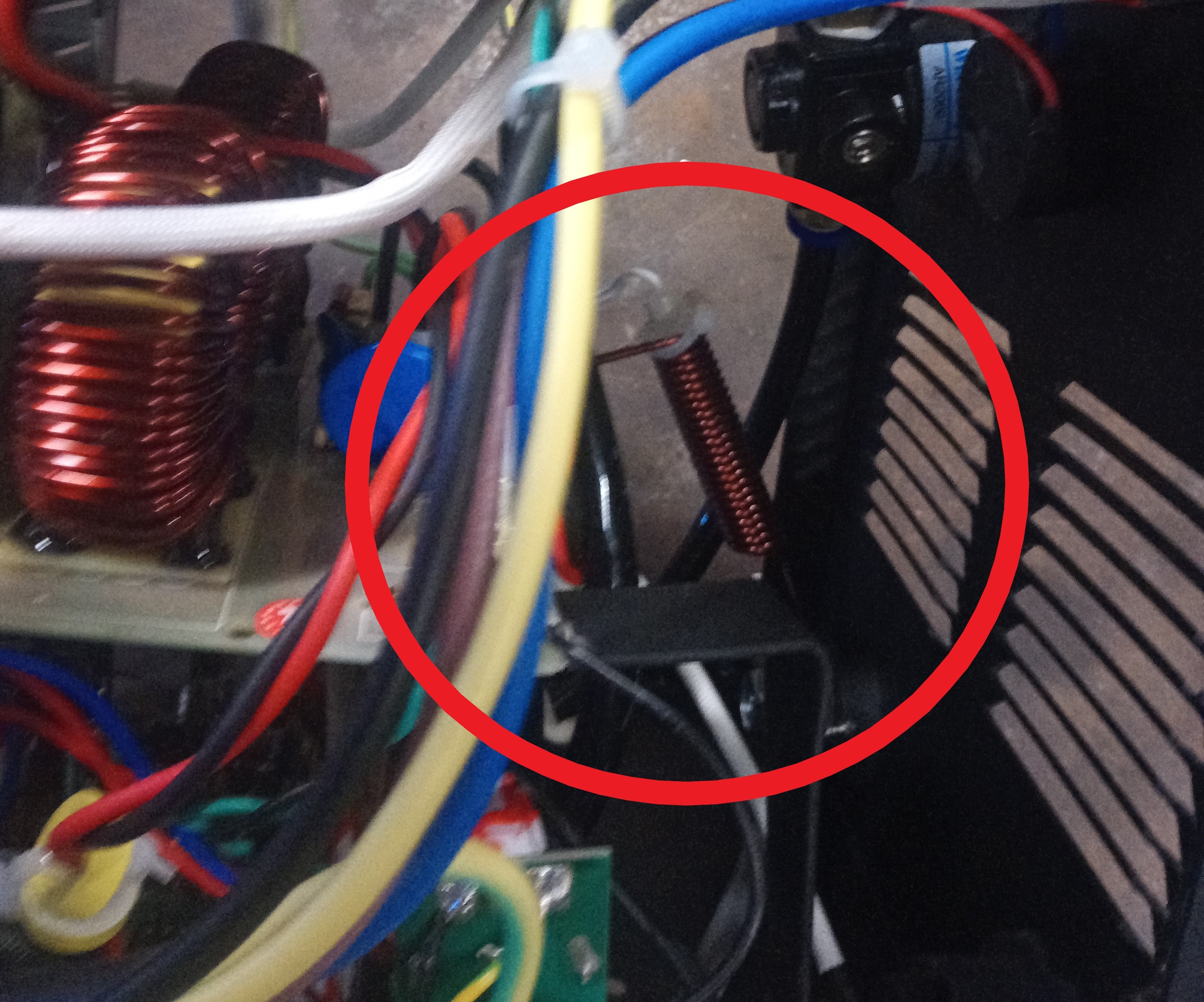

24 May 2021 14:08 #210062
by samforsey12345
Replied by samforsey12345 on topic ArcOK when not built-in
You might find that the plasma cutter has a neat one internally. Picture shows tight coil of copper with a reed switch glued in on the ground side. Ideal really...
I didn't end up using it but expect would be highly reliable
