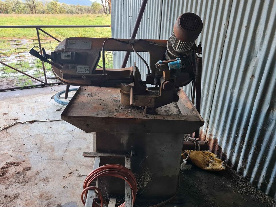

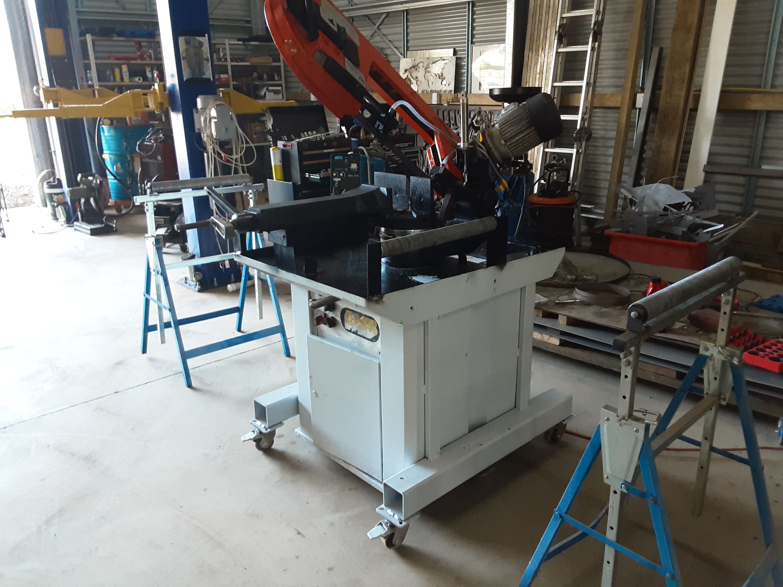

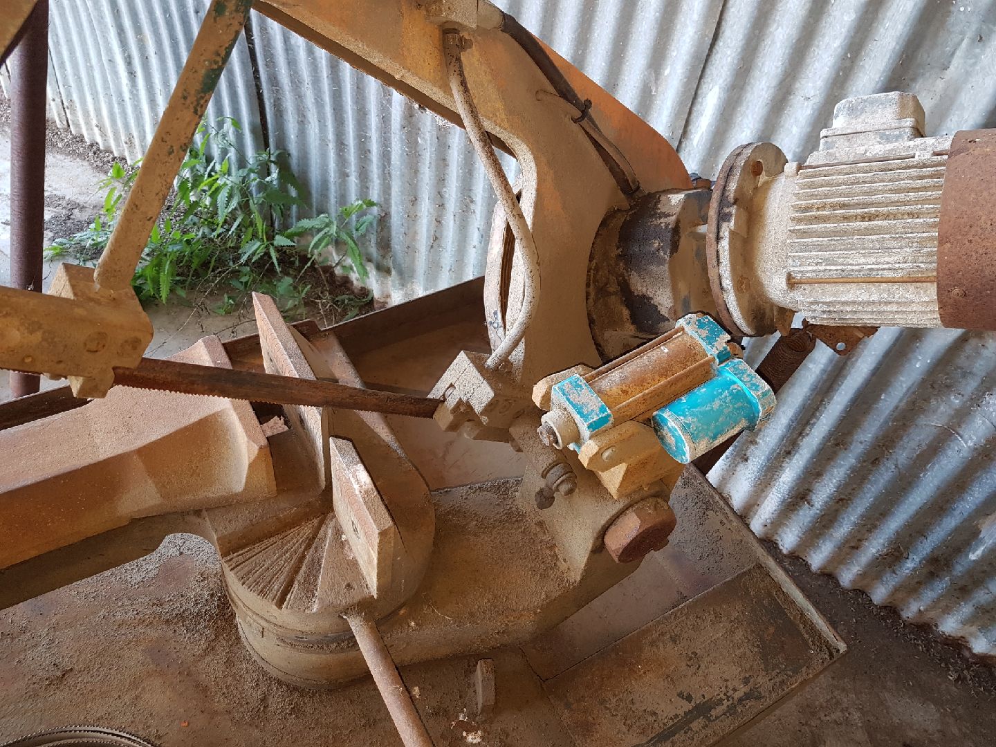

Some before/after pics of the bandsaw attached

Before pic

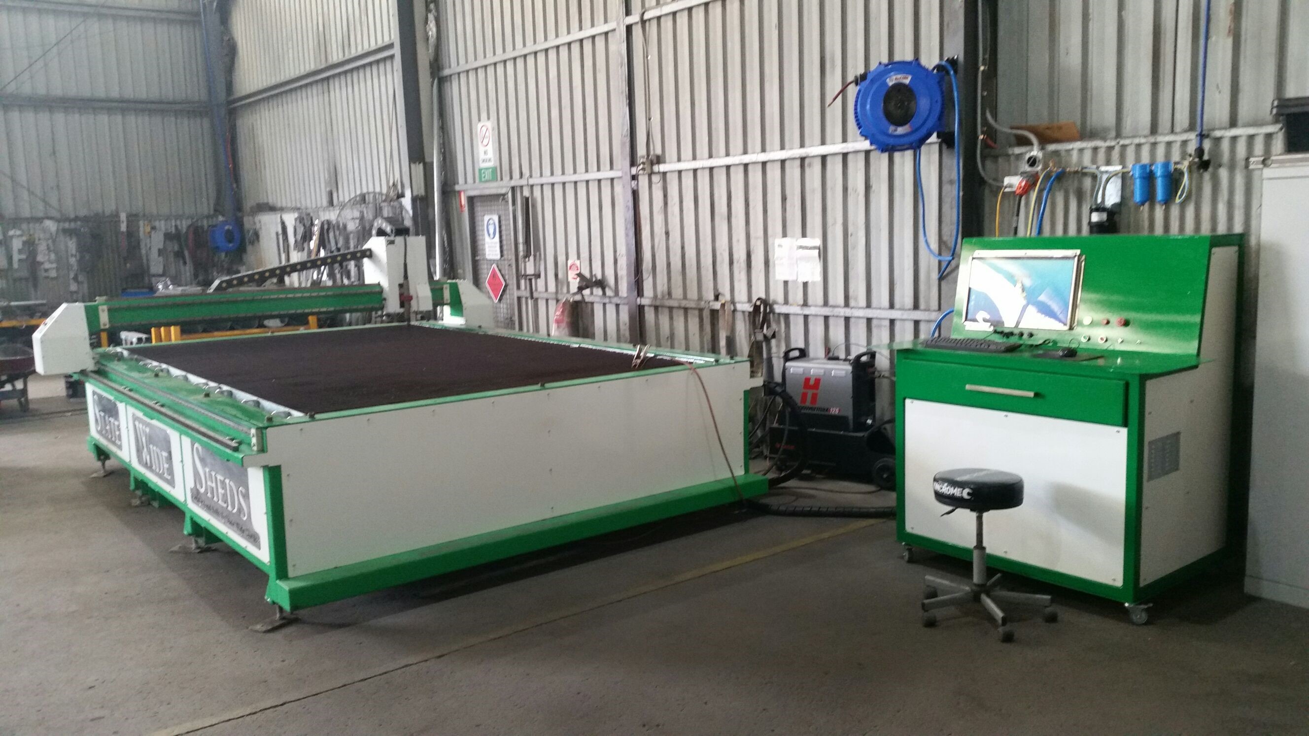

I brought my Hiwin 25 linear rails from Industrial dynamics in Melbourne- industrialdynamics.com.au/ , I am in Dubbo but the freight was pretty reasonable. I brought 2x4000 and 2x2500 lengths.

Also a better pick of how the saw looked when I got it. Cost me $300 and $800 to refurb. Now has all new bearings, guides, downfeed and a complete rewire.
