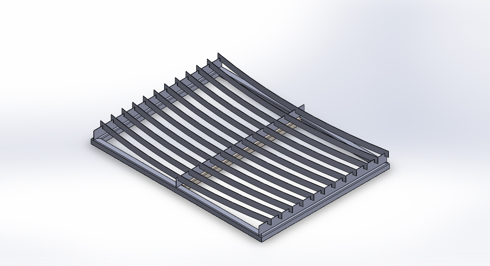

My thinking as well on the slides.
For some reason I though your was for 6m sheet, so I will be simular size.
Toyed with downdraft but after modeling in solidworks could not get the results I was after. Well could do it but did not want the investment in the fans needed so went back to water table.
I planning to have a gutter between the table and slats (50mm) all around.
So the cutting area will be 1900x3200 with and extra 500mm for the parking area. I will locate a sump under the parking area for the fill and drain connections.

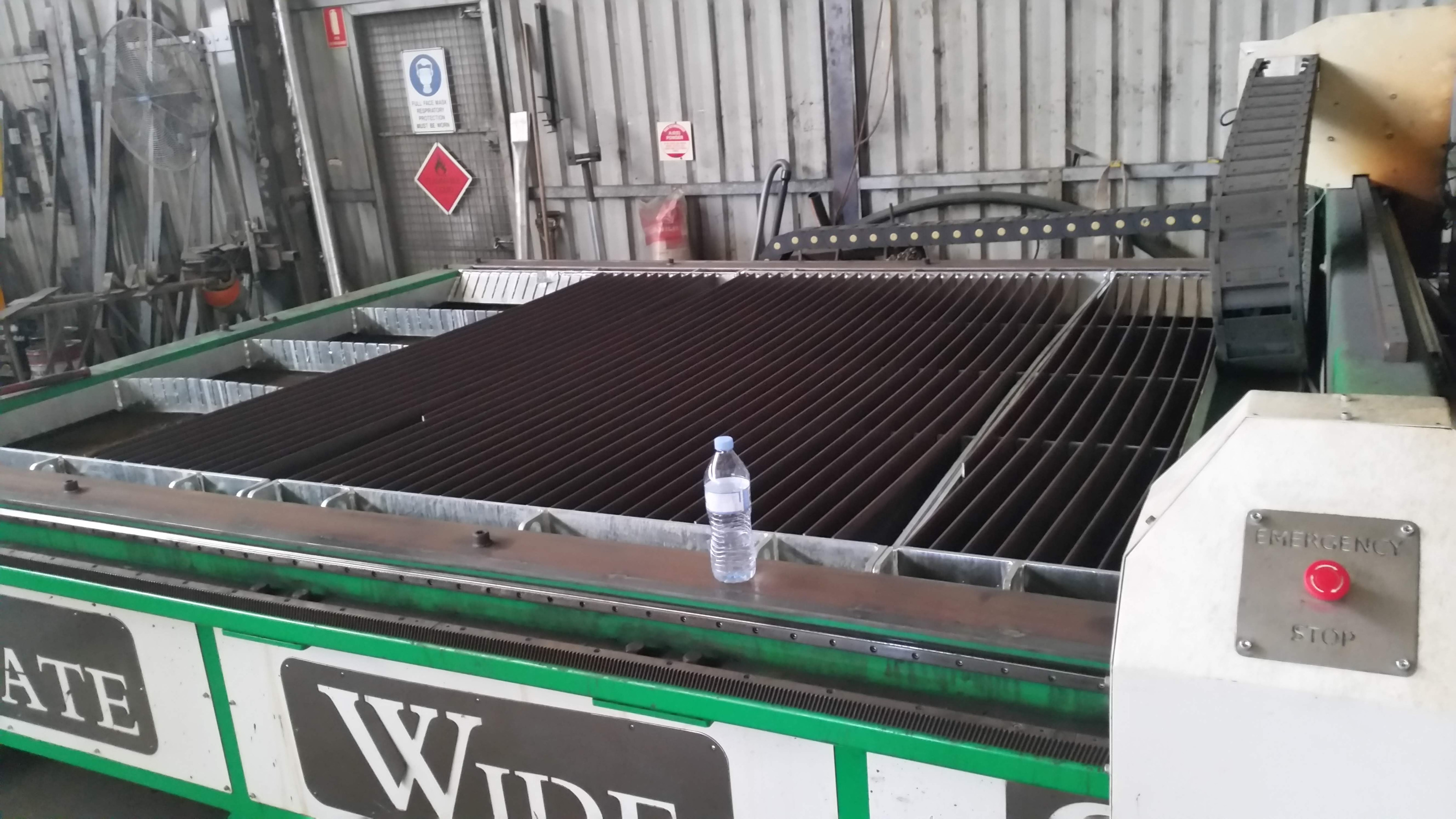

Like you we dont really have the tools to move the large 6m sheets around easily. 3000x1500 is plenty big for our workshop.
For a large table the fans needed do become rather expensive. I am pretty happy with my water table.
I have made removable slat holders so the slats can be lifted out in sections which for a large machine that get used a fair bit saved a lot of time.
Make sure you size your tank according to your water pan volume and add a bit more volume, I did not size my first tank correctly and had to make a new one.

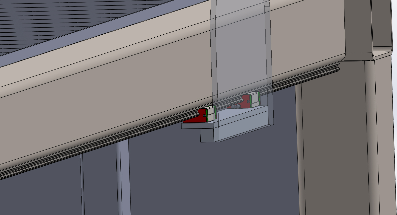

on the subject of side mounted rails, I mounted mine lower on a steel plate that rested on grubscrews at each end to allow it to be aligned before clamping off. This also would have let me shim the mounting plate but it was not required as we were able to make a temporary "gantry mounted upside down when welding to check for alignment

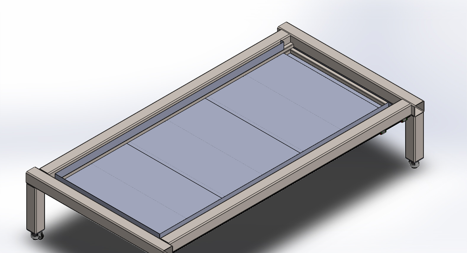

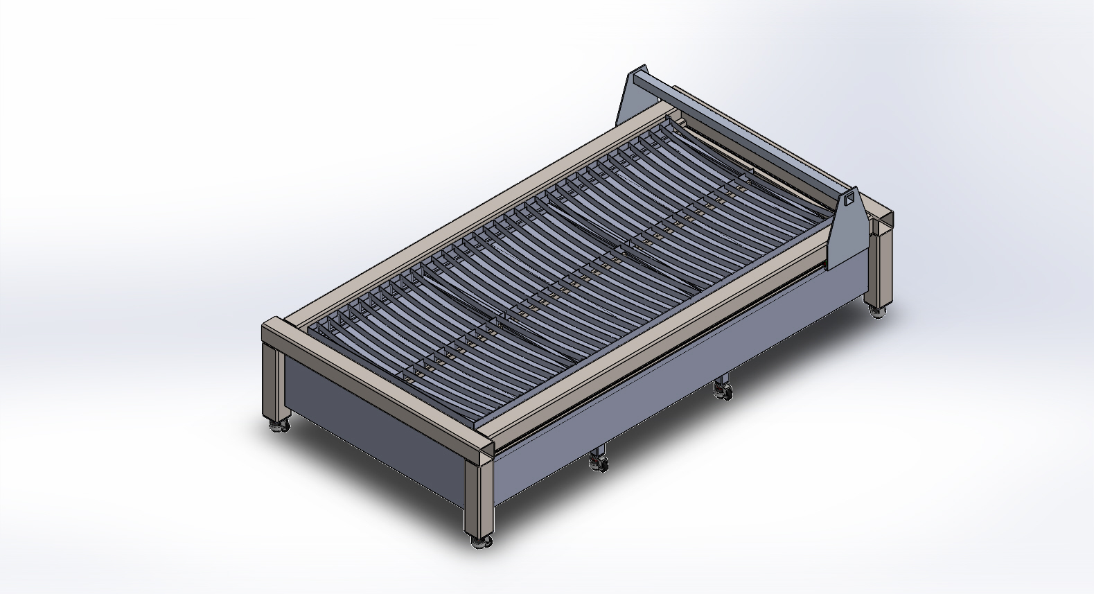

16 Jul 2021 07:44 #214998
by 34by151
Replied by 34by151 on topic New Plasma build in OZ
Finally got most of it into Solidwoks
I havent drawn everything in and will need to do that before I can do some FEA testing.
Here is the basic design
Working area is 3300mm x 1900mm
Gantry has a parking area
A sump is located at the far end under the parking area
Water pan is flat to make cleanout easy
Rails are on the bottom
Legs are on height adjustable casters
Rails are removable and sit in 3 removable trays
Around the edge is a splash gutter
Need to finish drawing it up and run some tests
I also plan to use timimg belt drive for X and Y
First quotes are comming in for the Hwin Rails, hope to order them soon and get building
Cheers
Jim

16 Jul 2021 09:25 #215006
Replied by rodw on topic New Plasma build in OZ
Looks good..

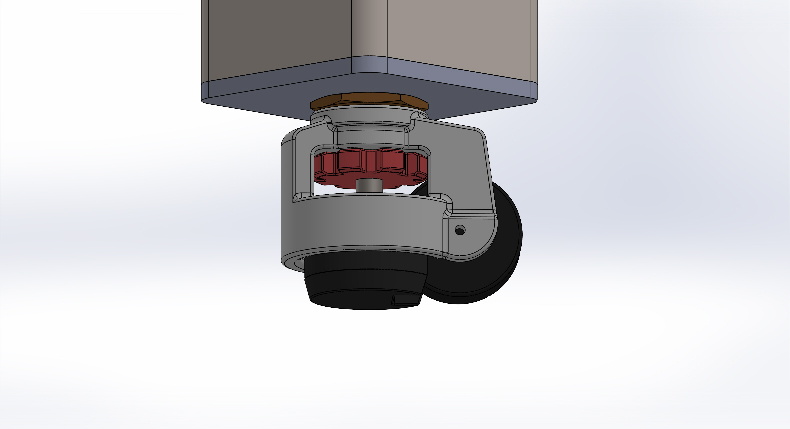

I'm a bit concerned about your casters. The threaded extension rod seems quite small. I used 4 x 300 kg casters but also made provision for adjustable feet on an M30 thread. Needless to say, I have removed the casters due to excessive wobble. Even without a water tray, its darn near impossible to move my 4 x 4 table on the casters.... but they were handy until I finally got it to its final location...
Please share your Hiwin pricing when it comes in. I added a new Chinese supplier yesterday who list it. I might be able to help. I ordered a Z axis as a sample so will see what it looks like when it arrives.

16 Jul 2021 09:49 #215011
by 34by151
The casters are a mix of GD150F for the main 150x150 legs and GD80F for the iside legs.
The 150F is rated to 1500kg and the 80F to 550kg.
Hat you cant see in the pic is the mounting plate. Im guessingyour looking at the adjuster bolt that lowers the wheel. Thes normall sit on the pad and the wheel is only down to move it.
If it was to be moved it would be with the forklift or the tractor doing the moving
