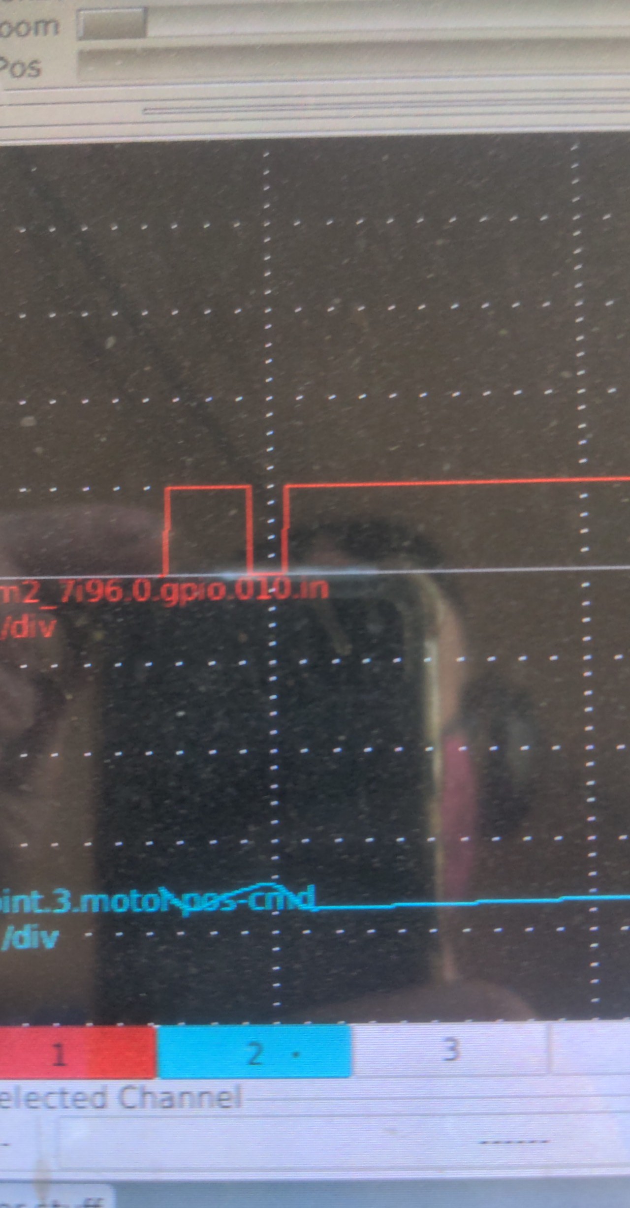

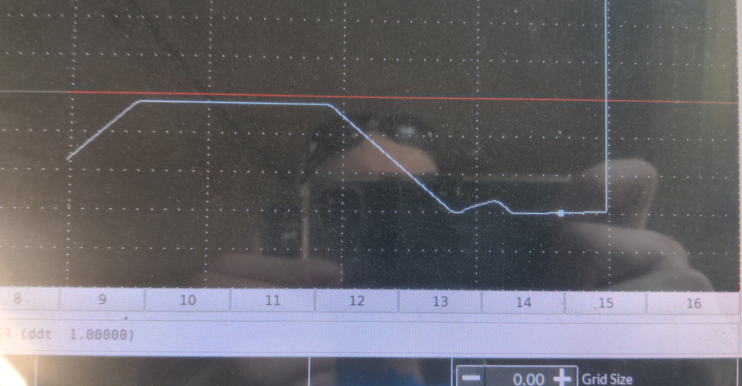

Ohe, Rodw is talking about me.
20mm probe height, 25mm safe height,
probe moves to probe height,
moves down for contact
makes contact
moves off slowly (this is what started the conversation) until contact is lost,
then advances towards material until contact is made again,
and rapid to pierce height.
i took a quick picture of a scope with probe vs z axis commanded position. shows the little dance.
makes contact

I Still don't understand why it bounces above the plate and mine does not. You said you are using Ohmic sensing with relay. My first thought was it was too much hysteresis in the float switch but you are not using one. I think the relay you shared had a 10 ms on time and 6 ms off or something like that. Plasmac by default has a 5 ms debounce time so that could add a bit more time.
But I'm wondering if you are contacting the material before you reach probe height? I think Plasmac backs off and reprobes in that instance
Any other ideas?

if that were the case, i see the error,
probe tripped before reaching probe high adjusting safe travel height.

by phillc54
Replied by phillc54 on topic Fast Probing with QTPlasmac
It doesn't give an error for that, it will retract and then try to probe again.
Probe Height is the height above the minimum limit.
Safe Height is the height above the probed height of the material. Plus or minus any warping of the material during cutting if THC is active.
They have no relationship to each other.
