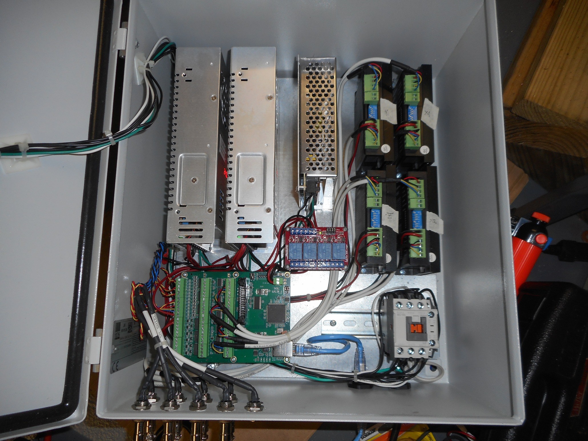

Still fighting it. I set up a HAL meter with the input hm2_7i96.0.gpio.001.in and a HAL meter with plasmac.float-switch. Both become TRUE when the float switch is made along with the on-screen indicator, but still isn't working right. Z travels down fast until float switch is tripped, then z keeps traveling down but at a slow speed. When timer completes, z travels up back to start position.
Where else should I be looking?
Just so you know, not all my wires are just twisted together.
Thanks again to those trying to help me.
