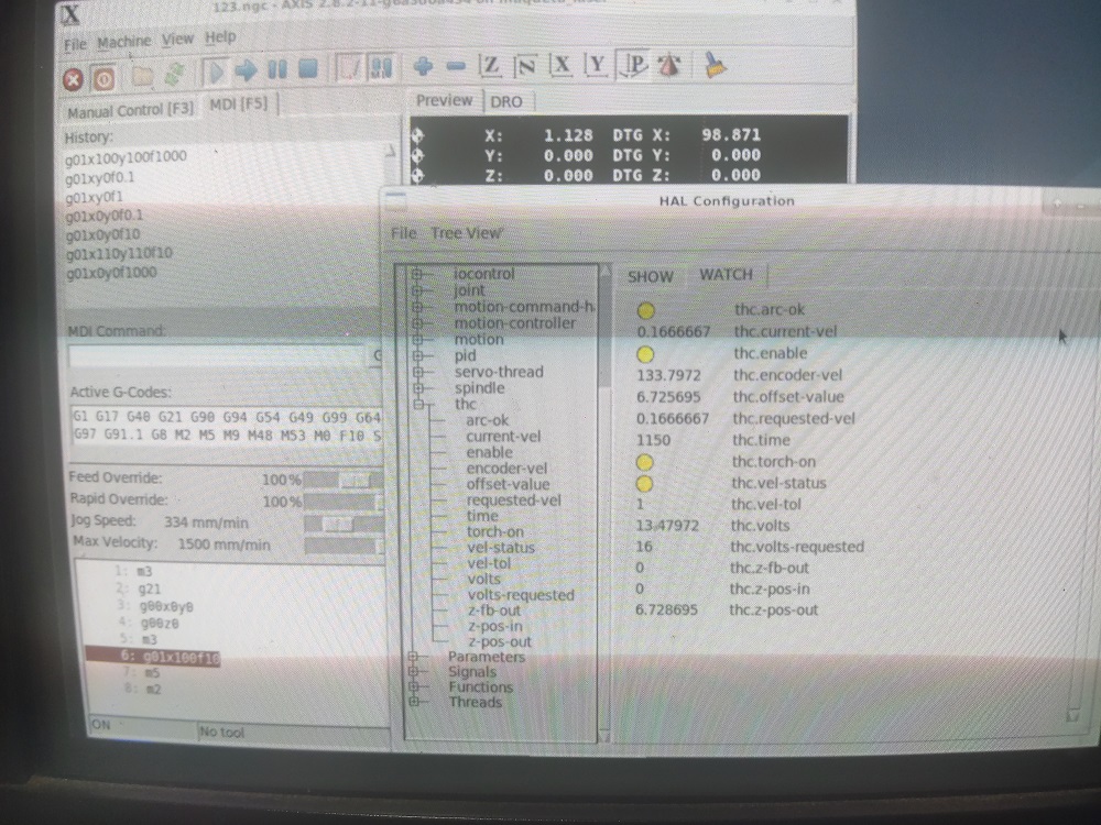

I'm creating a fiber laser cutting machine. The fiber laser module, laser head and chiller is on the way and I already have a mesa card 7i93 for this purpose. I don't want to use plasmaC I plan to use only Axis. At this moment the "problem" is the THC comp is working but the Z axis dont want to move. I made a simple capacitance to frequency converter and i have a potentiometer to simulate the laser head gap the frequency is in one of the 7i93 encoders the value reads good but no z response. The THC can work without PlasmaC ?

Another thing is that I need to know exactly where the material is without touching it The fiber laser THC works with a capacitive THC which provides a voltage from 0 to 10V or a frequency depending on the height of the material with respect to the head. My idea was to use the hal comparator and set one of the values to a known frequency and to a known height, for example at 3mm, the frequency is 3khz when the laser head goes down and is with 3khz the output of the comparator will change that signal is net to motion.probe-input and i can do the probe routine.
But I don't know how to make the THC work. Z axis works normal with jog and in Gcode.

LinuxCNC is very modular, so if you mean linuxcnc.org/docs/html/man/man9/thc.9.html then it can work with anything, even with you typing in numbers from a ruler :-)The THC can work without PlasmaC ?

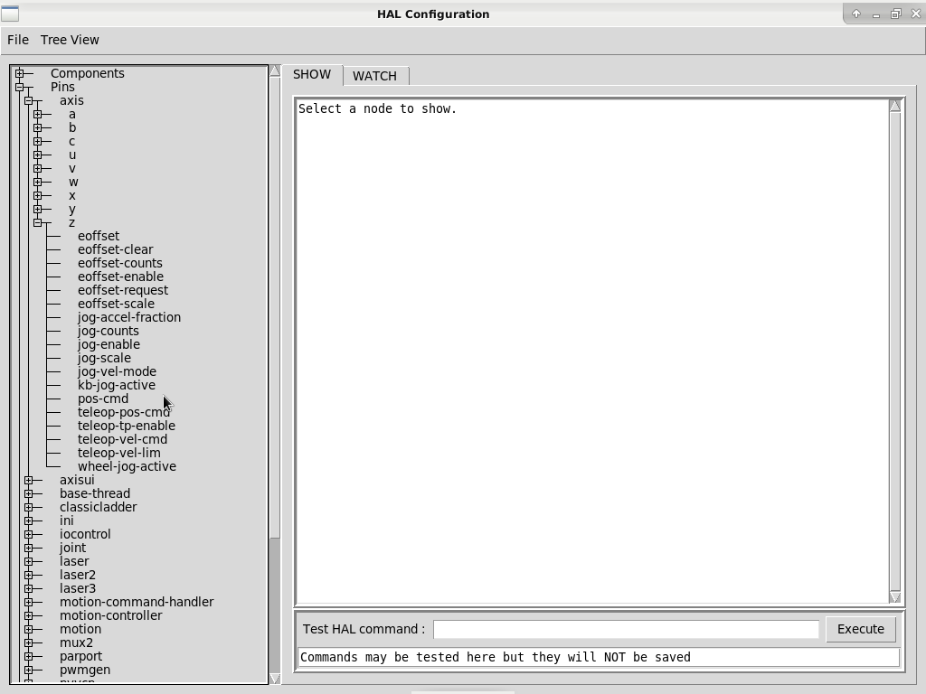

I have had many problems with THC comp, I do not know how to connect the thc feedback in the hal. I can't find the following pins in the hal config:
motor.02.pos-fb
axis.2.motor-pos-fb
And therefore I can not do the net thc.z-fb-out in hal
net motor.02.pos-fb axis.2.motor-pos-fb <= thc.z-fb-out

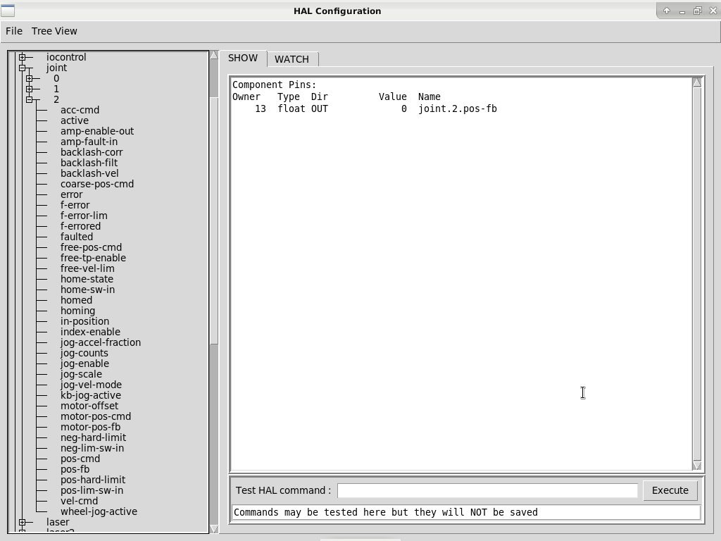

The same i cant pin axis.2.motor-pos-fb.So i swapped them for these:
net zpos-cmd joint.2.motor-pos-cmd sum2.0.in0
net zpos-sum sum2.0.out => stepgen.2.position-cmd
net zpos-fb stepgen.2.position-fb => joint.2.motor-pos-fb
net zoffset sum2.0.in1 <=
It works but Linuxcnc throws me " joint 2 following error " the only way i found to work is by changing MIN_FERROR to MIN_FERROR = 100
motor.02.pos-fb
axis.2.motor-pos-fb
