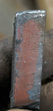

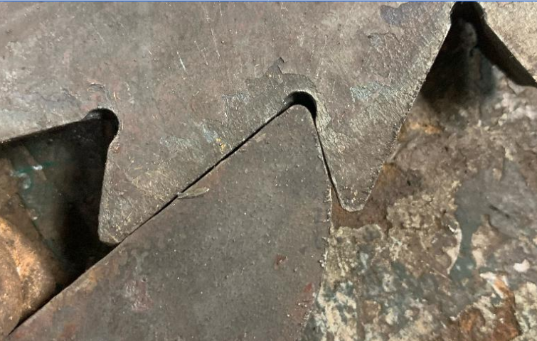

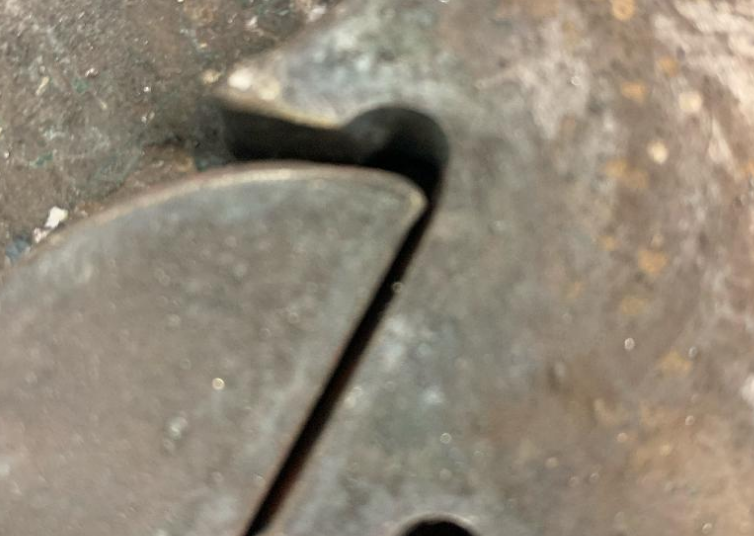

evening all,
I have been trying to cut some 10mm plate with my CNC (LINK - forum.linuxcnc.org/show-your-stuff/42411...p-plasma-cnc?start=0 ) ( it's a long read so her are the important parts - QtPlasmac, 1200x1200 bed with ballscrews, 7i96, THCAD10-THC, THCAD10-Ohmic sen, Unimig RazorCut45 plasma)
And while I have dialed it all in fairly well i'm still having issues with the kerf on the cut.
I have been cutting a simple gear and spike and the front is sweet, but the back is not. I'm getting a taper on the cuts that would indicate the torch height is to low, however, the torch height is great up to 5mm.
FYI I'm running 45Amp, 270mm/min, Pierce height 3.7mm, Cut height 1.3mm.
Any suggestions ? what settings are you using for 10mm steel?
Pictures
Cheers

The fact that you achieved that cut with a 45A ( probably lower if it is china...) is magnificent !
10A per mm is a general rule for good cuts.
As with everything, that is not a rule, it can vary a lot, form quality of the current provided by the plasma source, to torch, to nozzles, to material content, to humidity in air, etc etc.
