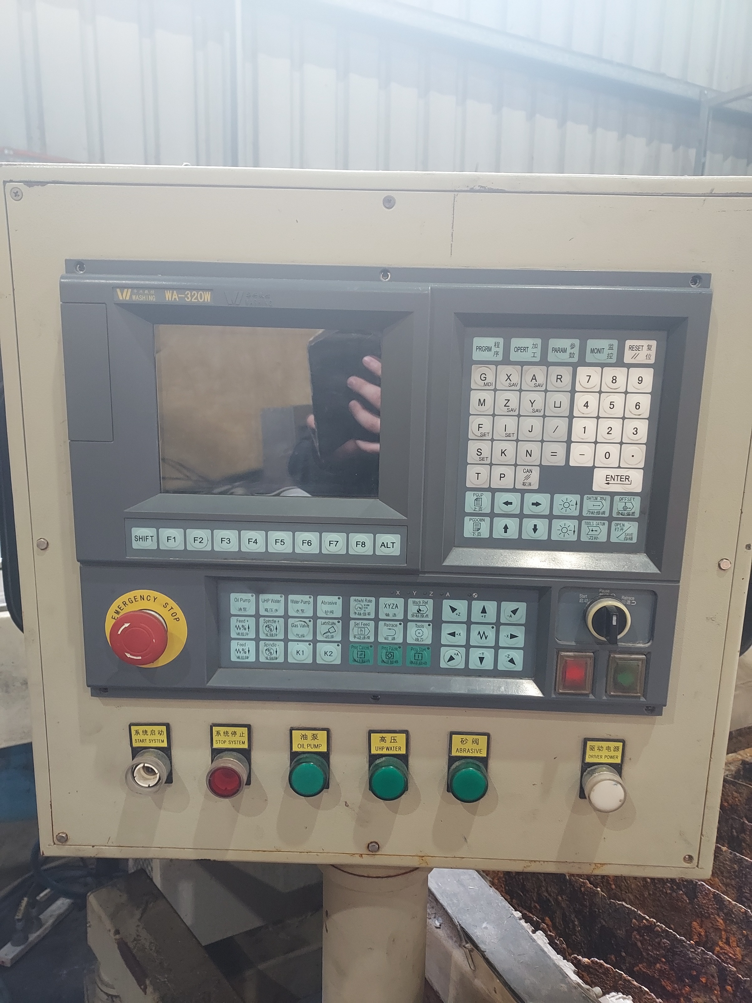

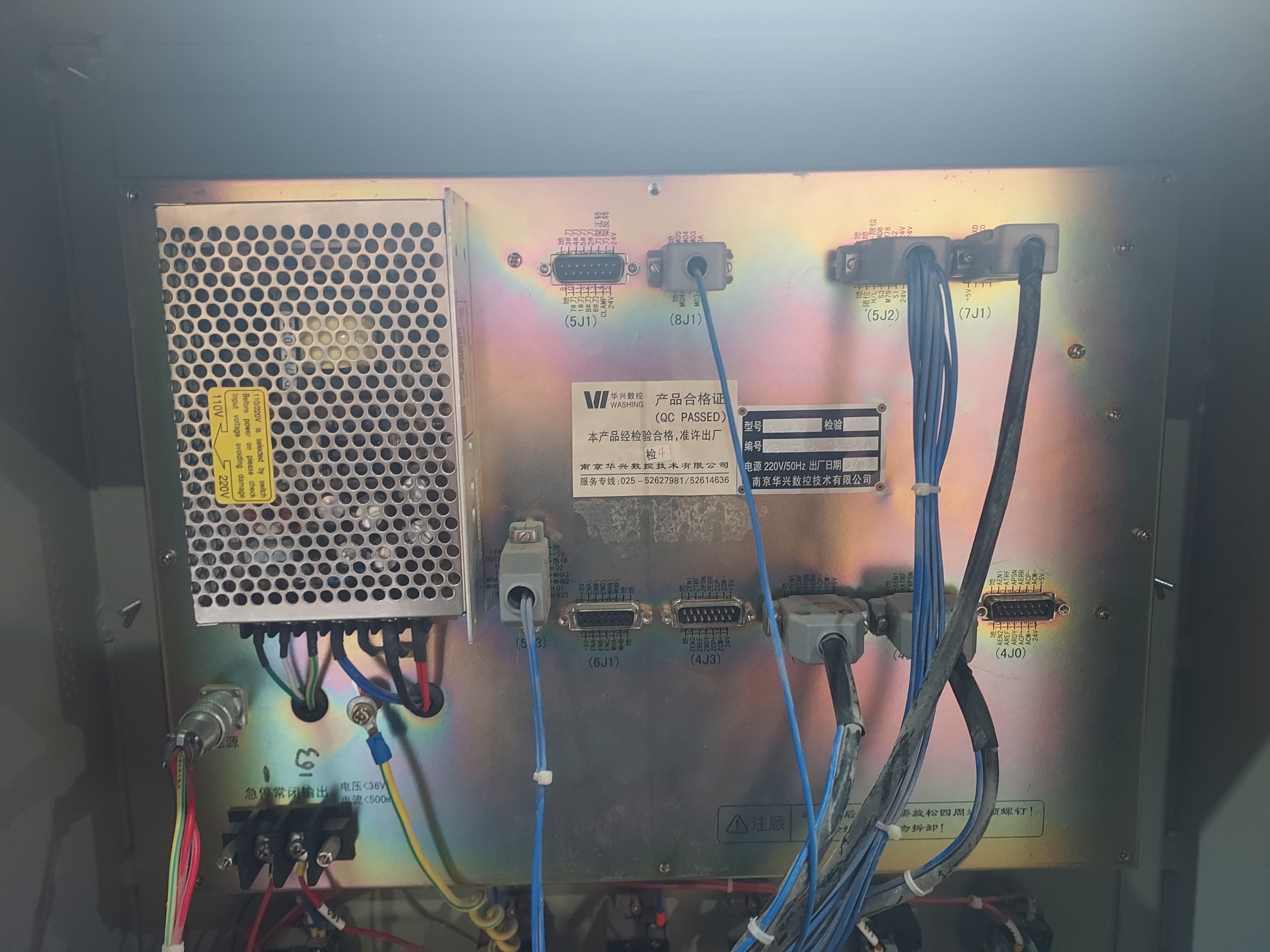

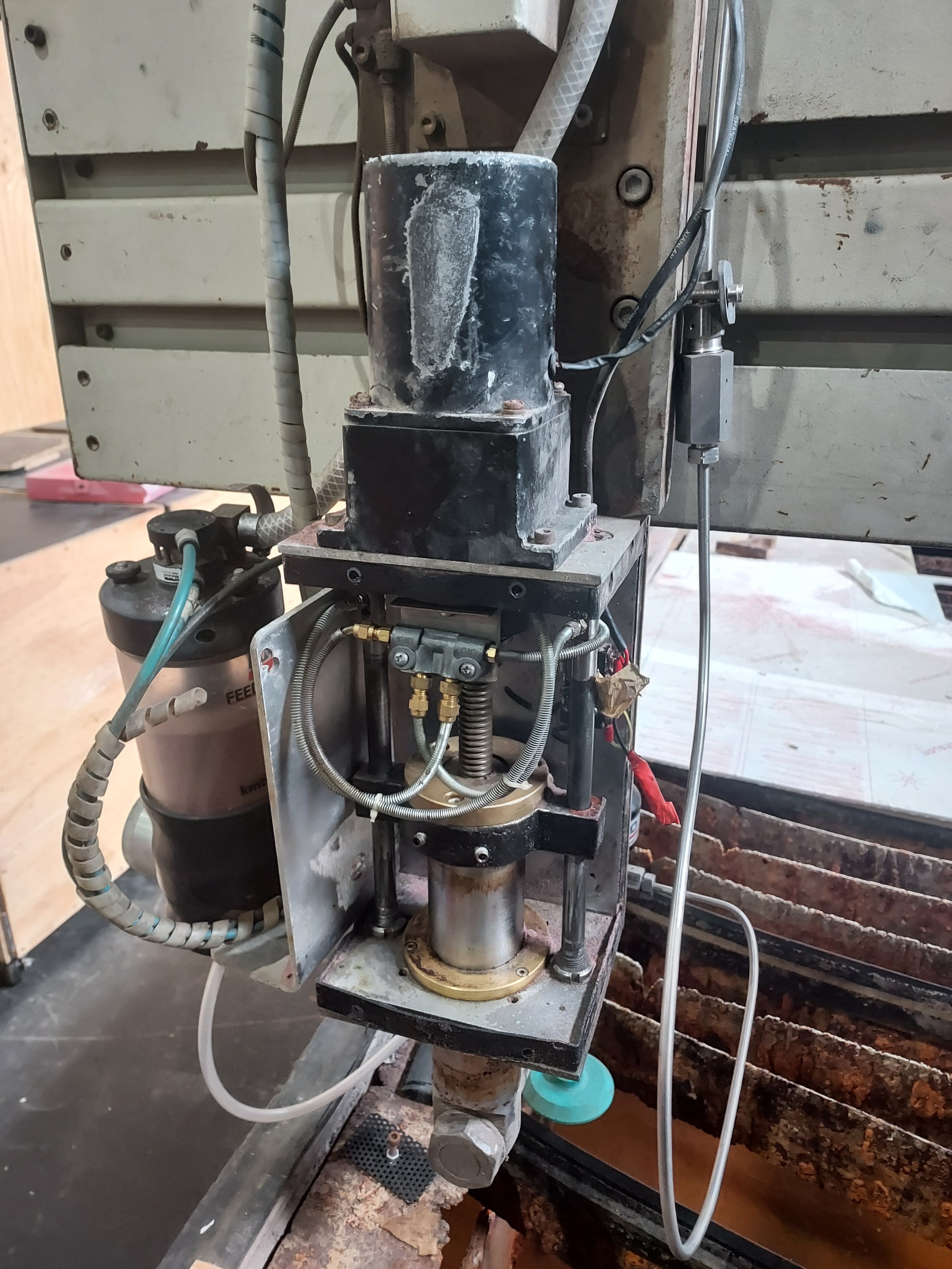

other helpful pictures would include the Z axis motor, the inside of the control cabinet,
the control panel, that sort of thing. As far as the multi wire cables this can actually make
life easier when tracing things out. A very important tool will be a multi meter for voltage and
continuity testing . you will probably want to keep a note pad with you so you can write down
what wire number does what. Also be ready to research alot of the components individually
online that way you will be able to get pinouts of what wire should do what.

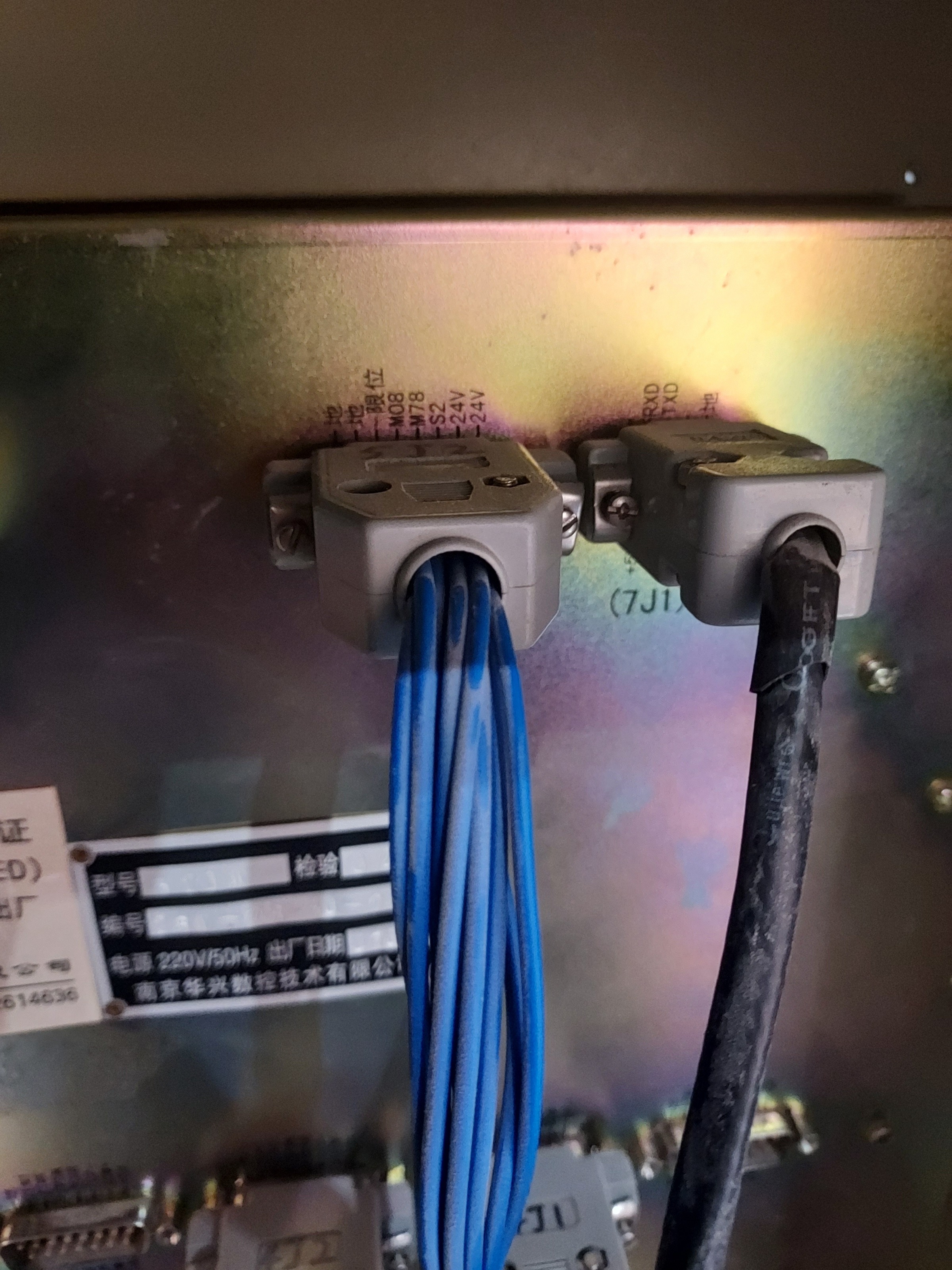

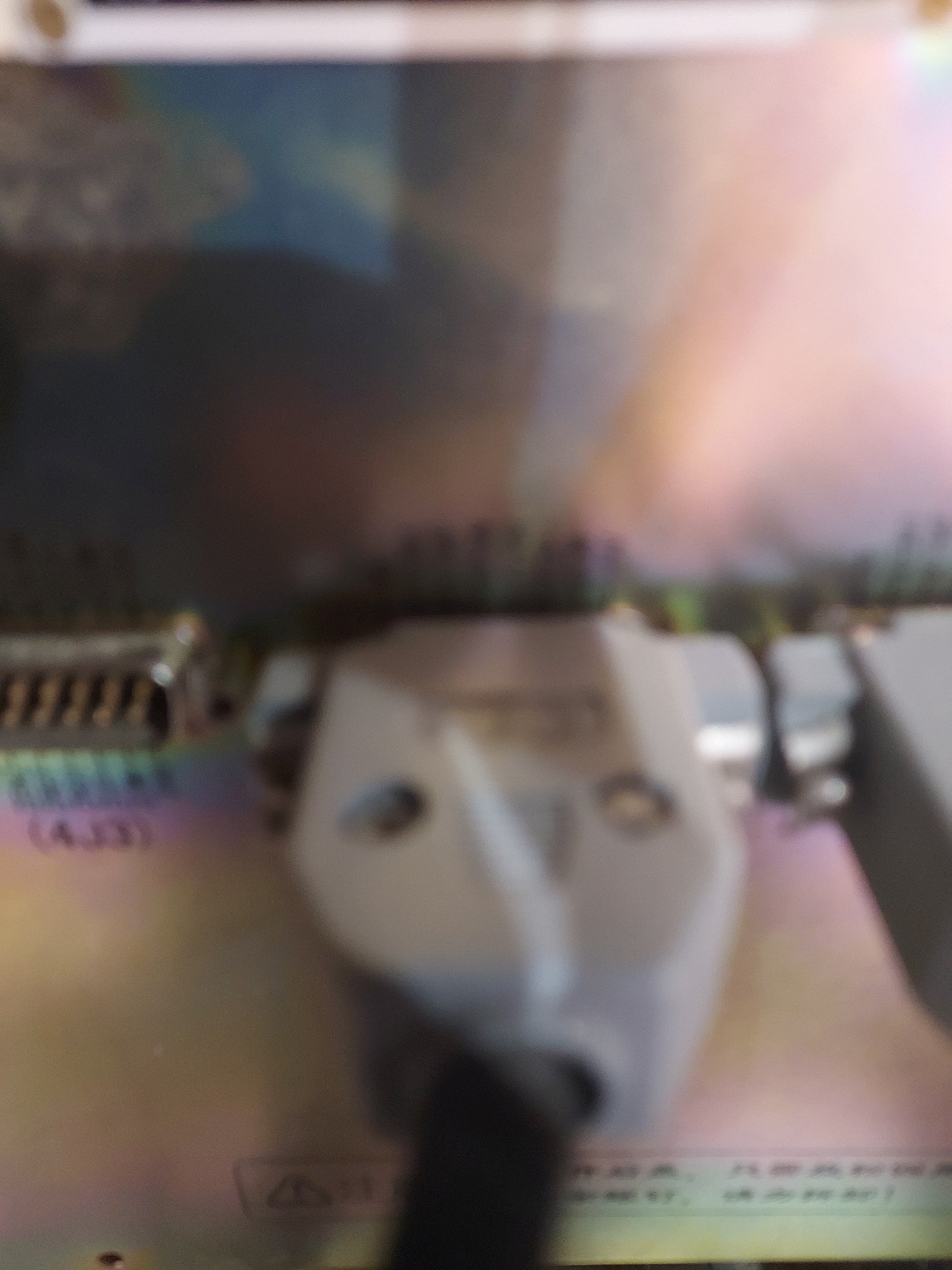

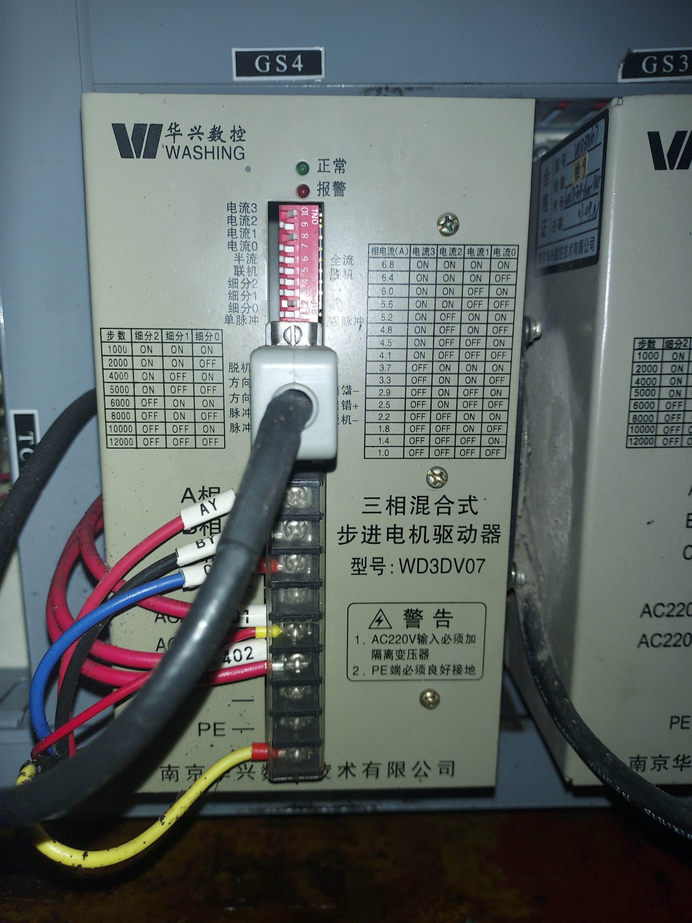

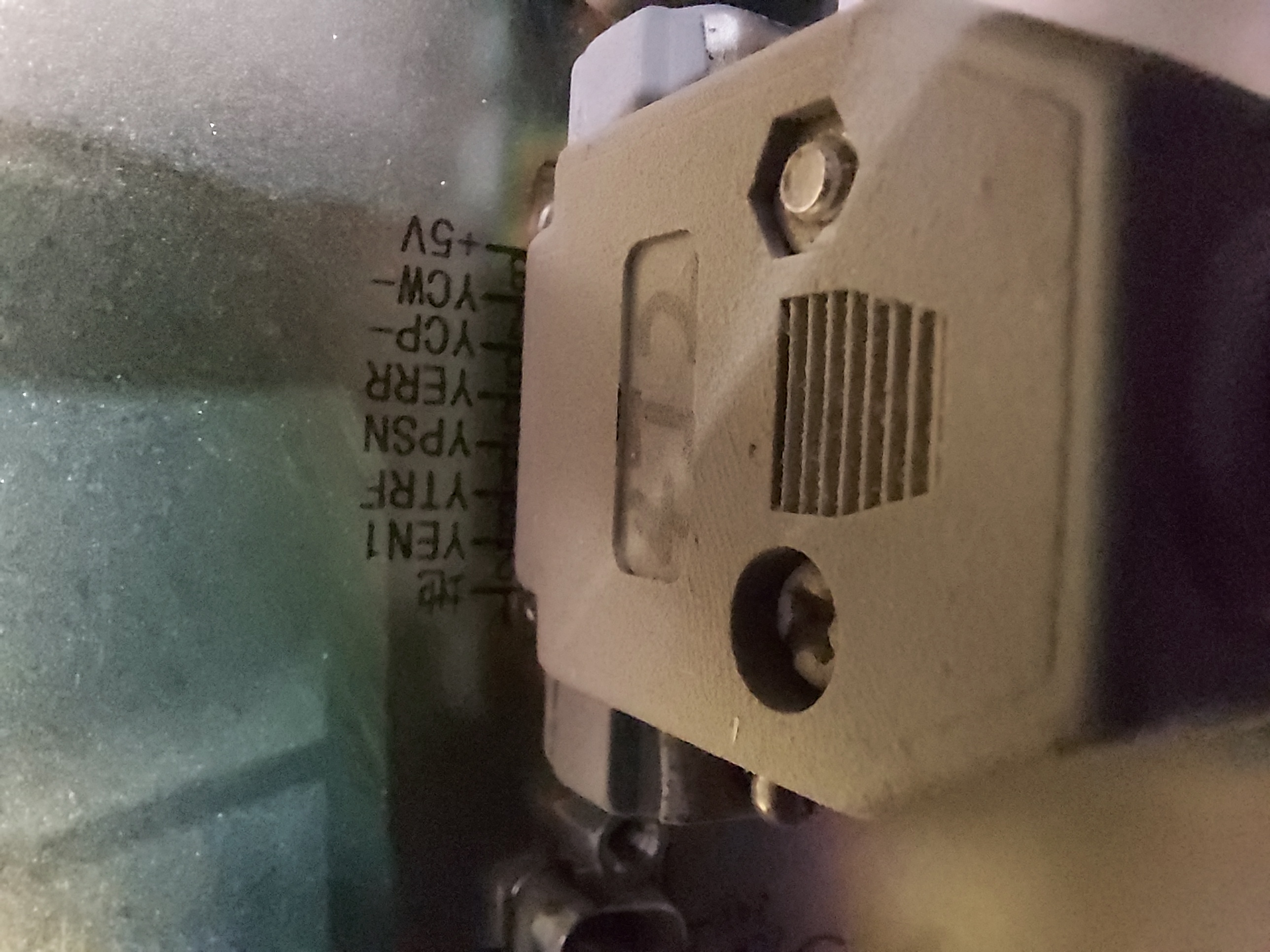

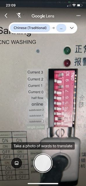

Here are some pictures, the connecter that has y** labeled on all the pins has an identical one next to it starting with x. The motor in this photo is the z axis, the other two are inside the machinery and hard to get access to to get a photo. I have done a quickish google on the stepper drivers and while i can find many to purchase i could not find a manual or anything, i will have a better look today,

I did some translating, the connection to the control baord that has the dozen ish blue wires has ground on the top 2 from the left and an end stop on the next pin, i didnt bother translating the bottom yet as i now know its endstops, as for the driver here is what i got
Table on the right is current
Table on the left is steps per rotation
Connector
脱机 offline +
方向, direction - 出错 Error -
方向 direction + 出错 Error +
脉冲 Pulse - 脱机Offline -
脉冲 pulse +
Text on the right
三相混合式 步进电机驱动器
Three Phase Hybrid Stepper Motor Driver
Connector
脱机 offline +
脉冲 pulse +
Text on the right
三相混合式 步进电机驱动器
