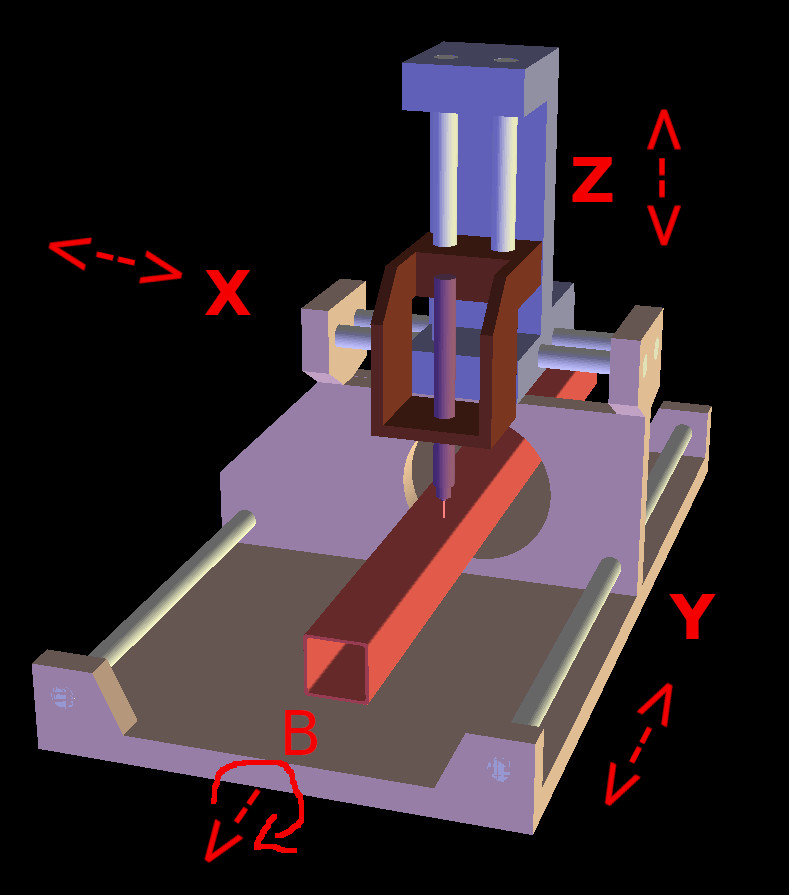

21 Mar 2023 19:50 #267249
by rbobey1989
Replied by rbobey1989 on topic Square and Rectangular Plasma Tube
Hello, I have had some time again and I have spent some time creating a Vismach model of the plasma for a square tube, I have attached a photo of how I think it should be.
Rodw, you're talking about a normal XY machine, I can't understand you because in the video it can be seen that when the tube rotates, the X axis also rotates just when the torch reaches where the radius begins in the corner of the tube, in the case of dispensing with the X axis and leave everything to the Z axis height control (THC) like a plasma for a cylindrical tube we would have angles from the beginning of the rotation, which is very bad.
I see the thing more as a xyzb-trt configuration, only in the corner because otherwise the faces would be like an xyz configuration, I imagine a change from the gcode between both configurations, I just think I don't even know if this configuration exists.
I think I would need some help with the kinematics if I had to develop it, although I don't know if I could use the trivkins module directly.

21 Mar 2023 22:39 #267256
Replied by rodw on topic Square and Rectangular Plasma Tube
Lets called this a wrapped rotary. That means the tube is flattened around its circumference. Google coping calculator to see a crude example where a piece od paper is actually wrapped around the tube and the cut line is traced onto the tube. You can achieve this in CAD by applying a narrow slit to the tube, converting to sheet metal and flattening the part.
So then in your example, X is the circumference of the tube and there is no B axis
There is no need to worry about the Z as it should be under THC control provided it can accelerate fast enough to keep up with a square tube as it lifts going around the corners
