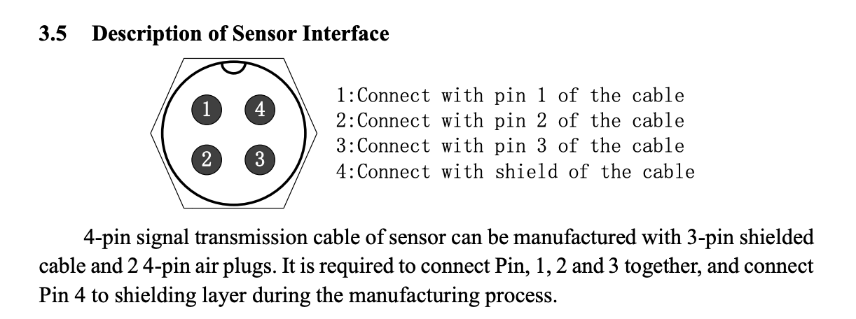

Here is an image of the interface I an interested in. That attached picture shows pin 4 as the cable ground. Even knowing which pin was the supply voltage and if that was +24V would be very helpful.

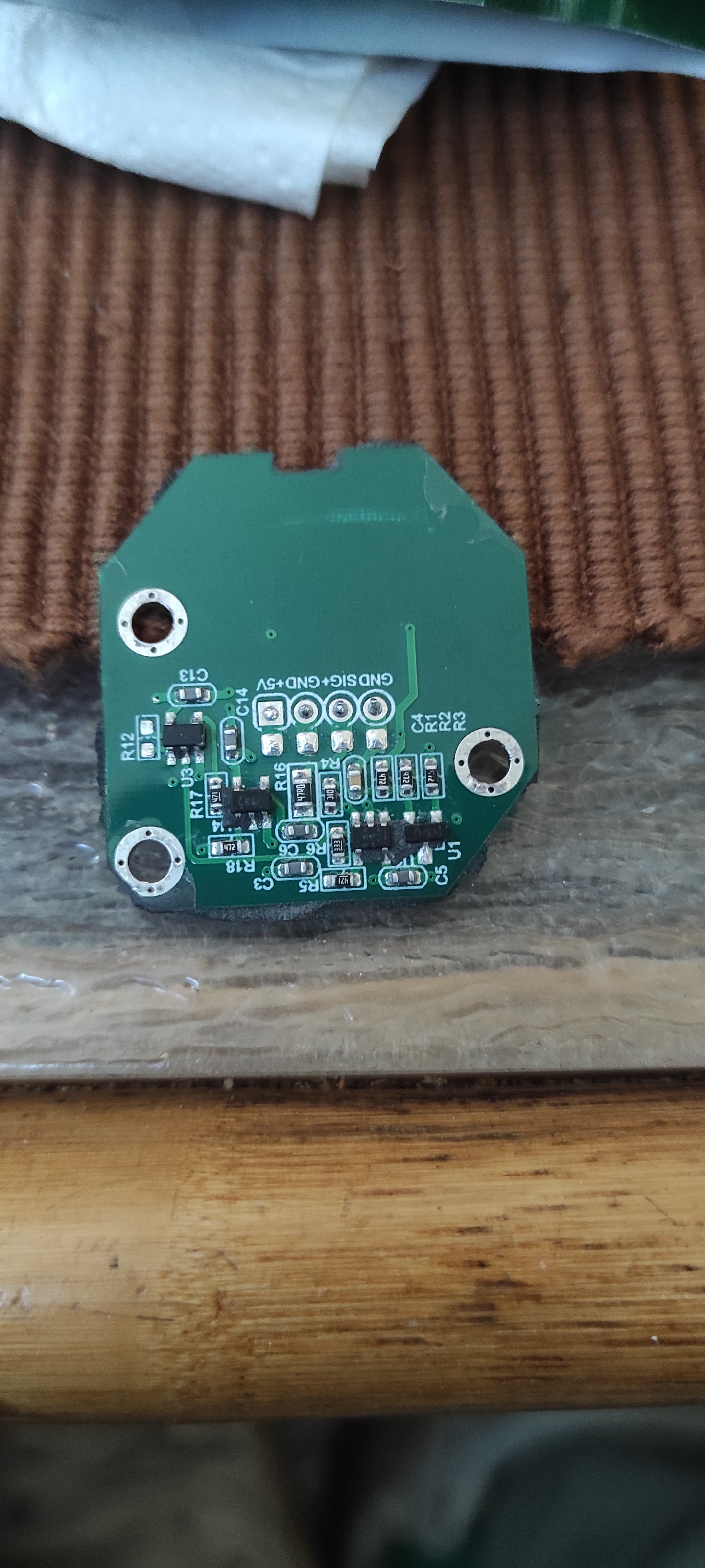

I've also attached a picture of the amp itself.
Thanks!

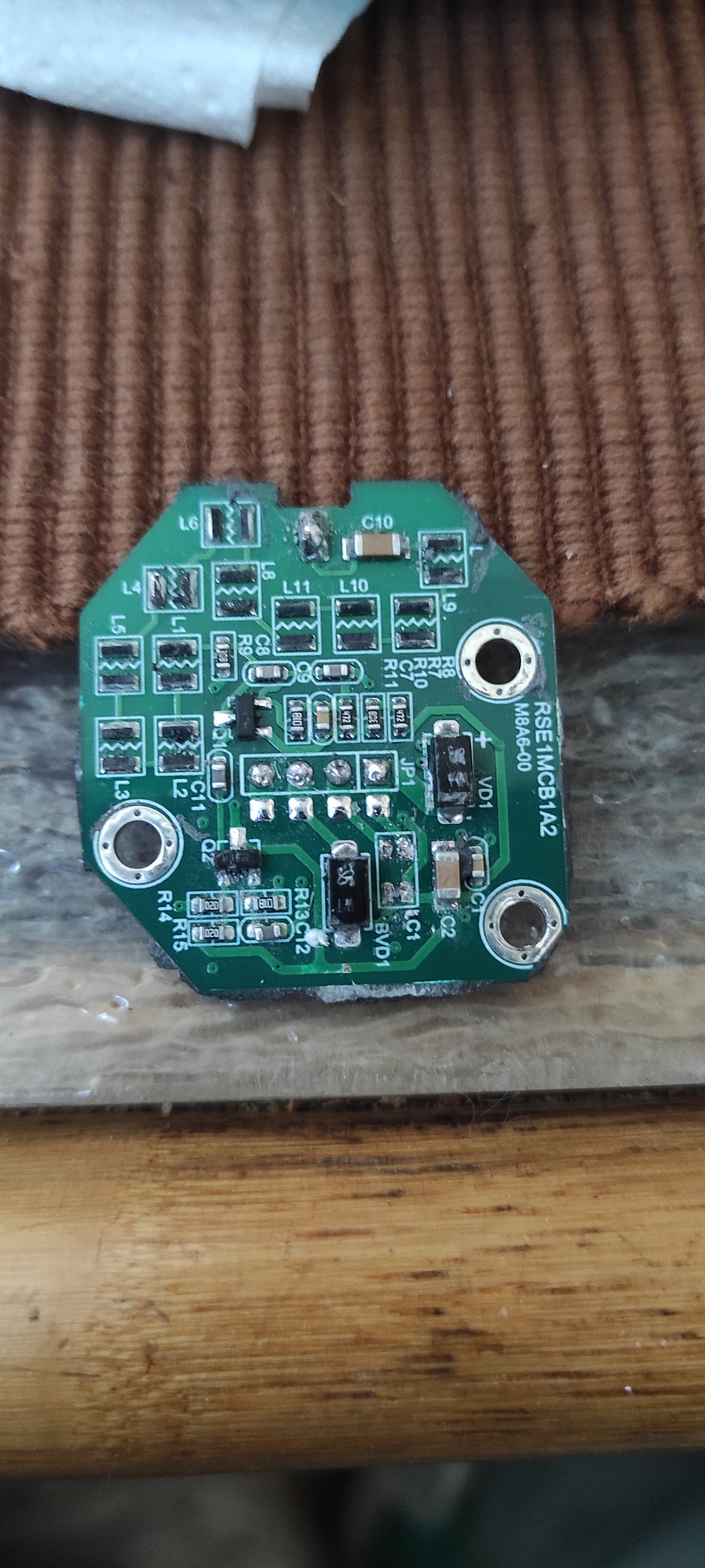

bcl-amp internal. mine is weihong but the same thing i guess

02 Feb 2024 01:42 #292180
by shasse
Replied by shasse on topic Using a BCS100 controller for a fiber laser or the BCL-AMP?
We finally got this working: forum.linuxcnc.org/plasma-laser/51568-in...e-sensor-to-linuxcnc
