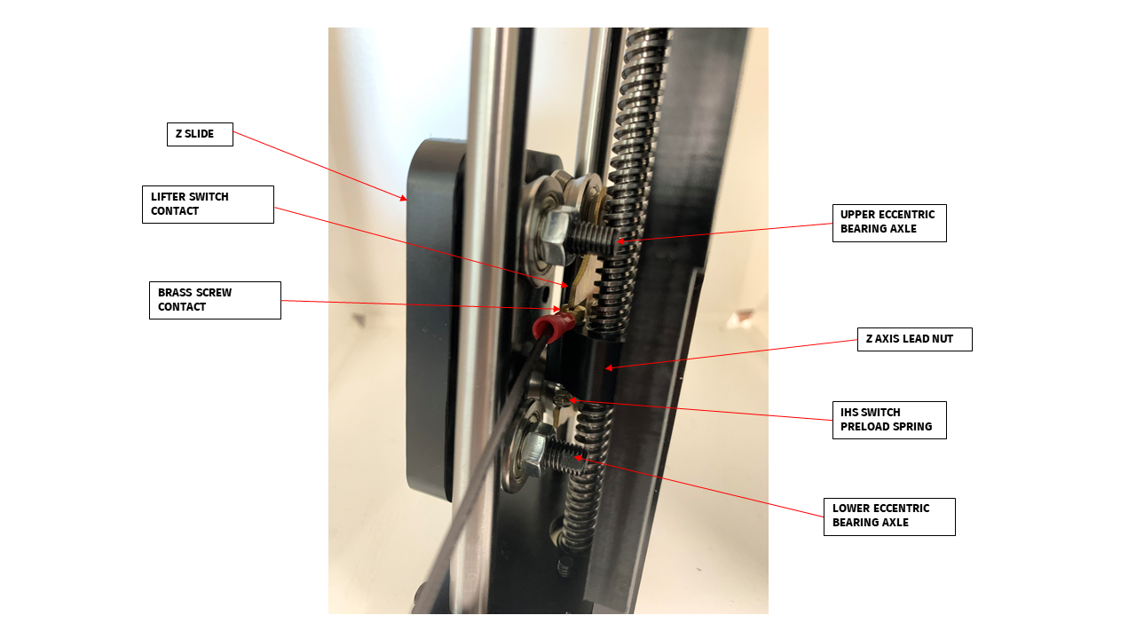

quick question for @tommylight.  how do you handle your touch off on the z?  i was thinking of using a spring loaded switch on some simple rails using the torch head as the probe, but is that overkill?  or is there a better way of getting material height?

Just went over my topic on building 2+2+3 plasma machines, i was sure i posted pictures of new Z axis insides, i did not! Shame on me! :(
Here is the old versions
www.forum.linuxcnc.org/show-your-stuff/3...uild?start=40#166228
I will try to make some time to disassemble one of the new ones and take some pictures... do remind me if i forget.

so i am assuming that the sensor there is your z max.  how are you setting your torch height?  and that is a very clean design btw.  that 17 has enough torque to lift that entire head?  langmuir has an interesting way of doing it, and i was thinking maybe something along these lines
