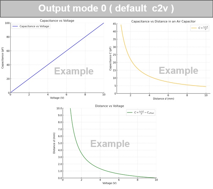

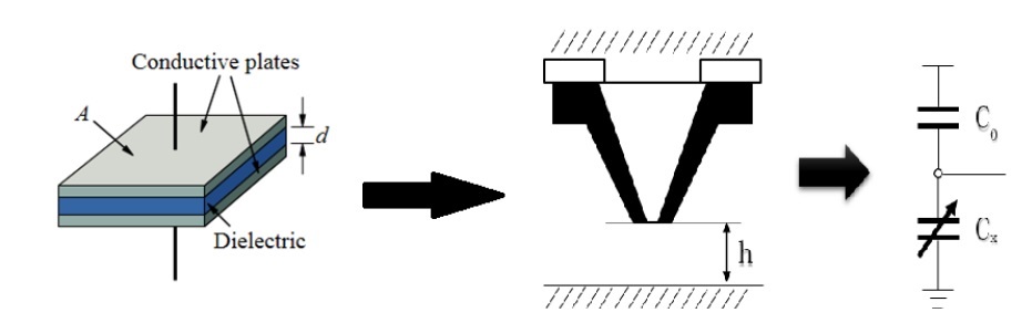

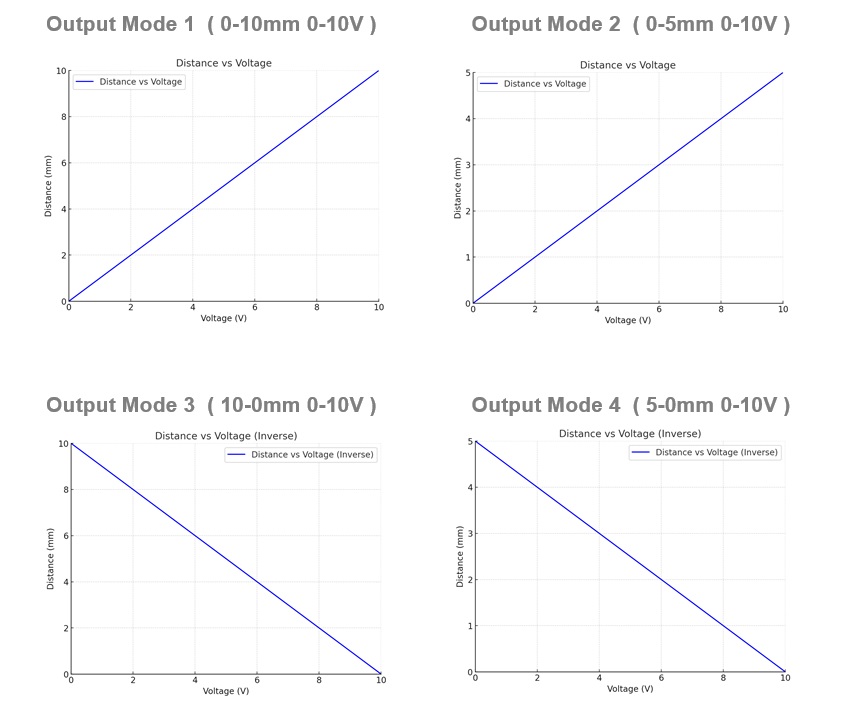

I am currently designing an advanced capacitive sensor.
I'm developing it for my own needs (for my controllers), but I've received numerous inquiries from people using Linux CNC about whether it could be applied there.
Unfortunately, I have no experience with LinuxCNC, but I don't think there should be any problem in using it for this purpose.
I'm at a stage where I can still make changes and improvements if needed.Initial tests have been outstanding, with a response time of less than 2ms.
The 0-10V output signal can be proportional to the calibrated capacitance or directly related to the measured distance (e.g., 0-10mm or 0-5mm).
Can be use like standard THC for PLASMA
If anyone here is knowledgeable about this and would like to use it with LinuxCNC, I'd be happy to collaborate (Beta Tester).
The condition for collaboration is an open thread on a forum with honest opinions, including updates on progress (or failures and setbacks).
I am open to criticism.

I'd be willing to test this out and provide some data. I currently use the BCL-AMP setup with QTPlasmac and while it works, it could definitely be faster in its tracking. The sensor outputs the nonlinear signal which is also noisy. After filtering (hardware and software), it works, however I feel as though it is not sensitive enough now due to being averaged and filtered so much that any abrupt changes in height will cause the nozzle to touch.
A cleaner, linear response signal could be the ticket, as I have fiddled with the PID parameters quite a bit as well as my Z axis velocities and accelerations and it is still not really where I'd like it to be.
Let me know how I can be of help.
Have you considered linearizing the output (with lincurve) before feeding the linearized distance to the
PID loop?
PID loop?
