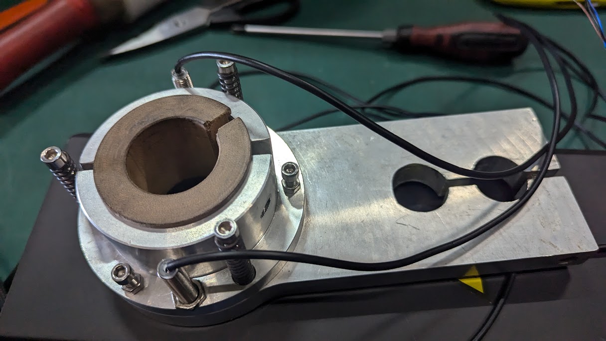

As an alternative view point, a stepper driven torch lifter with float switch and breakaway costs about $500. I just shipped a 72 kg QTplasmac controller package today, and we are replacing a motor driven torch lifter. He is also getting a 433 mhz wireless pendant. The client is really excited about the addidtional safety features he will get like breakaway, probe pausing motion if triggered by cutting and moving from DM542 drivers on 24 volts to Lam Technologies DS1076 drivers with 60 volt AC power, high quality Moon's motors with custom made 5:1 planetary gearboxes will lift this old slug into orbit!
Here is the lifter (200mm travel)

Well, I guess I’m stuck and didn’t explain my issue.
I set up a config in axis. X and y axis move appropriately when jogged, and the dro displays accordingly.
My 4 limit/home switches trigger in halshow. The limits will trigger machine power button.
My 2 inputs trigger digital inputs in halshow.
My 2 outputs get triggered when commanded in halshow.
And I don’t know where to go from here. I’m stuck. If I bought a new lifter, I’d be stuck in the same spot.
I obviously need to link the I/o’s to functions/buttons/gcode, but I don’t know how.
Im reading the manual and trying sample axis configurations, but I just can’t get anywhere.
Like input 1 is the breakaway. But I can’t figure out how to tell that to linuxcnc.
I thought maybe I can just copy the limit switches, but I don’t even see how they trigger the machine off button in any of the hal or ini files.
And if I can’t figure out the breakaway, I don’t have much hope for cycle start or thc hold.
Is it rude to ask for a plasma specific axis configuration?
I appreciate the input, I just wish knew enough to ask the right questions.
Rodc, I assumed you suggested the lifter for functionality, but maybe you’re actually telling me to use a lifter that integrates with qtplasmac. I did consider using Linuxcnc to control the z motor and read arc volts with a mesa thcad instead of the standalone hypertherm phc control, but I thought that just sounded like more work, more money, and more potential pit falls. But in retrospect maybe I should’ve done that just to make it easy to use qtplasmac. And a mesa card that works with pncconf instead of mesact
