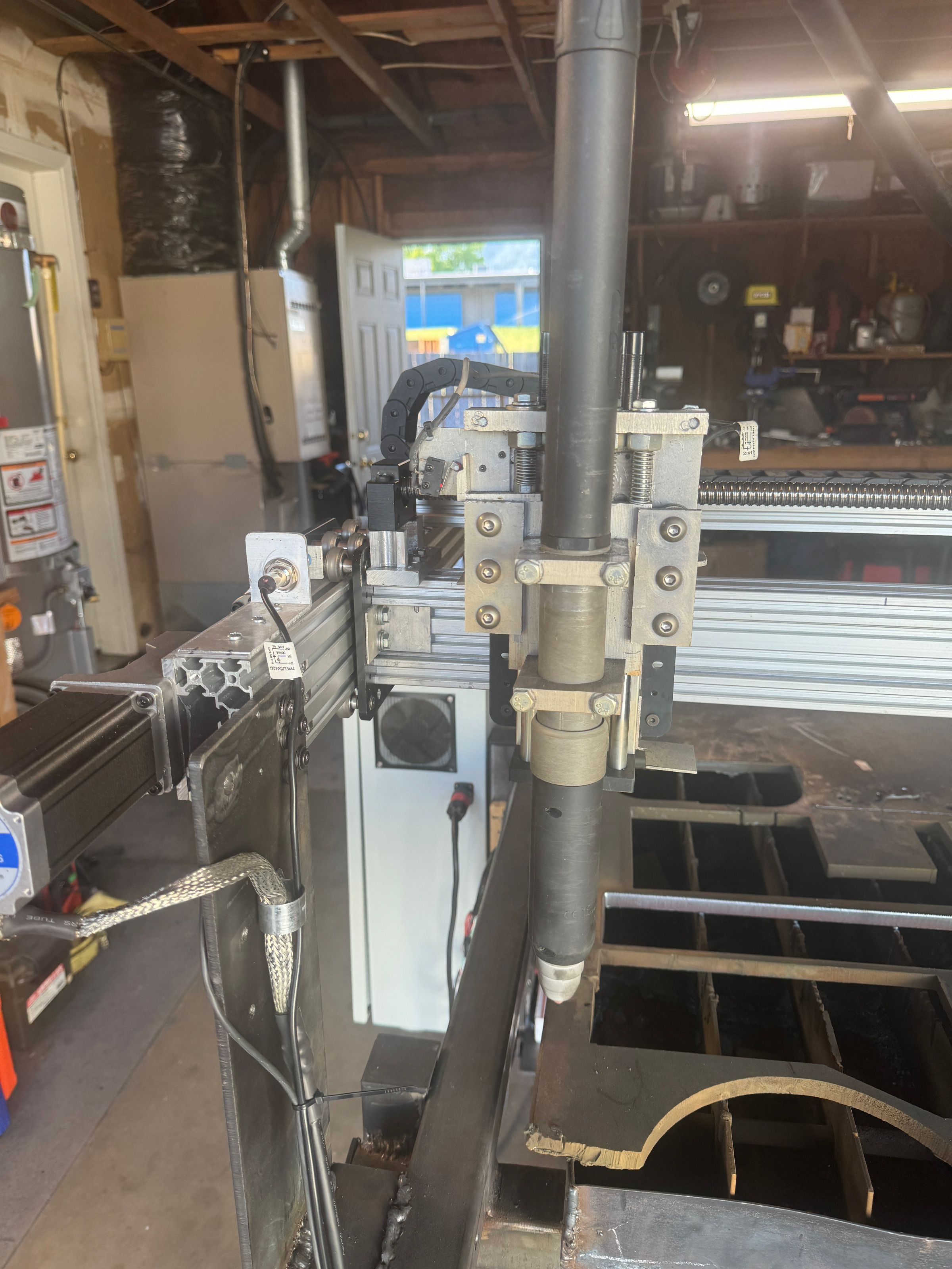

I'm stumped -- I just cannot get my probe to work correctly.
Attached is my config archive for review.
My system is a Dell Optiplex 7040 Core-i7, 32 gb RAM, 512 gb SSD, 2 tb hard drive
MosChip PCI 9865 Parallel Card (0xd010) Port 0 Configured As Output
Asix Electronics Corporation AX99100 PCIe Parallel Card (0xb010) Port 1, Configured As Input
Debian Linux 12.7 (Bookworm), Cinnamon Version, Kernel 6.9.7+bpo-rt-amd64
LinuxCNC v2.9.3 compiled from source to DEB then installed through Synaptic.
The table is a DIY using steppers, a SainSmart controller card / breakout board on Port 0, and a bare breakout board with pull-down resistors on Port 1 pins 2-9 for inputs from my proximity limit switches; each axis has a home-min switch and a max switch (8 switches total).
The table homes perfectly. When I do a probe test right after homing, it works like expected -- dropping to probe height, slowing to contact, stopping for a few seconds, then rising to pierce height until the timer expires. When I move to a work coordinate position, the probe test again works perfectly.
Unfortunately, that all blows up when I attempt to run a G-Code program (example below). As you can see in the attached video, the torch drops, makes contact, then immediately rises to safe height -- the program pauses with the error "pierce height would exceed Z axis maximum limit".
I have tried all sorts of values, but nothing seems to do any good; I don't see anything in the program that would cause it.
Perhaps one of our "resident Guru's" can give me some insight into this & help me get it to probe properly?

Picture Of Z-Axis:
YouTube Video of Z-Axis Motion During G-Code Program: youtube.com/shorts/k12akteEZmI?feature=share

My guess is it might be the lack of debouncing on critical inputs.
The dbounce components are loaded but the raw parallel port signals
are routed to Plasmac and the dbounce component inputs, but the signal
paths should be:
parallel port pin --> dbouncex.in --> dbouncex.out --> Plasmac
That is you have for example:
net plasmac:float-switch <= parport.0.pin-12-in-not
net plasmac:float-switch => db_float.in
when it should be something like:
net raw-float-switch <= parport.0.pin-12-in-not
net raw-float-switch => db_float.in
net plasmac:float-switch => db_float.out
or the equivalent:
net raw-float-switch <= parport.0.pin-12-in-not => db_float.in
also the debounce times were not set (so would default to 5 servo-thread periods so 5 ms)

We kinda do things in a convoluted way, the dbounce component pins are connected by qtplasmac_comp.hal which is in hallib.
qtplasma_comp.hal:
The times should be set in custom.hal but for some reason in this config they are in custom.hal.new_values and probably should be copied to custom .hal for convenience.
custom.hal:
qtplasma_comp.hal:
Warning: Spoiler!

OK did not see that hal file (and grep'ed for the db.out pins and did not find them in the supplied hal files)
back to square one I guess...

by phillc54
Replied by phillc54 on topic Inconsistent Probe Performance...
Try changing the line below this in your hal file:
from:
to:
# ---JOINT ASSOCIATED WITH THE Z AXIS---from:
net plasmac:axis-position joint.2.pos-fb => plasmac.axis-z-positionto:
net plasmac:axis-position joint.3.pos-fb => plasmac.axis-z-position
Last edit: 10 Oct 2024 04:10 by phillc54.

When I created that machine config in StepConf, it did not insert a [JOINT_2] block in the [AXIS_Y] block -- I had to manually copy & paste the [JOINT_1] block to add a [JOINT_2] block. I didn't notice that it had linked the Z axis to [JOINT_2] over in the .HAL file.
I'll give that a try in the morning, but that's probably the problem. Thanks a bunch!!

Ahhh... I never noticed that, but it makes sense.Try changing the line below this in your hal file:
[/code][/code]# ---JOINT ASSOCIATED WITH THE Z AXIS--- from: [code]net plasmac:axis-position joint.2.pos-fb => plasmac.axis-z-position to: [code]net plasmac:axis-position joint.3.pos-fb => plasmac.axis-z-position
Last edit: 10 Oct 2024 07:04 by cnctrucker. Reason: Fixed formatting

by cnctrucker
I'm using proximity switches, so there is no appreciable bounce. With the exception of the line you pointed out, this is the same HAL code I have used in several iterations of this machine -- and I've never had a problem with a lack of debouncing before.
I'm sure that the wrong joint assignment is the problem -- I'll know in the morning for sure, but the previous iteration of the machine worked just fine before I added the THCAD-2 to the machine.
Replied by cnctrucker on topic Inconsistent Probe Performance...
paths should be:
or the equivalent:

by cnctrucker
I couldn't wait -- I went out to the shop & made the change tonight.
Problem solved -- it ran the whole G-Code program just like it should (no plasma though). I'll try the actual cut tomorrow, but I'm confident that the issue is solved now.
Again, many thanks!!!

by cnctrucker
Replied by cnctrucker on topic -- SOLVED -- Inconsistent Probe Performance...
ISSUE SOLVED NOW -- PROBING WORKS JUST AS IT SHOULD.
