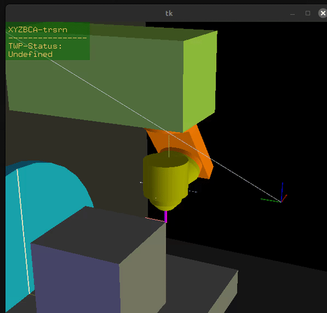

Is there something I can do in Linuxcnc to have it "automatically" compensate for the angled offset?

Replied by Aciera on topic Compensating For Angled Cut
