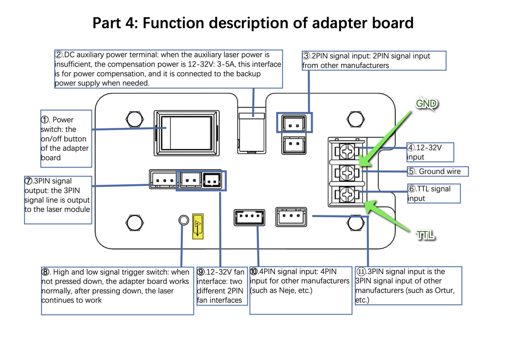

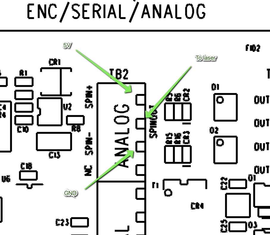

just to make sure I understood that correctly.
I have a 7i96s and want to connect a laser module which uses a TTL signal to control it. When I connect it like shown below, the M67 command will control the intensity, right? Or do I need to configure something to make that work?
Thanks!

04 Jan 2025 13:45 #318061 by tommylight
Replied by tommylight on topic connecting to laser TTL
No, analog output does not work for TTL inputs:
analog output = changing voltage from 0 to 5V
PWM = Pulse Width Modulation = pulses with changing duration, so 0 or +5V
The correct way would be to flash PWM firmware to Mesa 7i96S included in the downloads from Mesa website (specification tab on the 7i96S page), this will replace the 5'th stepgen with PWM.
If you do need all 5 stepgens, then a cheap BOB connected to Mesa IDC26 header will also work, but i do not know if that also needs flashing or can be used with software PWM.

Well, I know what TTL & PWM means. The problem is, that TTL (in this context) only means 5V while PWM is just pulses with no indication to voltage or frequency.
The manual of the Atomstack M100 just says 5V TTL. I googled, but did not find any good indication if they meant 5V analog or PWM. Usually (YMMV) more devices work with analog than PWM, so I went that road.
If, from your experience, TTL in this context means PWM, I'll happily take that advice. If you remember, you explained to me yesterday how to flash the second PWM output. So this has already been done.
I'll look up in the manual how that needs to be wired and post it here.

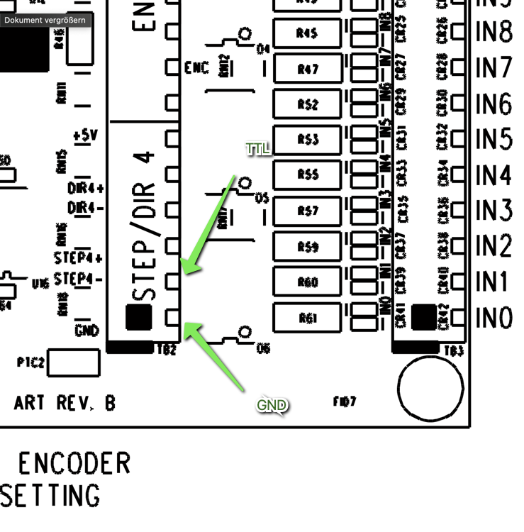

04 Jan 2025 17:35 #318108 by poesel
Replied by poesel on topic connecting to laser TTL
Ok, so I have flashed the card with 7i96s_2pwmd which changes STEP4 to a PWM output. Then connect the STEP4- output on the mesa card with TTL on the laser controller and the same with GND on both sides.
HAL config as per this discussion:
forum.linuxcnc.org/27-driver-boards/5480...and-wiring-for-laser
That correct? Thanks.
08 Jun 2025 14:11 #329949 by poesel
Yes, this is correct, well done!
