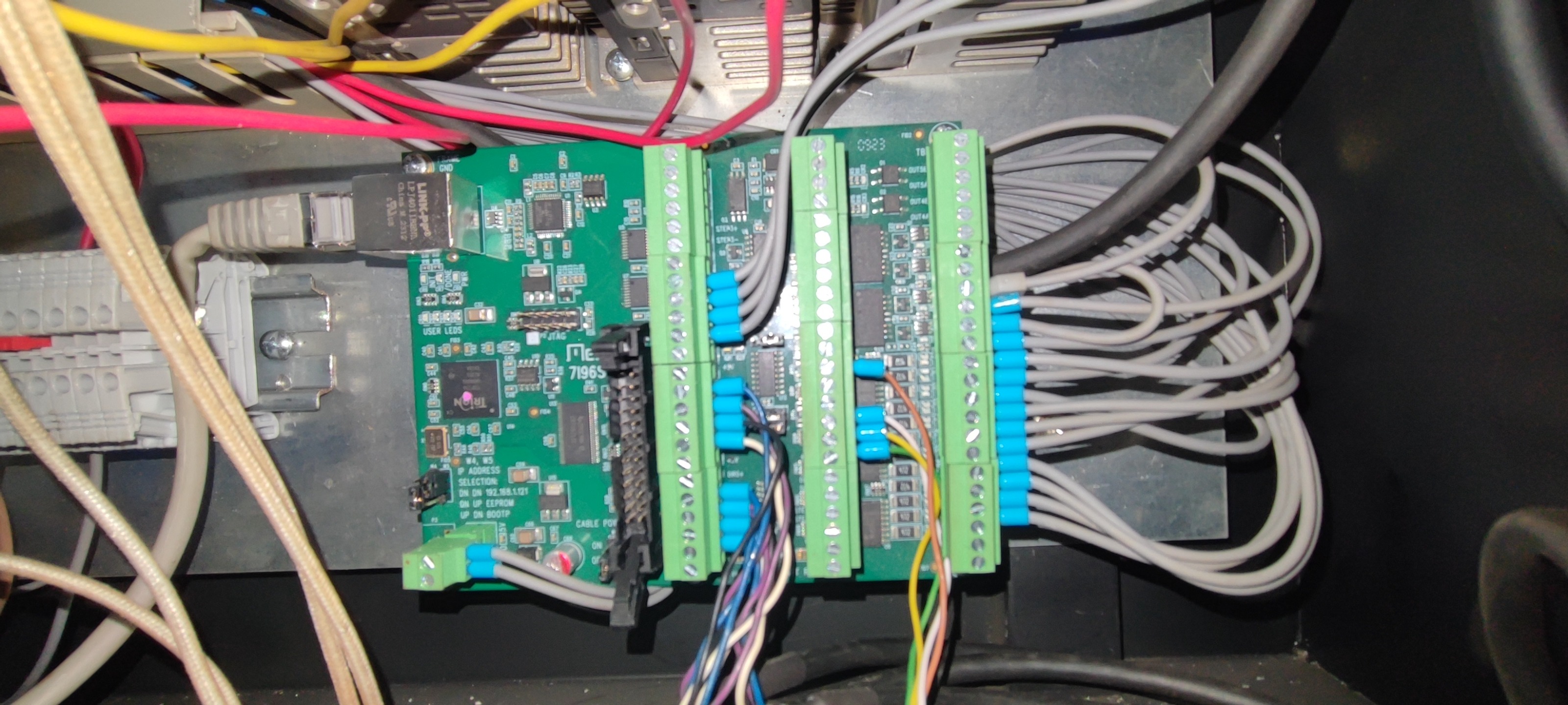

The THCAD is mounted inside of the plasma source near the control board.
I'm making the recommended change for a plastic box outside of the plasma source.
This is the first Thermal Dynamics equipment that I work.
I've worked with several Hyperthem plasma cutting systems. All of those got an THCAD inside working well.
The THCAD boards seems to be fine. I have to check the encoder inputs from 7i96s but appears to be usable.
I am making that change to the future plasma systems to guarantee the best care for the boards.
When I have the chance I will make the changes and update you.

So I was able to double check for short/faulty cables on P1. I've disconnect the encoder connector from 7i96s and no contact to GND.
Made the change of the location of the THCAD board to the outside of the plasma source in a plastic box.
Connected the shield only on the 7i96s side in the pin TB2.9 with the GND cable.
When I turn on QTPlasmaC the value of Arc Voltage is 145.
The encoder velocity pin seems to be working fine on halshow.
What you recommend to do?
Thanks in advance, really don't understand what's happening.

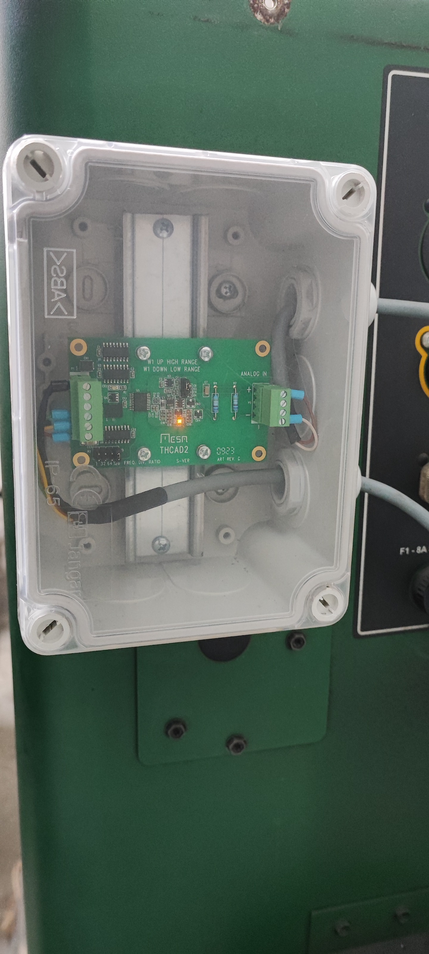

16 Jan 2025 09:23 #319103
by sharp_reaper
SOS UPDATE:
Changed the THC to THCAD2 and change for a divided arc
Put the THCAD2 outside the plasma source in a plastic box.
Shielded only on THCAD2, in new cables.
Made the changes that you recommend:
Results:
This worked a week, but it happens again. The arc voltage is on -45.
I can take more pictures, make video. If anyone can help.
Replied by sharp_reaper on topic 7i96s Arc Voltage + Encoder Fault
I'm using the calculator from the PNCconf.If you read the QTplasmac docs, there is a link to a calculator to determine your settings.
SOS UPDATE:
Results:

16 Jan 2025 11:10 #319109
Replied by rodw on topic 7i96s Arc Voltage + Encoder Fault
Now you have a THCAD 2 you can do more tests.
But normally, you would set the THCAD to use 1/32 frequency. This would alter your offsets etc accordingly. Make that change
Assuming a 10 volt range, apply a 9 volt battery to the THCAD HV input. The flashing light should change frequency. Does it?
the voltage should be about 90% of your full volt range. Is it?
What are the calibration frequencies for your THCAD on the sticker?
Read the encoder velocity at 0 volt at rest and at 9 volts.
What are these readings?

16 Jan 2025 14:22 #319125
by sharp_reaper
Thank you Rod for your advice.
I'm testing when I have the chance. I can put the 1/32 divider frequency. I'm used to THCAD300 and always put on 1/128.
The sticker value for my THCAD2 is: FSV - 899.4 kHz | 0V - 96.8 kHz
The initial value for the offset was about 700 but I've noticed that when the Power Source is Down (No Power) the arc voltage is 0V. When I turn On the arc voltage goes to 12V.
Checked the encoder velocity pin with the value of 900. Put 900 in the offset. Arc voltage has 0V and got decent results.
Made some tests today. When I make the first pierce the arc voltage, in the first moments turn in -73 and then goes back to normal value.
After that the pierces (should be a higher value than the Cut Volts on material) seems normal to me.
Talked with the supplier of the plasma source and he refers HF equipment and to check the grounding. Reinforced the grounding connections which has a good grounding less than 0.3 Ohm.
