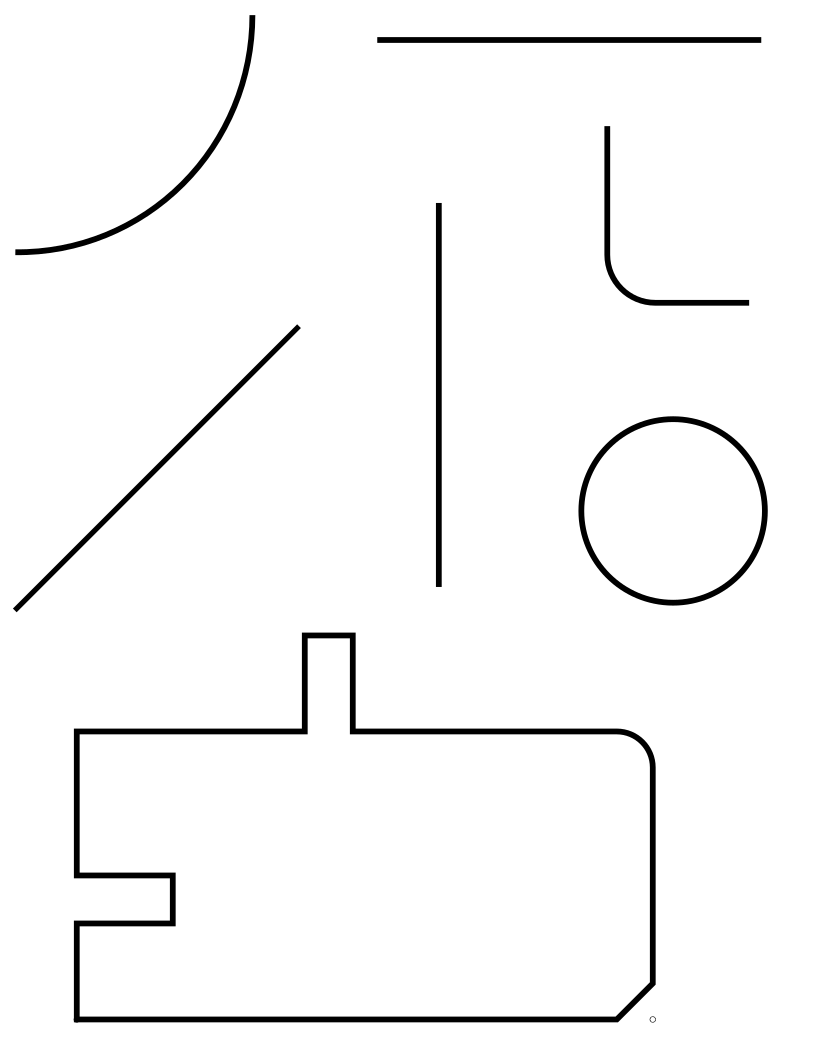

I have been working on a small LinuxCNC companion project called **FabScan**. The basic idea is to create a LinuxCNC-friendly camera tracing utility that can help capture outlines, edges, holes, and reference points from real-world parts, then export usable DXF geometry for cleanup/CAM.
The project was inspired by the general workflow of SheetCam Scanything, to be clear it is not based on Scanything code, reverse engineering, or proprietary information. It is a from-scratch MIT open-source project aimed at LinuxCNC users.
The project can be found here: github.com/FabLabRacing/FabScan
The documentation is lacking at this point, it is mostly build notes.
The intended workflow is:
1. Mount a USB camera on the Z-Axis.
2. Use LinuxCNC for the actual machine position reference.
3. Use FabScan to view the camera, detect edges/lines, capture points, and build geometry.
4. Export DXF.
5. Use SheetCam or another CAM program for cleanup, tooling, and cutting.
## Current Status
The current working milestone is around **v0.5.10**.
At this point, FabScan can:
* Load an image and detect contours.
* Adjust threshold, blur, minimum area, and simplify settings.
* Select/classify/sort detected contours.
* Export DXF geometry.
* Capture from a USB camera.
* Rotate/flip camera view as needed.
* Calibrate camera scale.
* Capture manual points from LinuxCNC position.
* Continue native DXF geometry using lines, arcs, and circles.
* Perform controlled X/Y motion through LinuxCNC.
* Jog X/Y from inside the app when enabled.
* Use camera center-dot calibration.
* Preview line/edge detection from the live camera.
* Take single-step and multi-step line/edge following moves.
* Export traced/captured geometry to DXF.
The newest work has been focused on camera robustness and line/edge following.
The line-following proof of concept is working well enough to be useful in testing. One important recent improvement was latching the follow direction during multi-step tracing. Before that, the detected edge tangent could occasionally flip direction and cause the machine to step backward. The current logic uses the selected Forward/Reverse direction for the first move, then chooses the next tangent direction closest to the previous successful move. In testing, this fixed the forward/backward flip.
A recent test captured 50 points along a Sharpie line without the direction flipping. The average step was about 0.050", with the largest observed deviation roughly in the .006"-.009" range. That was with the line slightly out of square with machine travel, so I was pretty happy with the result for an early proof of concept.

The idea/plan is to trace an object (existing part) or a drawing and capture that as a DXF. I don’t have a video of it running but I do have an example from a test run. The image file is what I traced with my machine & the DXF is the result of that trace, there are some issues right now as you can see in the DXF.. The app got "lost" on the smaller radius corner and circle and just started moving back & forth, but the bigger radius and straight line test weren't to bad. I haven’t tried to trace the bottom shape yet, the app isnt ready for that one yet

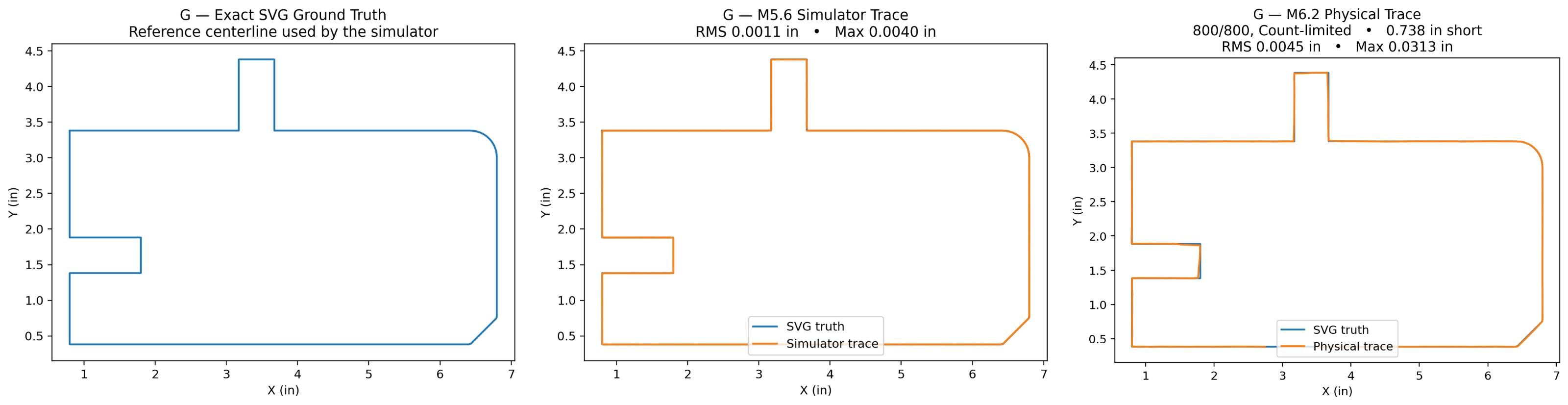

I have made a few updates to the code & I feel like I hit a pretty big milestone, I was able to get a full circle trace (for the first time) I set the software to use "to many" move points so I got an overrun of ~77 deg but for a camera-followed trace on a printed line, this seems pretty respectable. Especially because this is not post-processed yet — this is raw captured polyline.
This is the raw data:
Points: 250
Average segment: 0.02922"
Total trace length: 7.276"
Fitted radius: ~0.9501"
Radial RMS error: ~0.0108"
Radial p2p error: ~0.0495"
Angular coverage: ~436.9°
The overlap:
First full-lap return point: ~0.0167" from start
Overrun overlap average: ~0.0114"
Worst overrun overlap: ~0.0179"

That led to an SVG ground-truth simulator using the exact A-G test geometry.
The simulator runs the real FabScan perception, estimator, and planner against a virtual camera that can move wherever the planner chooses. It also includes measured camera appearance, observation delay, and the actual configured motion limits from my LinuxCNC table.
That has become one of the most useful development tools in the project.
## Latest Real-Machine Result
The current hardest test geometry is shape **G**, which contains straight sections, tabs, a 45-degree corner, a radius, and several sharp direction changes.
The latest physical run completed:
**800 / 800 planner steps with no HOLD**
It stopped only because Count was set to 800, about **0.738" short of completing the loop**.
Some comparison numbers:
M5.6 simulator full path: 21.5182"
M6.2 physical implied path: 21.5091"
Physical RMS error vs SVG: ~0.00446"
87.6% of path within: 0.005"
96.4% of path within: 0.010"
LinuxCNC itself followed the requested coordinated XY endpoints very closely, with an average endpoint miss of about **0.00045"**.
The remaining larger errors are concentrated around a few sharp vertices where the planner begins turning slightly early.
That is encouraging because the problem is becoming very specific rather than looking like general path instability.

I got to thinking, it might be helpful to see a comparison image, the image on the left is the actual image used for testing, the center is a trace using the simulator, and the right is an actual trace done on my machine.
