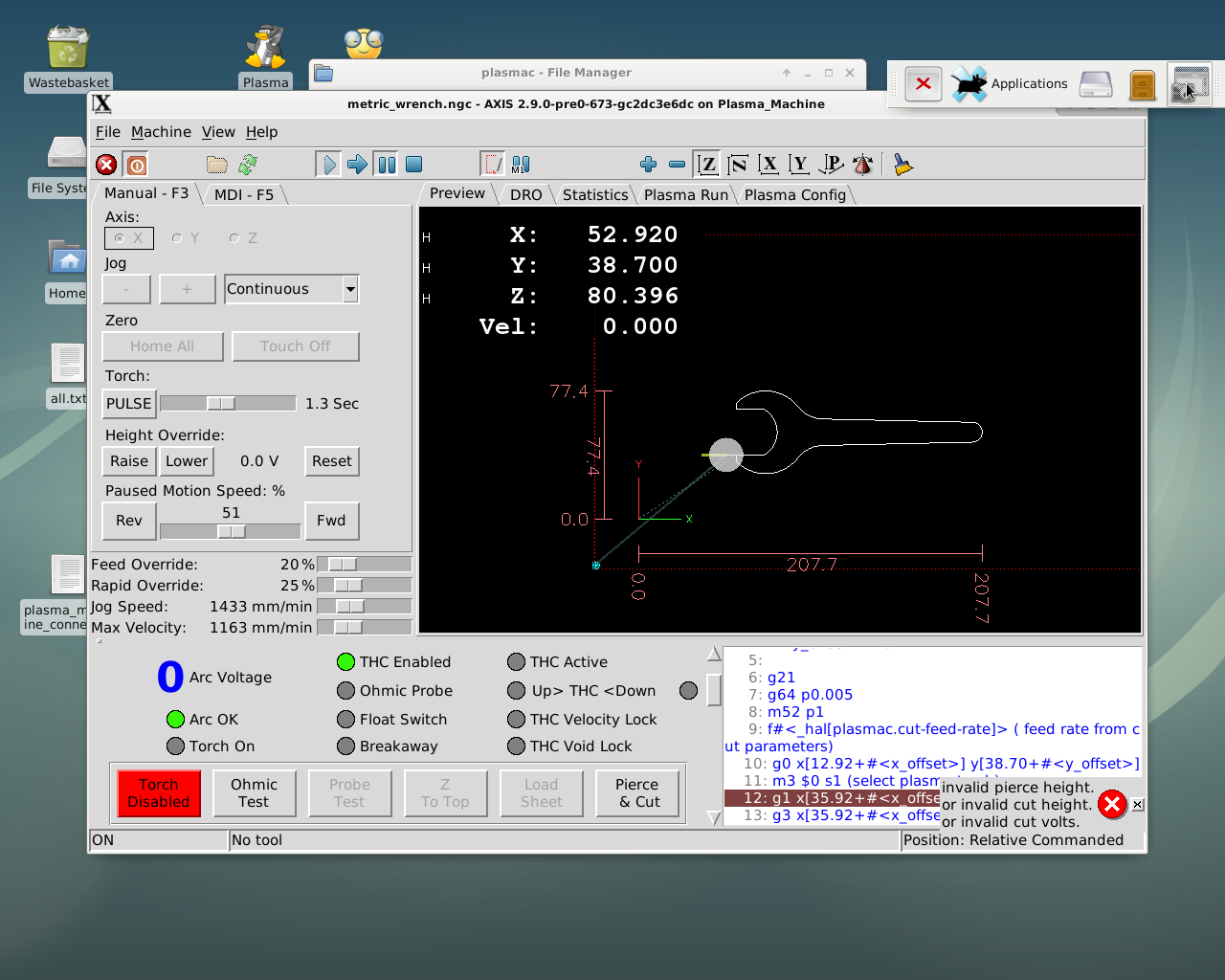

Phill Well spotted with the [RS274NGC] re the probing It was running so slow I could not see it I had to change the speed in the motion tab.
I seem to have a problem with torch on. Looking in Hallshow at torch_enable it triggers with the Torch-enable button but the torch on LED does not come on.
Also the Ark OK is on all the time.
I have tried putting M3 &0 S1 in the MDI and M3 S1

Arcok is on as the default is set to use auto volts, disable that in one of the config tabs, then it will be off untill voltage goes between min volt and max volt set on the other config tab.

It seems a lot of your problems were caused from the [TRAJ]LINEAR_UNITS = metric line in your original .ini file. "metric" is invalid, it should be "mm". linuxcnc.org/docs/devel/html/config/ini-...g.html#_traj_section
Torch Enable won't fire the torch, is only enables it to be be fired. It is basically to start your machine in a safe mode.
Torch Pulse will fire the torch if it is enabled.
You cannot fire the torch from MDI because the probing and move to pierce height sequence has not been completed.
As Tom said, you need to have the OK High Volts and OK Low Volts set correctly.
Last edit: 08 Oct 2019 01:49 by phillc54.
The following user(s) said Thank You: tommylight, Clive S

Is it possible to do a dry run without the the plasma cutter connected to check if the probing is working as expected at the moment it errors out.
I can now fire the torch on relay. but I don't have the slats in the table yet
08 Oct 2019 11:15 #147447 by phillc54
Replied by phillc54 on topic Problem loading PlasmaC for the first time
Yes, if you run while the torch is disabled it will do a dry run, which is everything except torch and THC.
That error message is saying one of the cut parameters in the Run Panel is invalid.

Success, at last have had it simulating cutting the spanner at 9mr/min with no errors.
Next job is to try and calibrate the the THC-10 not sure how to do this yet. I have tons on this but my brain exploded :silly:
I am using a cut40 scratch start cutter and wired the THC inputs to each terminal via a 1 meg R very close to the terminals.
The output from the THC via a cat5 to the 7i96 encoder.
I have tested the torch on with the cut40 connected to verify the torch firing via the pulse
Is this all correct?
