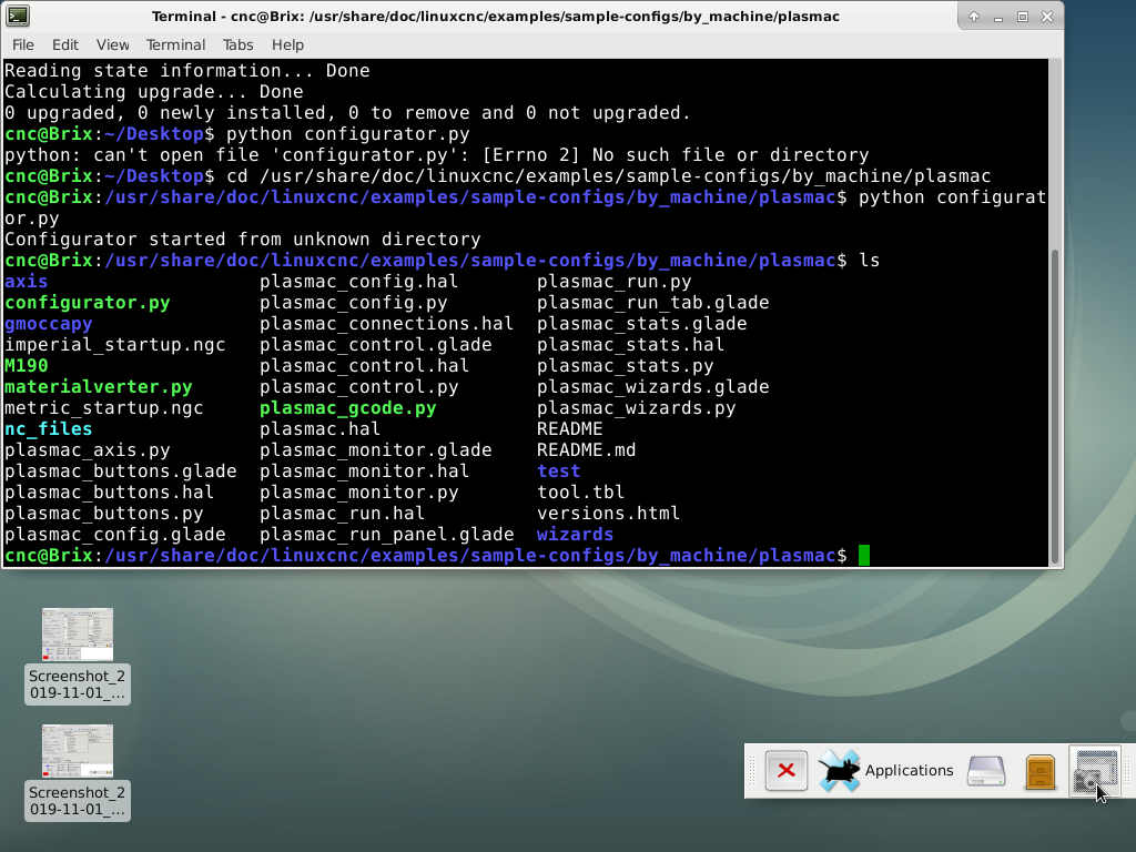

07 Dec 2019 15:05 #152258 by Clive S
Replied by Clive S on topic How to update plasmaC
Phill
I am having trouble updating . I have done:-
$ sudo apt-get update
$ sudo apt-get dist-upgrade

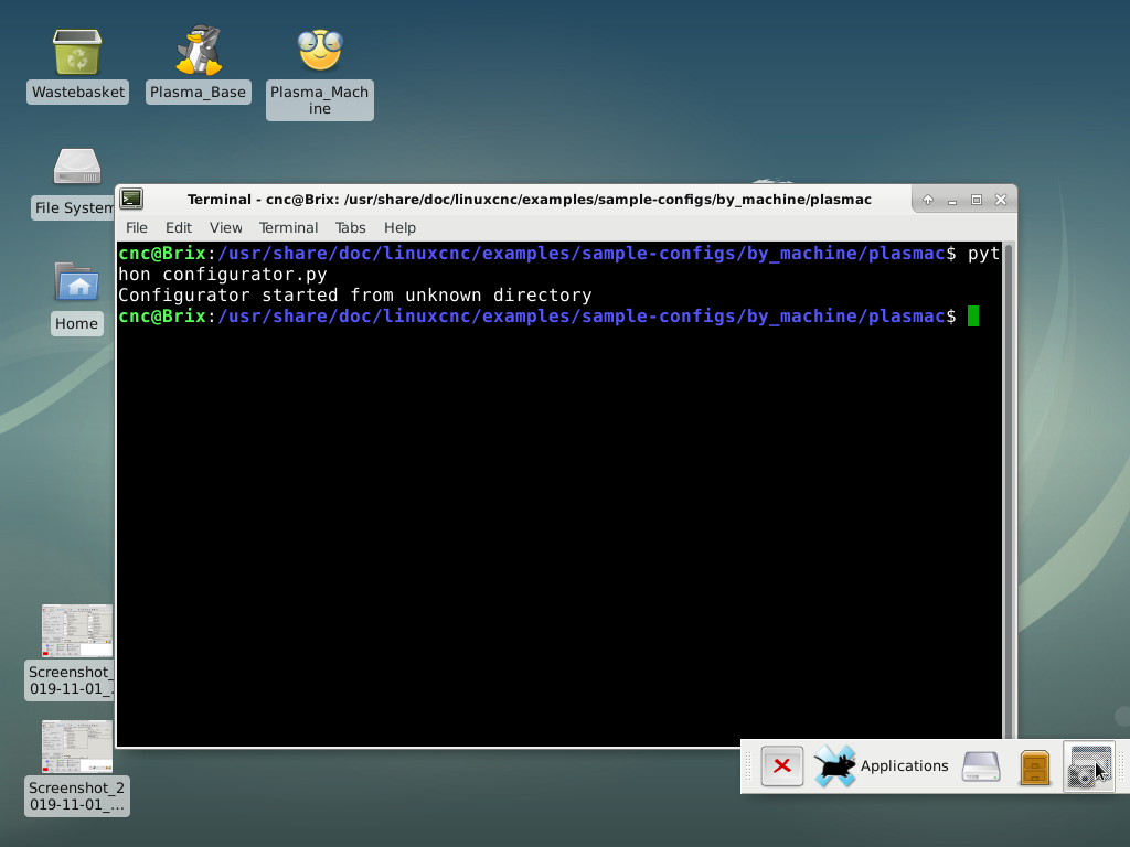

This ran OK and appeared to update. But I did not see the extra's tab (shapes etc) i

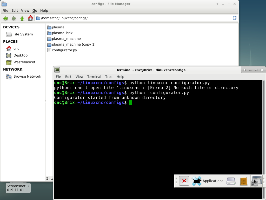

Then I tried;- $ python linuxcnc/<your_configuration_directory>/configurator.py
But I don't see the configurator.py in my linuxcnc config
Next I tried running the configurator.py from :- /usr/share
plasmac/confugurator.py ( see the configurator.py in plasmac ) but it errors
Should plasmac be running or stopped when upgrading? I also copied configurator.py to my config folder to no avail.

07 Dec 2019 20:36 #152286 by tommylight
Replied by tommylight on topic How to update plasmaC
Try
./configurator.py
from that same location.
