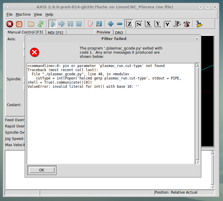

Error after PlasmaC Upgrade

09 Nov 2019 18:14 #149999
by EW_CNC
Error after PlasmaC Upgrade was created by EW_CNC

09 Nov 2019 22:08 - 09 Nov 2019 22:09 #150023
by phillc54
Replied by phillc54 on topic Error after PlasmaC Upgrade
Did you run the Configurator in upgrade mode?
Edit: If you have a Run In Place installation did you run make to rebuild it?

09 Nov 2019 22:41 #150027
by EW_CNC
Replied by EW_CNC on topic Error after PlasmaC Upgrade
I ran the configurator and selected upgrade. From a terminal:
$ python /usr/share/doc/linuxcnc/examples/sample-configs/by_machine/plasmac/configurator.py
From my understanding I do not have Run in Place, my linuxcnc file is user/linuxcnc/configs/. Am I correct?

10 Nov 2019 02:29 #150038
by phillc54
Run In Place means you did a git clone then built LinuxCNC, the other type is a package install from the BuildBot.
Both types have the same directory in the users home directory.
Could you post your .ini and .hal files please.

10 Nov 2019 02:56 #150040
by EW_CNC
Attached the files:

10 Nov 2019 04:16 #150041
by phillc54
Can you start LinuxCNC from a terminal and see if there are any errors as it is loading.
Sorry I am i bit slow responding but I am not getting any email notifications for some reason.

11 Nov 2019 15:26 #150126
by EW_CNC
I started from terminal and it gave the same response.
Attached terminal startup:

11 Nov 2019 22:03 #150158
by phillc54
For some reason it is not creating the plasmac_run.cut-type hal pin.
Could you open a terminal and get a directory list:and post the dir.txt file as well as a copy of plasmac_run.py from the above directory.
ls -al /home/eweaver/linuxcnc/configs/linuxcnc_plasma > dir.txtPlease Log in or Create an account to join the conversation.

11 Nov 2019 23:44 #150161
by phillc54
Can you load a GCode file after LinuxCNC loads without it giving that error?
