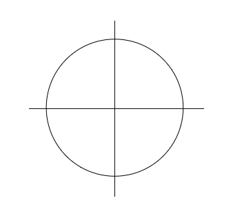

I saw this at parts i ordered from a laser cutting company a couple of years ago. The machine recognized automaticly holes that were too small for cutting and engraved instead the outline (circle) and two lines in x and y direction like a crosshair.
4) Automated recognition of holes and center spotting instead of cutting.
In the PlasmaC User Guide in section 6.11 Hole cutting I read that PlasmaC can automatically recognice small holes and change the GCode accordingly. So I think it should be possible to change from cutting to center marking or similar. This would be cool in combination with one of the spotting methods mentioned above. The Max diameter could be stored in the materials file so it would be saved accordingly.

As far as i am aware, PlasmaC has provisions for centre spotting, scribe, and only piercing of starting points.
The idea with the drill can work easily, just do not use PlasmaC for that, make another config and use that to drill holes to your liking. For that you can use some software for circuit boards as most of them can output gcode only for drilling holes, and some of them are open source.

Pretty sure that Plasmac already supports drilling as well as engraving but we were going to use a pneumatic drill. TheFabricator03 bought one of these with this in mind
www.totaltools.com.au/air-tools/air-dril...keyed-drill-si2015ad
No Z commands required. Just control the travel distance and dwell for the hole.
As far as centre spotting goes, I have had good results with plasma spotting turning off as soon as an arcOK is received. I have drilled 3mm clearance holes this way that were perfectly aligned with M3 tapped holes drilled on a milling machine when I assembled a laser pointer mount for my machine.
