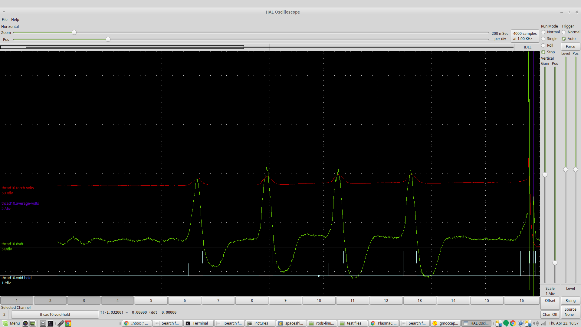

23 Apr 2020 02:15 #165191 by rodw
Replied by rodw on topic Void Lock Kerf Crossing suggestion
Well its been a long time coming but it looks like I have finally nailed Void crossing sensing on the last cut for the day! So now I just need Phill to add a pin to Plasmac to disable the THC and I can tidy this up and share the feature
This is 2mm mild steel with a cut crossing 4 perpendicular cuts 10mm apart
Red = Torch Voltage
Green = dv/dt (change in voltage over time)
White = Void crossing output pin to disable THC.
I was just gobsmacked when I saw that plot unfold before my eyes!
The gradual slope up on the torch voltage is becasue there is no THC enabled during these test cuts. I expect once the THC is in play and controlling torch height, we will have perfect results! Well I hope we catch the void fast enough for that anyway! It looks like we do.
Also need to test on different thicknesses.
