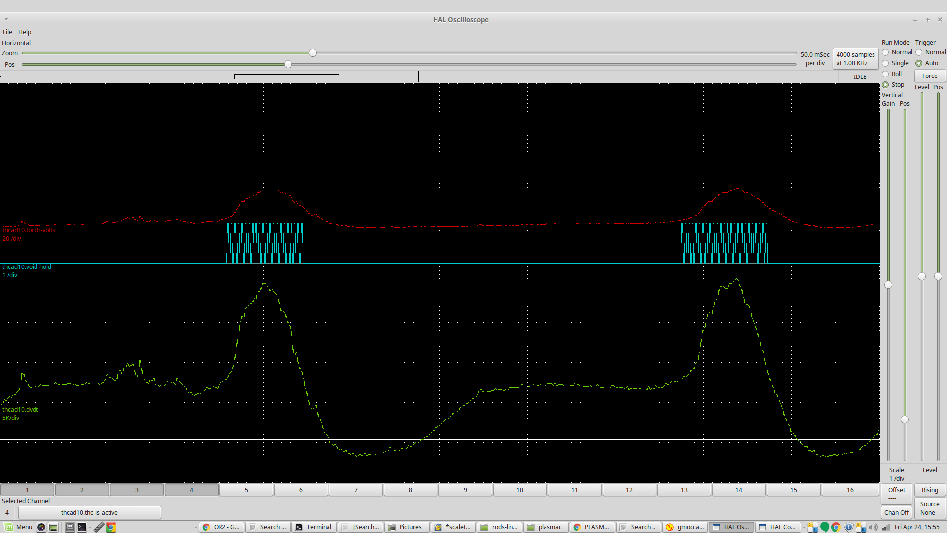

OK, I've hit a couple of snags here.
I need to ignore the voltage spike at the beginning of a cut as its triggering the kerf enable but the characteristics are different to a kerf cross so it stays on.
Does plasmac.thc-active go true when the time delay before enabling the thc function expires? I need a signal at that point.
It would also be nice to have an additional pin to disable the THC because plasmac.thc-disable is already in use so I'd need to use an OR2 in hal and I have so much in hal already.

For Cut Parameter Volts plasmac.thc-active goes true as soon as the delay has expired.
Replied by phillc54 on topic Void Lock Kerf Crossing suggestion
For Auto Volts, after the delay has expired, the voltage is sampled for the next six periods then plasmac.thc-active goes true.Does plasmac.thc-active go true when the time delay before enabling the thc function expires? I need a signal at that point.

Thanks, hat helped a lot. I Must have missed something.... but where the oscillation starts and finishes looks good!
I found I Missed something in an if else condition. Hopefully that is it!

Hmm, its about this time one needs to take a hard copy print out and study it over a few scotches on a Friday night. I think I can see whats wrong but I shut everything down for the night.
But I've got it installed in HAL (i think) and plasmac.thc-active is making it skip the problem I had at the start of the cut.

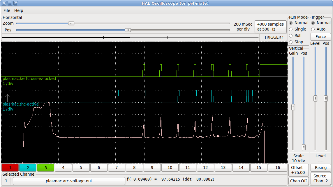

I was mucking about with a Raspberry Pi 4 today so I thought I would take a look at kerfcrossing. Here is a plot with the kerfcross threshold set to the default (100%). It doesnt look too bad so I didn't bother changing anything. I may have a bit more of a play tomorrow if I get time.
This was cutting 2mm sheet at right angles to previous cuts which were 10mm apart.
plasmac:arc-voltage-out at the bottom is 10V per division

Replied by rodw on topic Void Lock Kerf Crossing suggestion
Good work Phill. I got close than I broke it trying to improve it, then I got busy!
