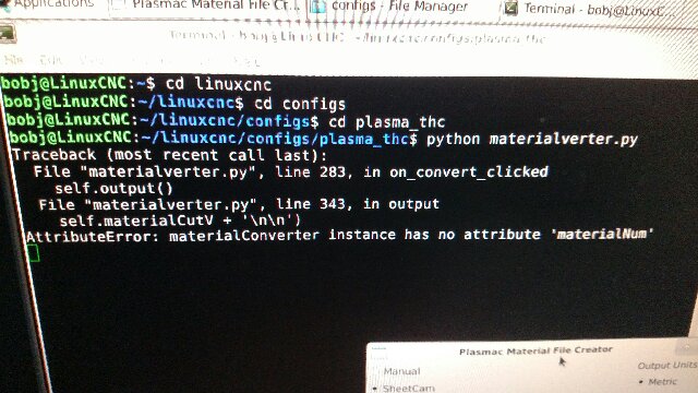

I did find another problem when trying to import a Sheetcam Toolset csv file. I get the error shown in the attachment. The tools set generated by Sheetcam is also attached (renamed to .txt from .csv).
03 Dec 2019 22:12 #151906 by phillc54
OK, yours is a csv file, I didn't know that format was available.
The original tool files I was given to work with were in a different format as shown in the attached file.

03 Dec 2019 23:41 #151921 by MakingStuff
Replied by MakingStuff on topic Materialverter Script Causes Z-Axis to Stop Working
That is the only option I have to export them in Sheetcam. Is there another way to do it?
