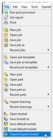

The SheetCam I fiddle with is a Linux version which is 6.1.57 and it has no option for exporting .csv file (that I can see)
I go "File" - "Save toolset as" and it only has an option for a .tools file.

I was exporting it. I will try again and use the Save Toolset As option.

Aha, I don't have the Import/Export option available.

I tried it using the "Save As" option and the materialverter worked fined.

Thanks for reporting back, I will add something to the docs for this.I tried it using the "Save As" option and the materialverter worked fined.
