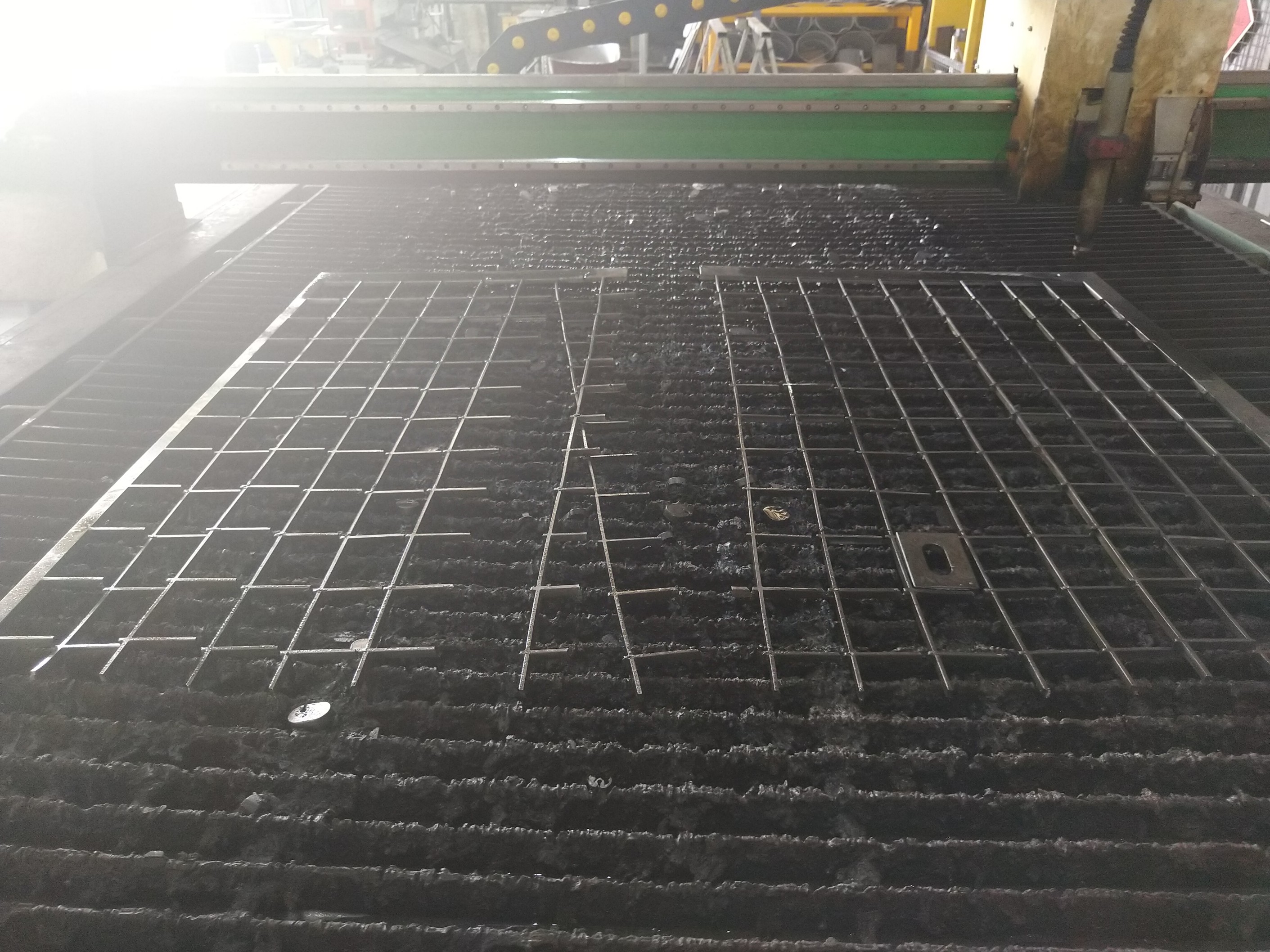

Hi Guys,
I have made a video of PlasmaC line cut feature in Axis for those who are interested. My PowerMax was set to continuous arc mode and the gantry and z axis were controlled manually. Like a big CNC hand torch!
Here is the sheet after I have moved it, it is easy to handle these sized sections by hand.

06 Feb 2020 08:12 - 06 Feb 2020 08:13 #156617
by thefabricator03
PlasmaC severing a full sheet of 5mm plate with the line cut function.
Replied by thefabricator03 on topic PlasmaC Line Cut Video

Thanks for the vid. Would you mind giving me the psi used on that sort of cut 5mm and 3mm.

I am using the RS485 interface and have the setting at 0 psi I think. That lets the machine set the air pressure.

Clive, for a 40-50 amp machine, try around 70-80 psi. Maybe your manual tells you what to use. From memory my machine at 40 amps my machine is meant to be set at 5.2 bar (around 75 psi)

I get a clean cut on 3mm at 2.5M/min and 6mm at 450mm/min. But in the vid above. he was cutting att 1.75M/min 45A at 5mm.
I am running the cutter off a 13A socket so I might not be getting the full 40A ie. volt drop in cable and fuse.
I will try it from a dedicated 16A supply socket.

I remember reading somewhere a while ago that the larger machines will cut at better quality with lower amps due to current density,
I think the example was a 65 amp machine will cut at 40 amps better than a 40 amp rated machine cutting at 40 amps.
My machine is rated at 125 amps.

Ignore the Hypertherm specs, they cut way faster than a lot of other machines. Also you need to profile cut height by trail and error. My guess is 1.7-1.8mm cut height at 1.8-2.2m/min but you don't say what height you are using.
