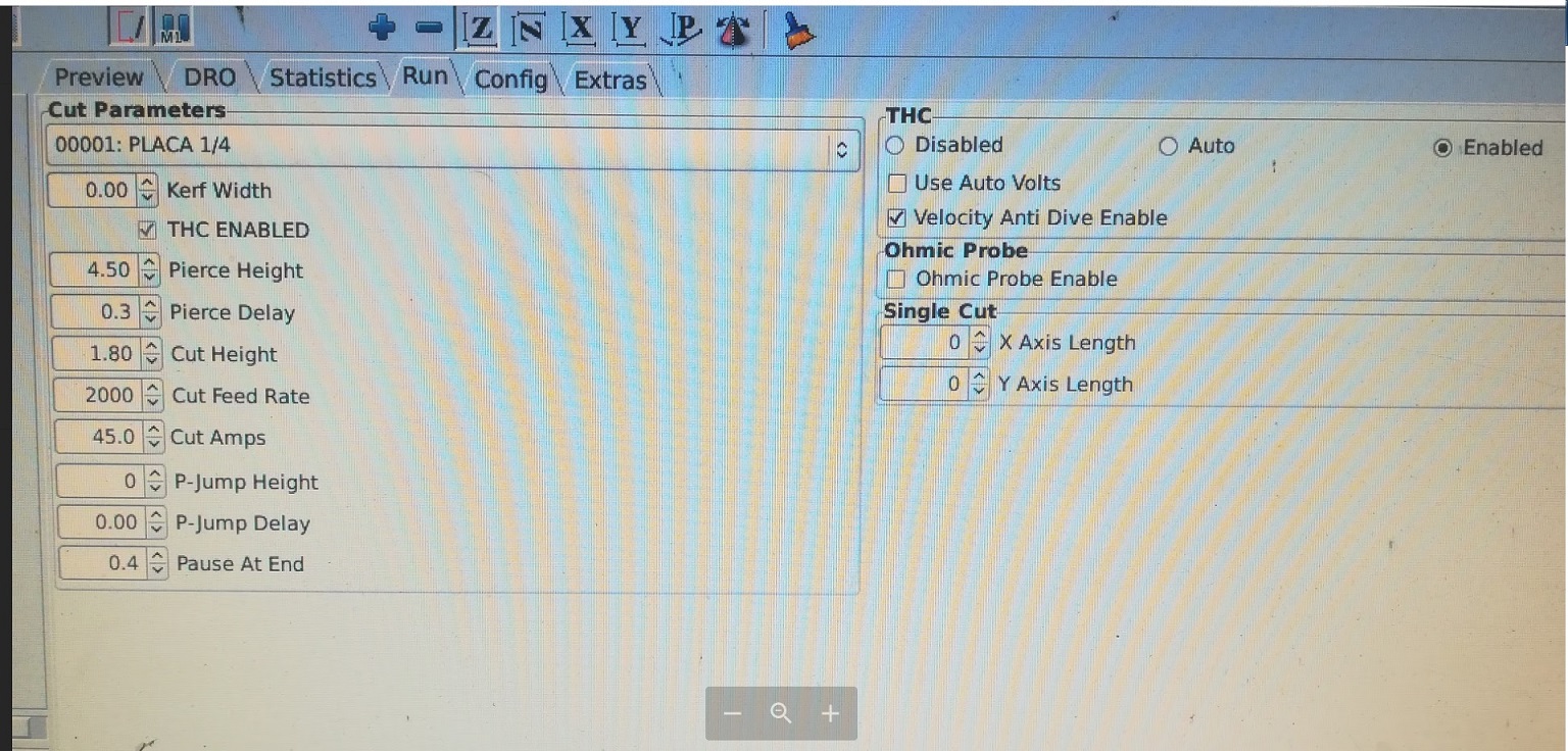

Hi, I'm probbing a new confguration, all axes are moves well, it detect the material and starts the cutting process, but when I spect to see the up and down leds blink in control panel, it only activate the red led for "THC VOLT LOCK" and the torch dive into material. Can somebody help me in which parameter I puted wrong? Here is an image for my Config and Run panel.
PD My configuration is with an proma thc 150.

Is the THC Velocity light on all the time?
What F word value is in your GCode file to set the velocity?

Yes, the led is always on.
Is a fixed value like this F1500.
Always I have tu use F#<_hal[plasmac.cut-feed-rate]>?

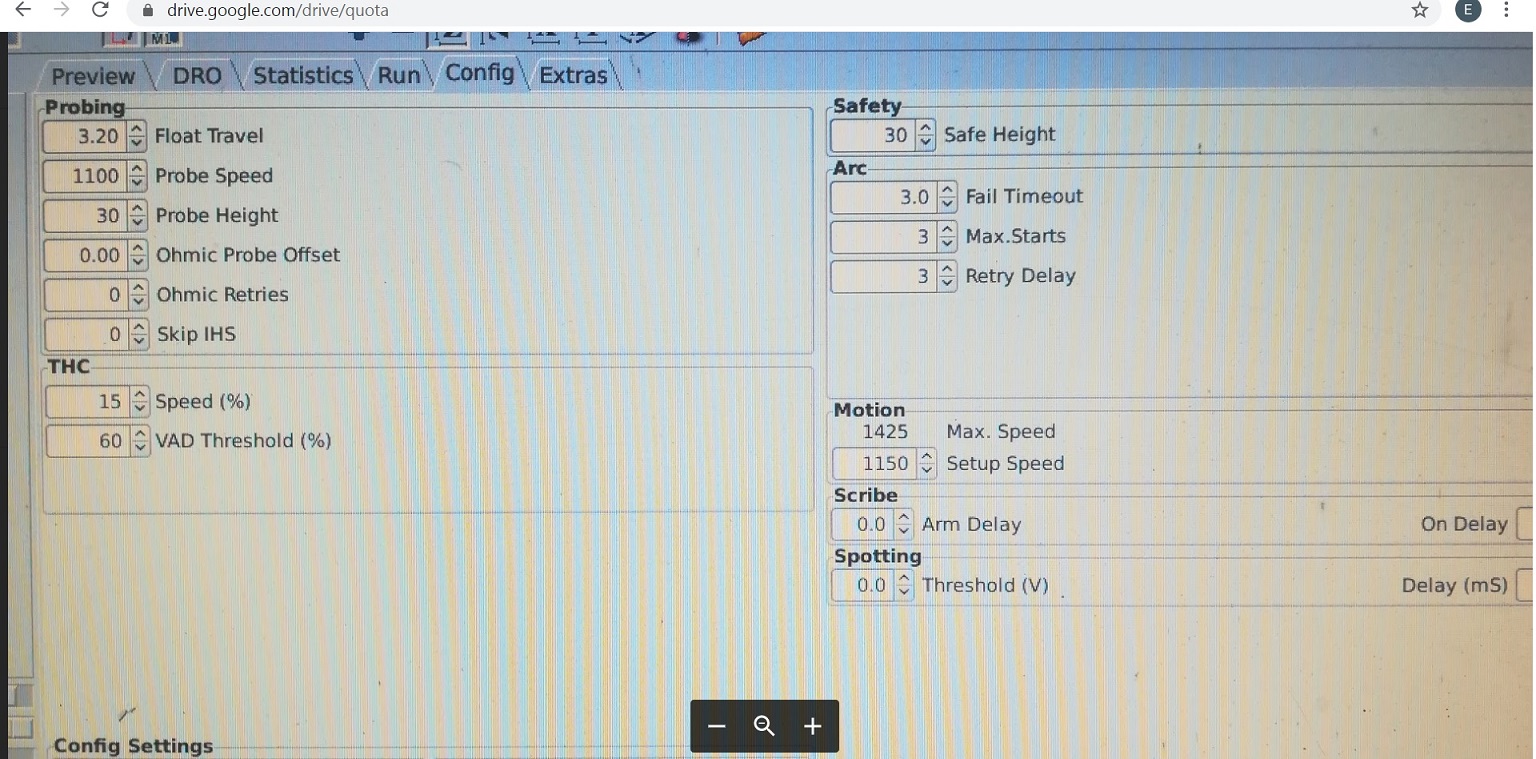

PlasmaC use Cut Feed Rate as the threshold speed for THC Velocity Hold.
Your CutFeed Rate is set to 2000 and your VAD Threshold is 60%
So anything less than F1200 (2000 x 0.6) would cause the THC Velocity Lock to turn on and anything more should be ok.
1500 should have worked OK.
Make sure you have Feed Override set to 100% as well.
Can you try with F#<_hal[plasmac.cut-feed-rate]> and see what happens.

Using the HAL FEED RATE Variable, the THC was not blocked. Perfect I understood, I can use direct values in the FEED RATE, always taking care of the relationship between VAD and FEED RATE, or failing to use the hal variable, thank you very much Phill.
