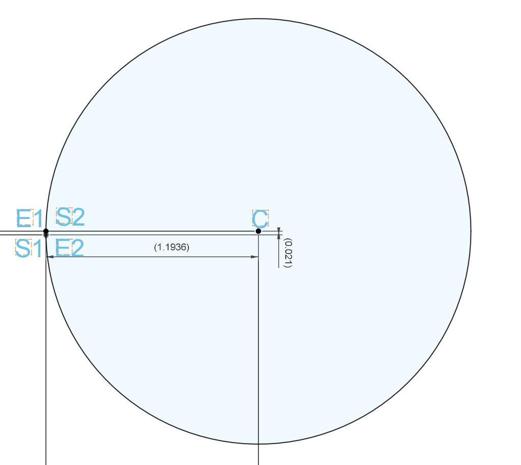

I found that the difference evaluated by this line 502: "if (Vector.diff(circleBuffer.start, circleBuffer.end).length < toPreciseUnit(0.01, MM)) { " was 0.22 something which was greater than the allowed tolerance, but I am unclear as to why. All the other holes of same size were showing 0 for this difference. If I raise the threshold to 0.25, the centerpunch command gets executed, but I'm not sure what the ramifications are on doing that. If I don't change that, the else gets evaluated on line 577, causing the centerpunch to get skipped: writeBlock(gMotionModal.format(circleData.clockwise ? 2 : 3), xOutput.format(circleData.end.x), yOutput.format(circleData.end.y), iOutput.format(circleData.center.x - circleData.start.x, 0), jOutput.format(circleData.center.y - circleData.start.y, 0));

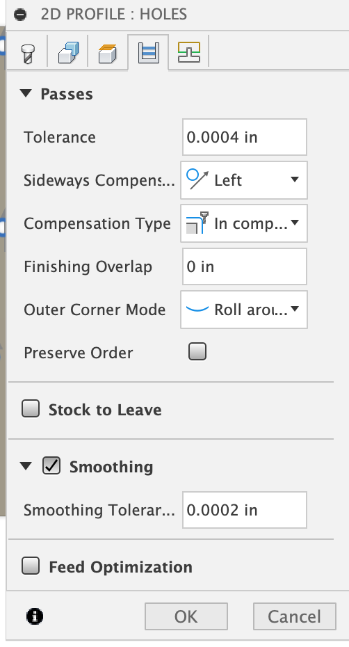

How would I check this? Toolpath looks complete when zooming in and the "show toolpath data" looked similar for all the circles. I also tried a different part and it came out fine. The selected contours are all closed chain, so not sure what is missing with this part.

Tried to follow how this works in the onCircular function.
Three lines down there is a test with 0.2 mm line 452. That fails for this circle.
Then ends up doing a new circle line 476, which is the one that isn't really right.
I don't understand this with merging circles but I guess it has something to do with that.
Edit: In the fusion simulation of the tool path it is clear that a circle is made up of several circle segments, which is then supposed to be assembled to a full circle in the post-processor. Guess something went wrong with the assembly.

Interesting, thanks for looking into that. Everything I've cut so far is with merge circles off, but perhaps I should check it and see what happens. What is odd is that there are three other holes in the bolt pattern of identical size without this issue. What does the check in this if statement actually do? Line 502: if (Vector.diff(circleBuffer.start, circleBuffer.end).length < toPreciseUnit(0.01, MM))
What would happen 0.01 MM was increased?

The test checks for a full, closed circle. If he distance between start point and end point is < 0.01 mm it is a full circle.
Have to allow something for numerical precision but 0.2 mm seems a lot when it should be 0.
I see what happened. After the almost full circle, you got in a very short segment that should have been merged with the circle.
But instead of merging, it ended up as an own short segment. See line N430 in the G-code you attached. There is the small segment.

Thanks, I tried the Merge circles, with the same outcome as before. I also found a test in the manual “isFullCircle()”, which returns False for this hole and true for all of the others. Should I try redrawing the hole or is the issue more so with the CAM processing? Maybe I should just keep testing different files and see how often this issue actually happens. Not a big deal to hand mark and drill this part, but more so just want to understand how to potentially resolve it he underlying issue and improve the robustness of the post processor.
