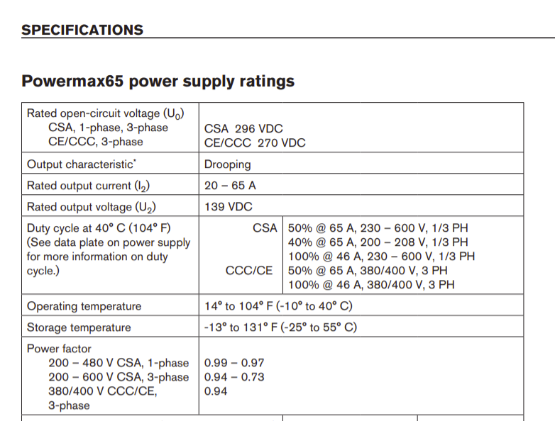

What is the open circuit (OC) voltage written on the back of the plasma ?
- Posts: 12054
- Thank you received: 4114
16 Dec 2020 10:29 #192117
Replied by rodw on topic Plasma C Wiring
- Posts: 21771
- Thank you received: 7441
16 Dec 2020 11:44 #192124
Replied by tommylight on topic Plasma C Wiring
That will be 8.4V at the THACD10 input when plasma is at 140V, soooo that is very good.
