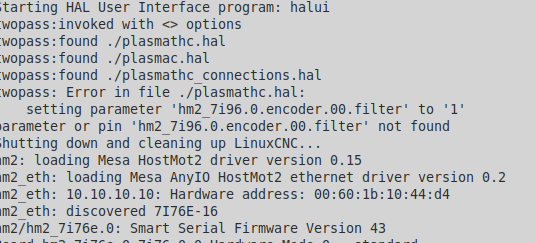

twopass: Error in file ./plasmathc.hal:
setting parameter 'hm2_7i96.0.encoder.00.filter' to '1'
parameter or pin 'hm2_7i96.0.encoder.00.filter' not found
Attach the hal and ini files.

Looks like you are using a 7I96 HAL file for a 7I76E
Replied by PCW on topic Error on startup of PlasmaC, does the torch need power?
hm2_eth: discovered 7I76E-16Looks like you are using a 7I96 HAL file for a 7I76E

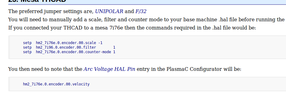

I will have to sack the proofreaderThank you,
didn't pay attention....and see it is 796i only for the filter line....
this is from the PlasmacUserguide....
I'll fix that...
