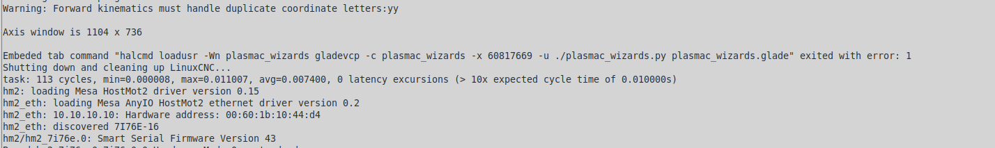

Why did you choose to go with Buster and not the stretch ISO provided by the Linuxcnc guys ?

was the easiest for me to setup a clean system! and since I followed
gnipsel.com/linuxcnc/uspace/debian10-emc.html
compiled it, linuxcnc was working ok, soooo
everything worked ok, until plasmac, ...

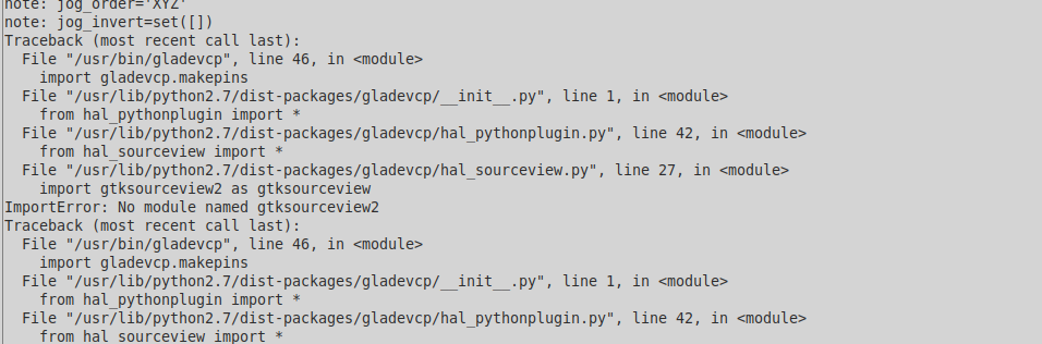

I would have thought installing from a pre-made image would have been easier, no compiling no chasing up missing bits.
Have you tried searching debian for the missing package ?
You have to remember that sometimes distros remove packages from one version to the next and it can break things.
Found this using google by searching "linuxcnc gtksourceview2 debian buster"
forum.linuxcnc.org/9-installing-linuxcnc...97-2-8-debian-buster
There's a few others as well, can't vouch if they work or not as I've been working on Mint install images.

I see part of those instructions:Unfortunately it is not explained that it breaks some GUIs.
You would be better of using one of Robs images forum.linuxcnc.org/9-installing-linuxcnc...with-linuxcnc#157411
Replied by phillc54 on topic gtksourceview2 import error
debian/control.bottom.in
remove python-gtksourceview2, on line 14
remove python-vte
debian/control
remove python-gtksourceview2, on line 68
remove python-vteYou would be better of using one of Robs images forum.linuxcnc.org/9-installing-linuxcnc...with-linuxcnc#157411

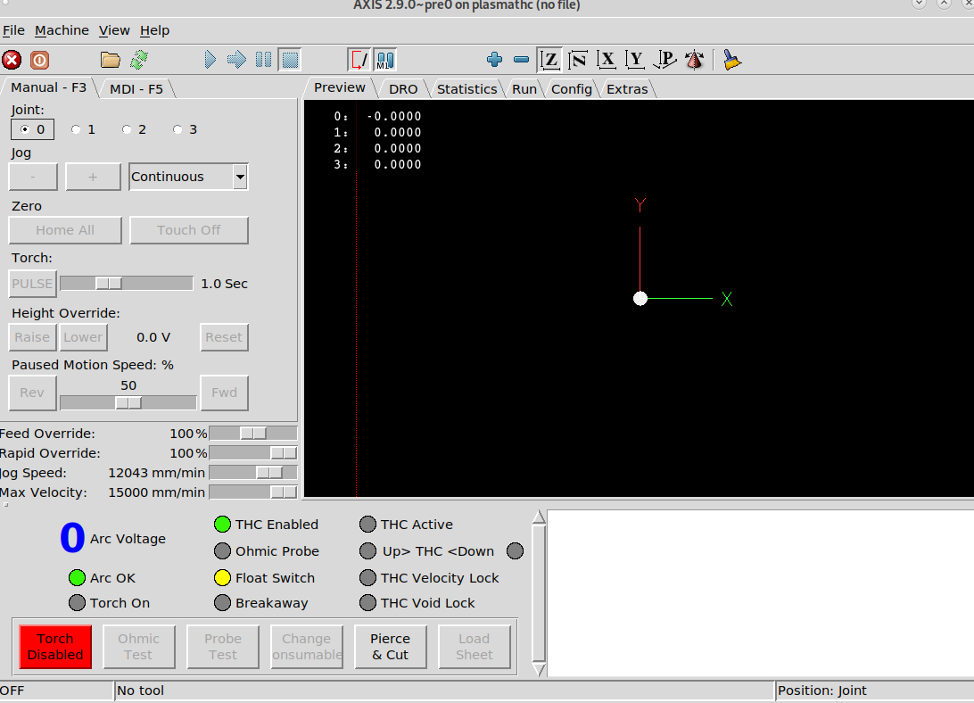

If I can't fix it....
I could use debian 9?
Plan Bb
I try Rob's...
Thank you!
Plan Bb
I try Rob's...
Thank you!

Glad you got it going.
