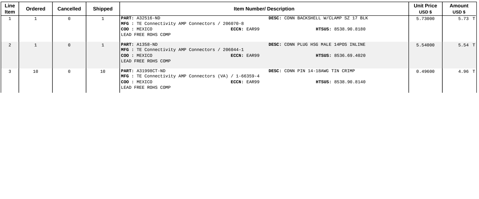

The connectors are from TE Connectivity. Each piece including the pins are purchased seperately. The pins are designed to crimp on but the tool is expensive!
This might get you going searching for parts.
au.element14.com/amp-te-connectivity/206...?CMP=i-55c5-00001622
au.element14.com/amp-te-connectivity/661...?CMP=i-55c5-00001622
au.element14.com/amp-te-connectivity/206...MER=sy-me-pd-mi-acce
You need to get the backshell as well. I think this is it
au.element14.com/amp-te-connectivity/182...MER=sy-me-pd-mi-acce

I made the CPC connector from the part numbers listed by Jim Colt on cnc zone (
PINS
At any rate, no need to crimp them, I just soldered mine and it worked fine! I ordered his exact recommendations.
I would get some shielded cable if I were you, I found 6 conductor individually shielded (2 pair at a time) cable on ebay stupid cheap by dumb luck.
hope it helps
hope it helps

03 Apr 2020 18:53 #162604
by Uthayne
Replied by Uthayne on topic Upgrading from 30 to 45xp
Just to add on, I made my own CPC cable as well. Here was the Digikey order I put in for the connector housing and the pins that I used.
