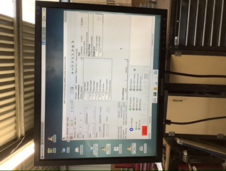

Plasma Run tab has no new material button
- little_sparky
- Posts: 138
- Thank you received: 17
11 Apr 2020 02:35 - 11 Apr 2020 02:35 #163581
by little_sparky
Plasma Run tab has no new material button was created by little_sparky
Last edit: 11 Apr 2020 02:35 by little_sparky.
- phillc54
- Posts: 5711
- Thank you received: 2100
11 Apr 2020 02:52 #163584
by phillc54
Replied by phillc54 on topic Plasma Run tab has no new material button
That could only be from an old configuration.
- little_sparky
- Posts: 138
11 Apr 2020 02:54 - 11 Apr 2020 02:54 #163585
by little_sparky
Replied by little_sparky on topic Plasma Run tab has no new material button
Thanks Phill,
What’s the easiest way to update this?
Last edit: 11 Apr 2020 02:54 by little_sparky.
- phillc54
- Posts: 5711
11 Apr 2020 02:57 #163586
by phillc54
That depends on your installation type.
Do one of these first:
linuxcnc.org/docs/2.8/html/plasma/plasma...nuxcnc_configuration
Then the next section:
linuxcnc.org/docs/2.8/html/plasma/plasma...lasmac_configuration
