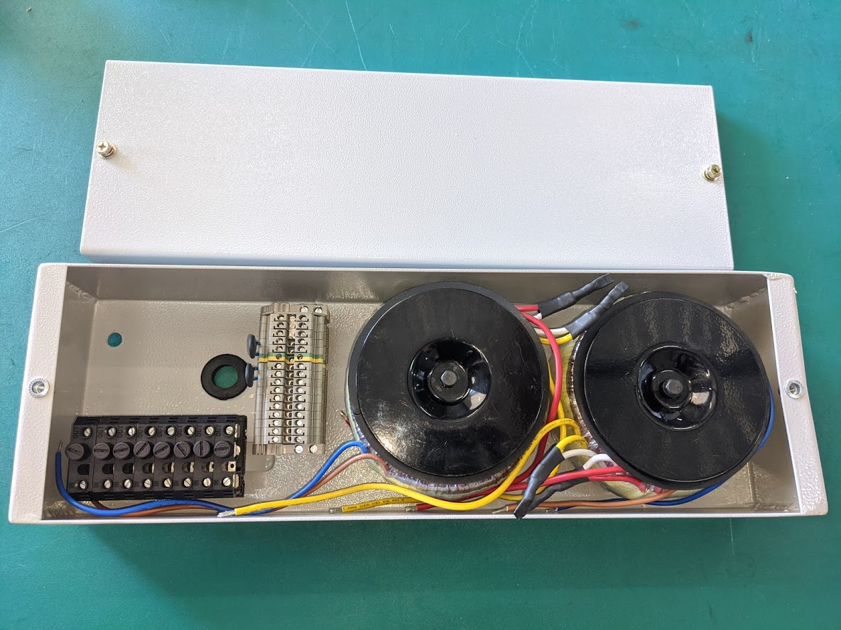

I have made my own git hub repository and when I learn what to do, I will publish it. I had some probing issues last job so I want to revisit it. At the moment my plasma cutter is in pieces pending an upgrade so I can't really test anything. But stuff I was waiting for has turned up today. Including my beautiful plasma cut enclosure for my toroid power supplies
