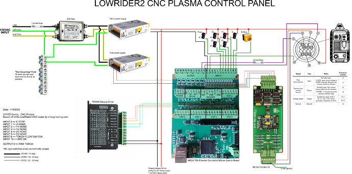

- Aaron3309
- Posts: 49
20 Apr 2020 08:08 #164851
by Aaron3309
Replied by Aaron3309 on topic Trouble with float switch
ok so i have set up my machine based on this image for wiring in the hypertherm
can you please help me with what i need to put for the pins for the arc voltage, torch and float switch when running the plasma c configuraor. The only difference in how i wired is that i wired my float switch into the 3rd pin from the right on tb3

20 Apr 2020 18:34 #164899
by phillc54
Replied by phillc54 on topic Trouble with float switch
I think something like:
Arc Voltage hm2_7i96.0.encoder.00.velocity
Float Switch hm2_7i96.0.gpio.002.in or hm2_7i96.0.gpio.002.in_not depending on n/o or n/c contact
Torch On hm2_7i96.0.ssr.00.out-00Please Log in or Create an account to join the conversation.
