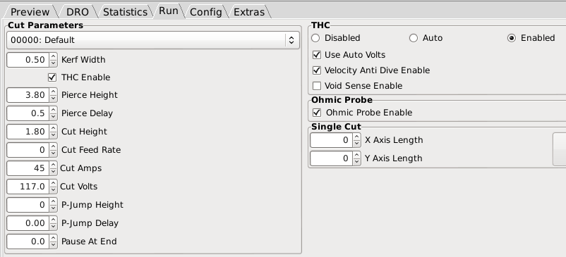

Screenshots of "run" and "config" panels ?

24 Apr 2020 11:38 #165412
by pkasy
Replied by pkasy on topic Please help with plasmac configuration
ok

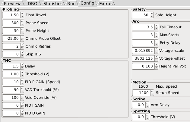

Do you have ohmic probing OR floating switch ?
In the config panel you have ohmic probe offset set at -25, i am not sure that is correct, but Phill knows that better, if he is around.

Ohmic. I tried ohmic probe offset from 0 to -25.
After sensing Plasma is trying to go even lower. Not up, but down. Somewhere the system changed sign, but where?
It worked fine before uprade.

You might want to wait for Phil or Rod to reply to that as i am not sure how that works in PlasmaC.
IIRC, the Z axis 0 should be just below the slats on the table, and home should be at the positive side, but you have it set as for a mill, meaning you have the zero at max height. That might be the reason for probing errors, but i currently have no way of testing that.
