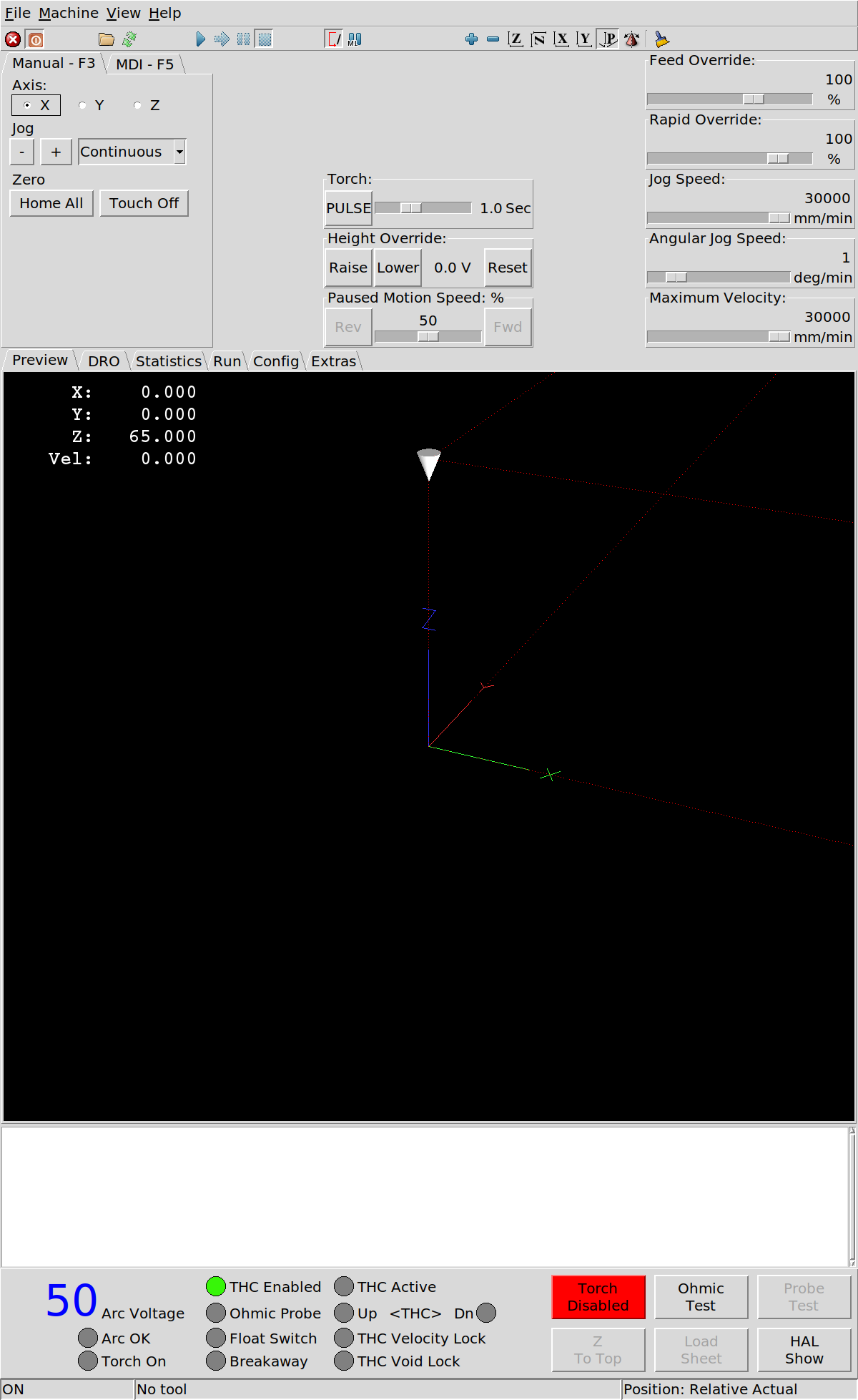

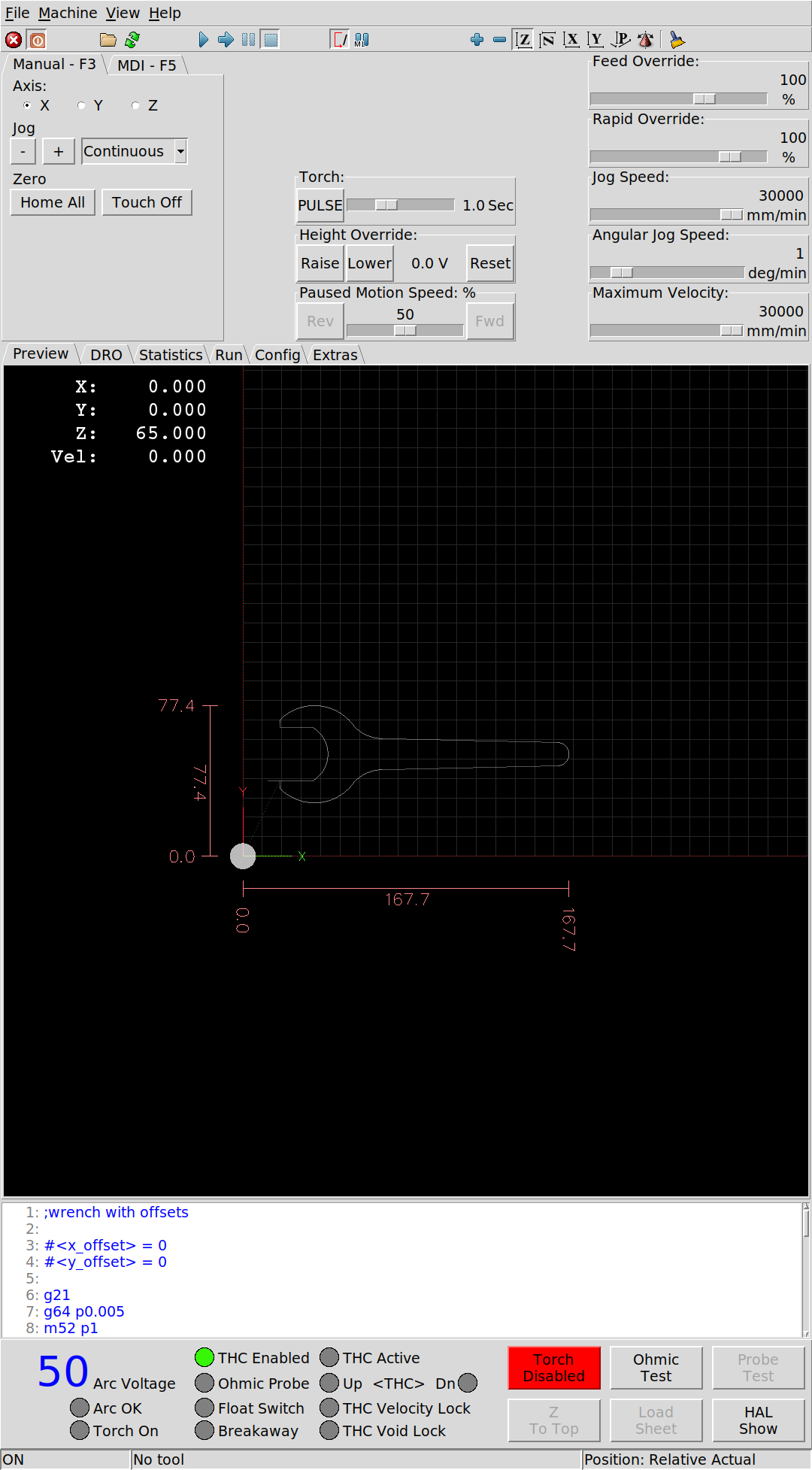

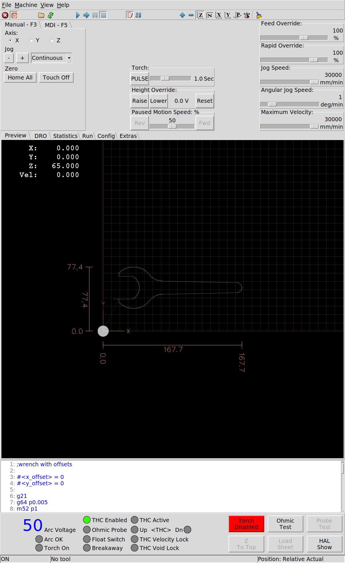

Here is where its at.
1920x1080 with font size 14 which is the most that fits at this size.
1920x1200 with font size 14.
1920x1200 with font size 15.

Nive, nice, VERY NICE !
Magnificent work, thank you.
BTW, one thing i noticed while setting the Z axis limits yesterday, the "ignore limits" is not there ?!

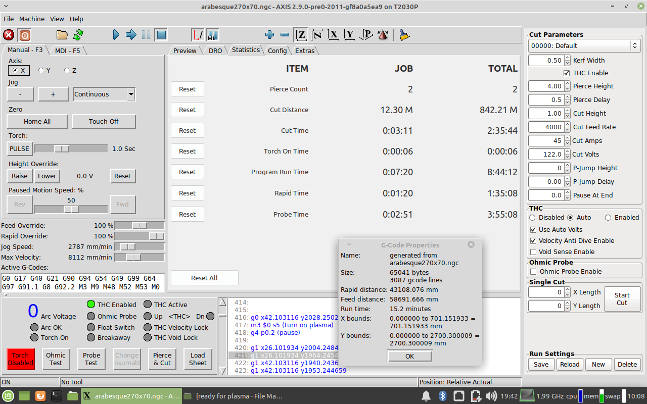

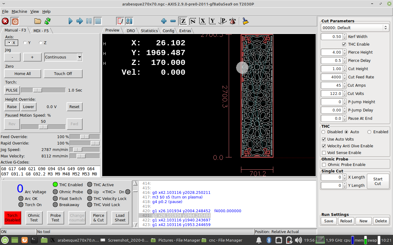

Another thing i noticed today while cutting air, lots of it, the cut distance is not the same as in file properties, there is quite a distance difference, see screenshot.
That is for the part below, it sure looks like over 58 meters, as 12 would be enough to go over the outline!
Not a deal breaker in any way shape or form. And BTW, notice the probe time !
Or is it just for what is done with the torch enabled ?
I have it disabled as i have no plasma source for now.
Thank you for everything.
Last edit: 11 May 2020 13:03 by tommylight. Reason: More info
- Posts: 22027
- Thank you received: 7502
11 May 2020 14:47 #167414
Replied by tommylight on topic Vertical Axis GUI for PlasmaC ?
Never mind the last post, a "duh" or just getting old. Or might be putting 15 to 19 hours days including Sundays is getting to me !
That was the job already done as i had it stop before finishing the job, so it is correctly counting the distance.
On a brighter side of things, i have it running for two days without a single hitch, cutting air.
I might just convince myself to build a plasma cutter source transformer thingy or modify two broken ones i have here, none repairable.
Geez, not enough time......

Yeah, the statistics are only what has occured up to now, there is no look ahead.

12 May 2020 02:05 - 12 May 2020 02:31 #167472
by phillc54
Replied by phillc54 on topic Vertical Axis GUI for PlasmaC ?
I just pushed this work. To enable portrait mode put the following in the [PLASMAC] section of the ini file:
I fixed the ignore limits thingy as well.
AXIS_ORIENT = portraitI fixed the ignore limits thingy as well.
