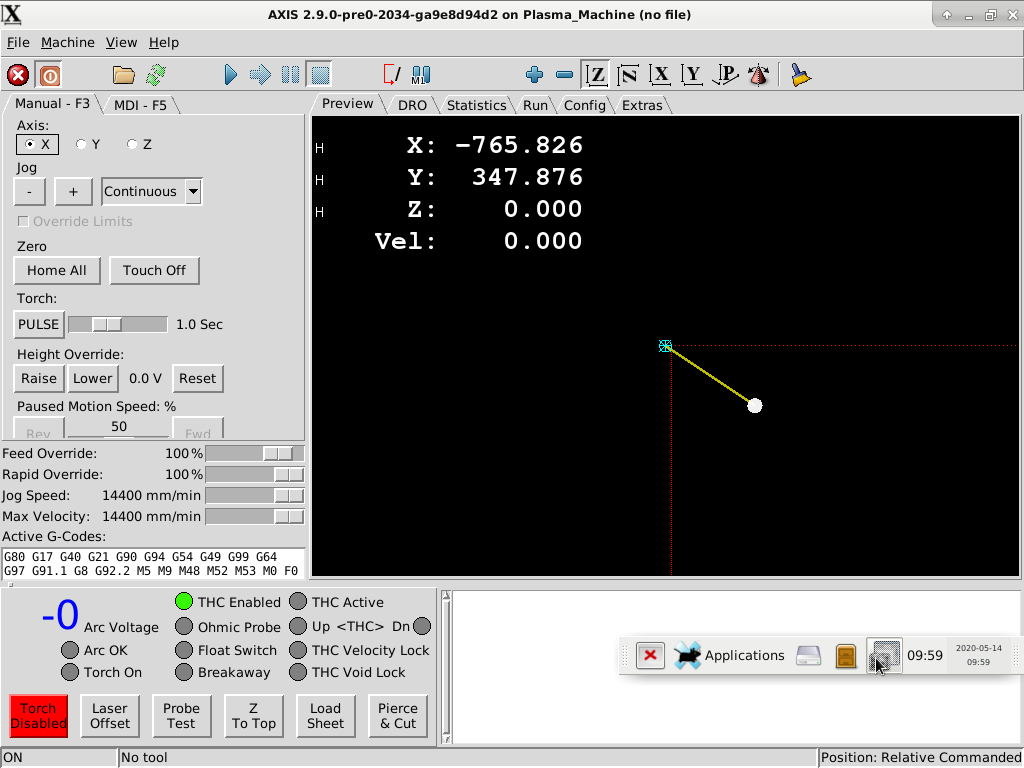

On screenshot_1 the feed override is masking the pause motion bit

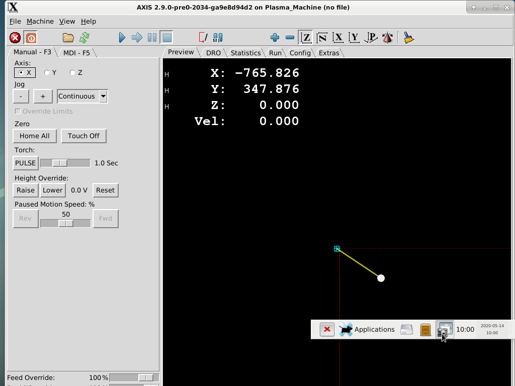

On screenshot_2 it appears to be in some sort of portrait mode this was achieve by just dragging the screen display around from the title bar or just by clicking on the square next to the cross on the title bar
I think this happened on update to V0.124 from v0.123

The first issue is because I originally disabled the Override Limits checkbox and I re-enabled it but forgot to make some room for it. I will fix that tomorrow.

What font size do you have for axis? 10
What Linux distro and version? It shows 2.9 in the screen shot
Not sure on the monitor res.
I had not changed anything from V0.123
I have changed the ini file from 1 to 0
the window size for the Axis GUI, 0 = minimum size to suit font, 1 = maximized
MAXIMISED = 0
That has corrected it but then I have to click the max button in the title bar at the top to make it full screen. which is fine.
but the feed override is masking the pause motion bit as before

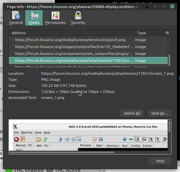

Based on the background colour, he is using stretch.
And that sure looks like a very low resolution monitor, most probably 1024X768
Yup it is 1024x768 as can be seen form the picture info below
Try lowering the font size to 9.

Thanks Tom, where did that pic come from?

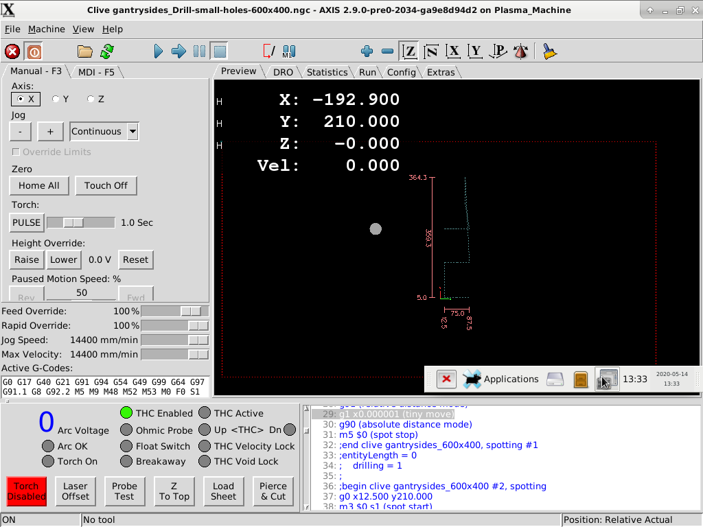

Phill I have also noticed that when running a prog. then hit pause or stop. the MDI does not respond ie. g0x0y0 produces no motion. I can jog manually the mouse is working fine if I go the the machine tab and home say z it does not work. to sort it I have to reload Plasmac.
I have attached the gcode.
File Attachment:
File Name: Clivegantr...x400.ngc
File Size:4 KB
To be clear I have done a find/replace $2 to $0 on it because the torch would not fire with $2
Edit is it possible to go back to version 0.123
Forum, right click on image, view image info on the context menu.
