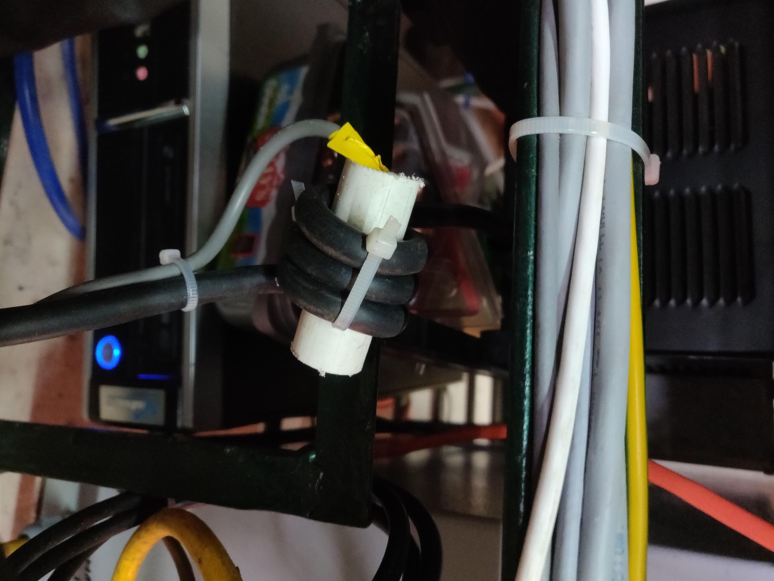

your reed switch is the issue,, if you have THCAD no need for the reed switch, or re design your reed switch
to verify increase the amp and increase the speed,
the magnate not strong enough to keep the switch on,, it oscillate on low power cutting
do you know @ what voltage ur reed switch trigger on? if no then no need to use arc ok signal,, just invert it to be always arc ok
in 2mm sheet arc ok about 80-90v
on 6mm 105-110 v
those from LGK 100 specs

In this case it was the initial transfer current on thin material, solved by him by adding a pause of 0.5 sec after pierce.
Replied by tommylight on topic PlasmaC Arc getting lost
Not really, i use them a lot on plasma cutters, they never failed.your reed switch is the issue,
That is true, that can be the issue at low current or thin material.the magnate not strong enough to keep the switch on,, it oscillate on low power cutting

The reed switch is fine and works my issue was resolved by changing the pause

Forgot to mention, i do have a machine with THCAD on the parallel port, mind you, without a reed contact, using thc voltage to generate the arcok signal, it has not failed yet, it's been some months now in use.
Then again, that will greatly depend on the plasma source.
